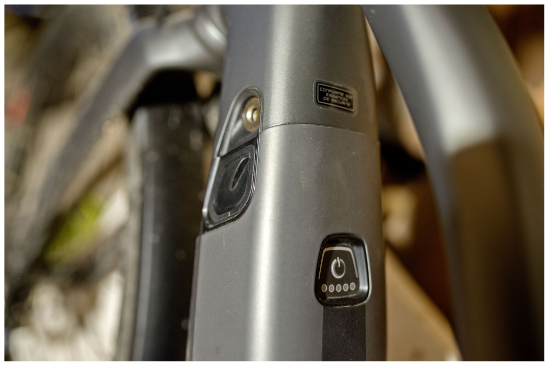

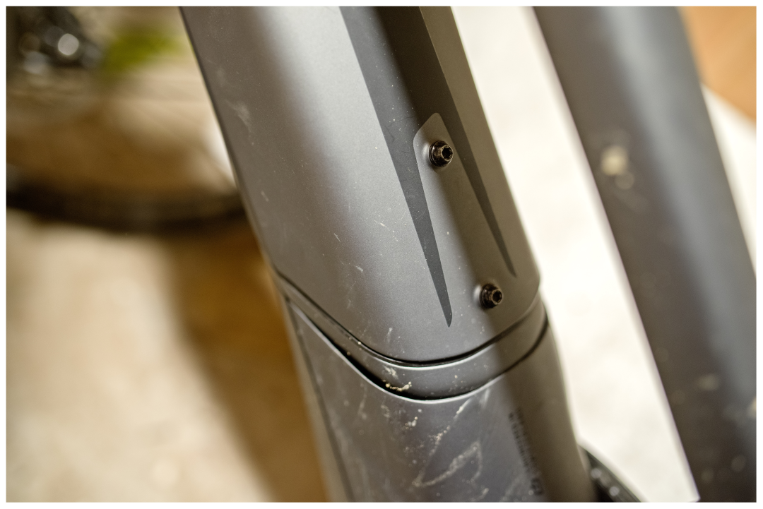

Guys. I will try to patiently explain how to properly insert the Vado battery. I own the 2017 model and don't tell me the battery chamber was any better:
Lean the bike against a wall, a tree or whatever else so the bike is standing upright. Align the bottom of the battery so it looks like in the photo. The battery should be almost perpendicular parallel to the frame. It ensures the battery contacts are inside the "harness" at the bottom of the battery chamber.
It is hard to see it in the picture but a micro gap remains. The battery is not secured yet. Give the battery a good slap near to the top leftmost corner.
Lean the bike against a wall, a tree or whatever else so the bike is standing upright. Align the bottom of the battery so it looks like in the photo. The battery should be almost perpendicular to the frame. It ensures the battery contacts are inside the "harness" at the bottom of the battery chamber.

Thanks for your explanation-- and I might well have done the same based on my 2019 Vado 2.0. I can tell you that with my Vado 3.0 I can follow your instructions perfectly, the battery will seem to be locked in, and sometimes still jar loose on a bumpy ride. Frustrating, and potentially dangerous.
On the battery on my 5.0 the metal piece that the latch catches has a number, think mine is .5 or similar. Makes me think there are different thicknesses used to fit and secure the battery. Mine fits pretty snug with a good hand slap.
