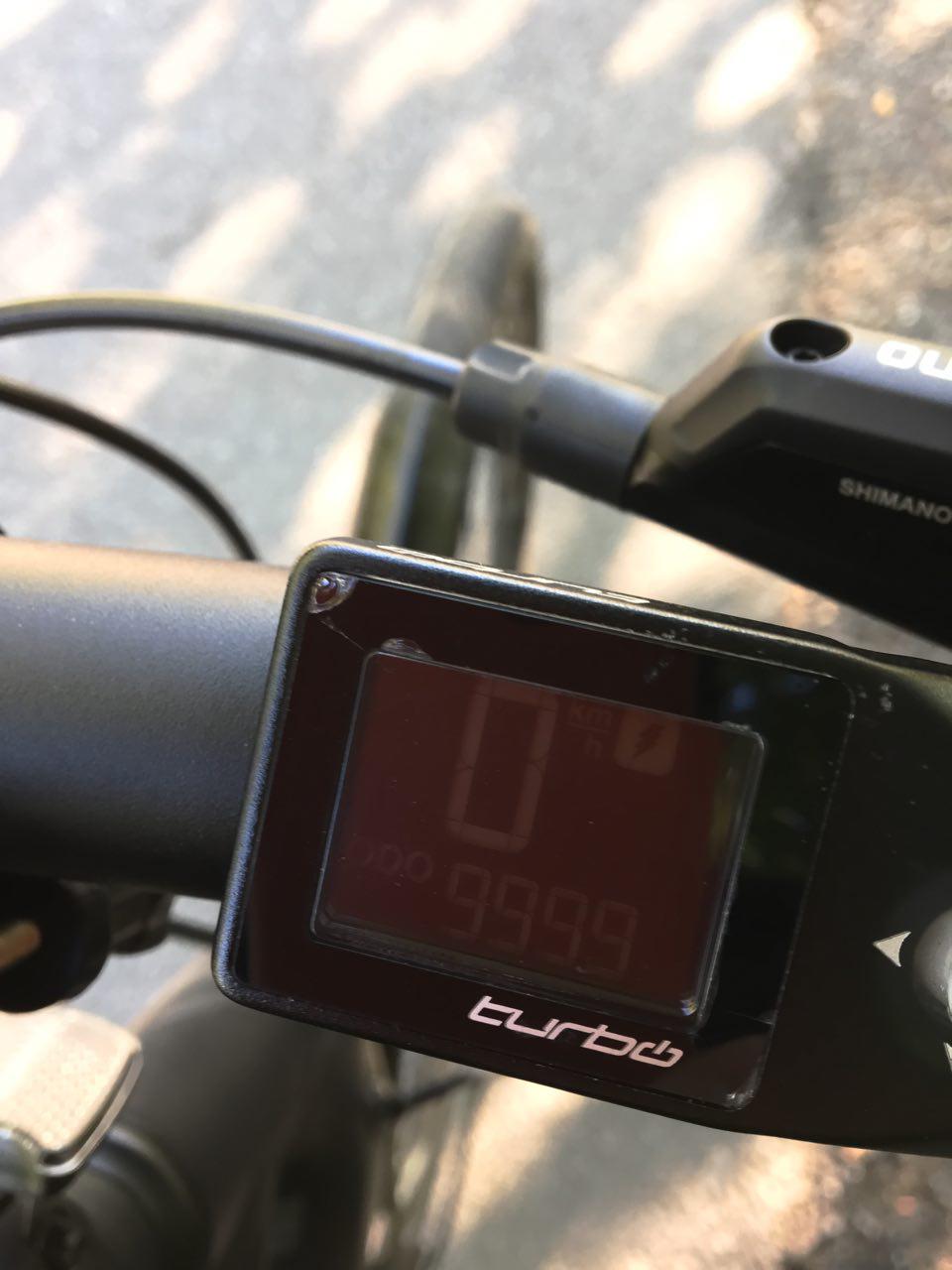

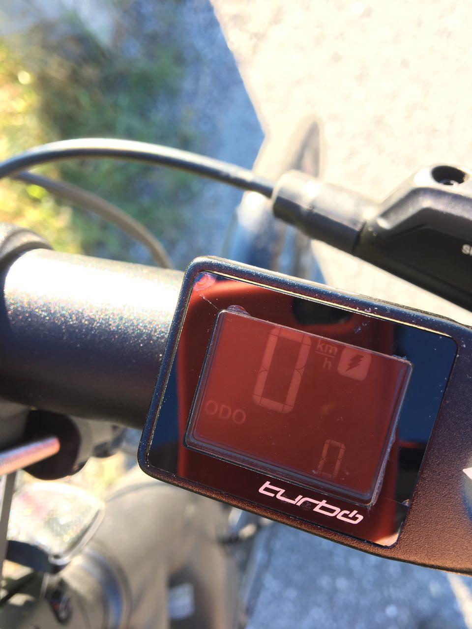

I should have posted this in the "total mileage" instead, but I consider this an issue rather than an achievement. Is this bike not supposed to last more than 10.000km? I wonder WTF where thinking when they designed the LCD screen. After 9999 kms / miles the s*it goes back to 0 and gets stuck in there. The LCD of the Turbo bike is one of the worst things I've ever seen in in a "high end" bike like this. In any case, I'm surprised the battery lasted that long without any issues.
View attachment 24704View attachment 24703
@eagamer80 Congrats on getting to 10k km! I'm wondering if changing the display to miles might be a good way to extend the odo another 40% or so (but at the cost of having to learn our newfangled system of measurement)!
Thanks. Changing it to miles it does the trick. With the diagnosis tool I was able to reset it to 0. Actually the counter was 10.165 km when I connected the bike to the software, but the display was unable to display it. So the only way to fix this is by using your dealer and reset it for you.
