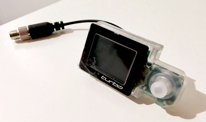

Reluctantly to leave the bike in the dealer and wait for like a month to get a replacement, we agreed that they will send me the new LCD screen so I could replace it myself. Here's the LCD replacement. You just have to remove 2 screws, pop out the old LCD from the metal frame, pop-in the new one and that's it. I set up the light using the C + 3 seconds the power button + selecting the option Back light Off after 5 seconds, so this time the light won't have to be all the time on while on the road (about 2 hours per day). Let's see how long this time lasts.
