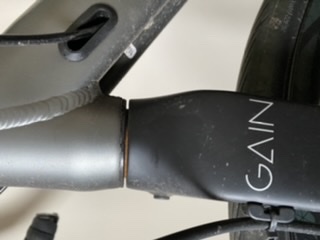

I’ve just noticed a gap open up between my fork and steering tube. It’s an Orbea Gain D40. Is this normal?
