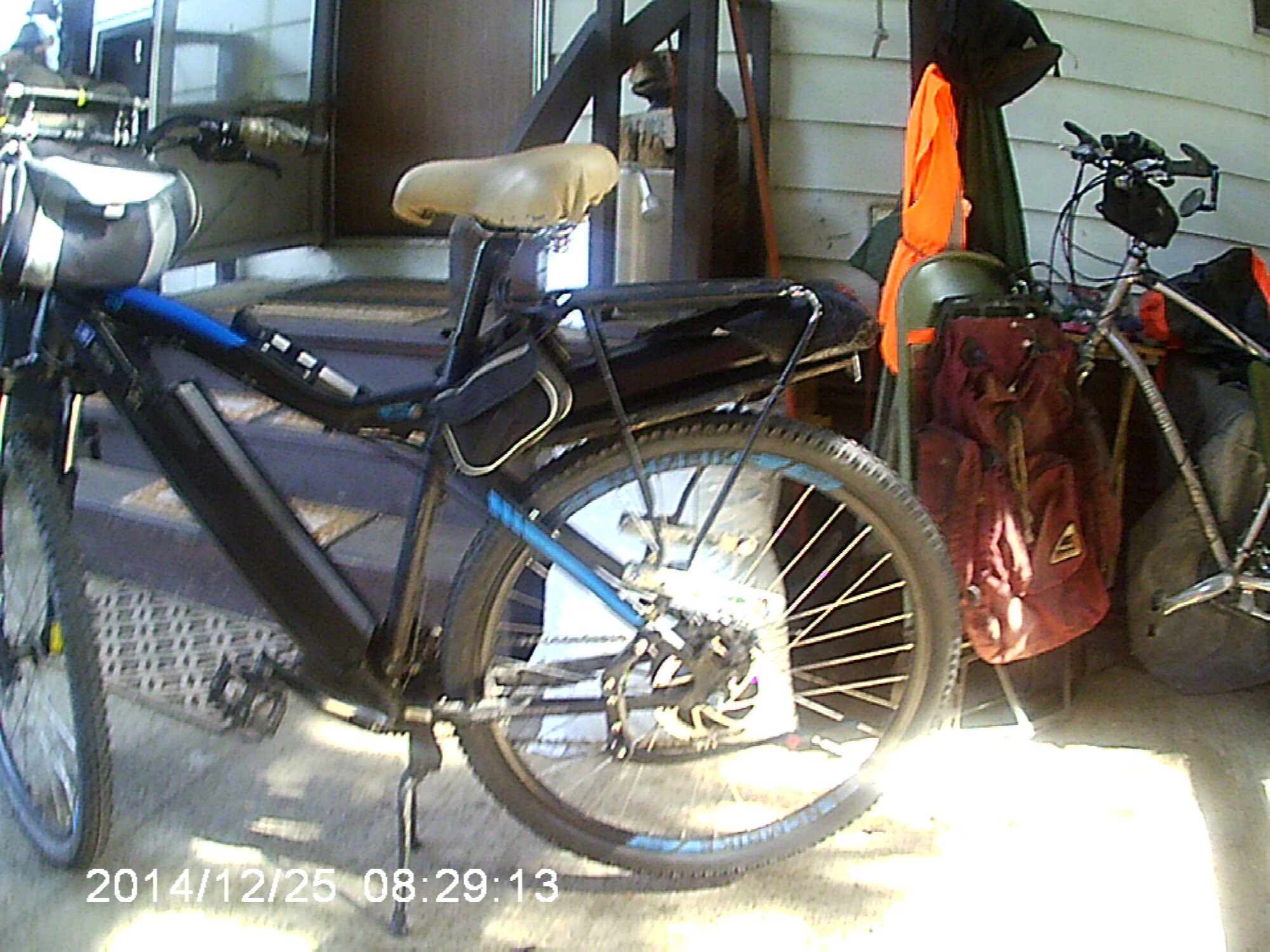

Eureka, Have retrieved lost images! this is so handy; I can rock either wheel off the ground to check & adjust brakes,
remove & repair tires, & more easily mount a trailer, & I have the rear mounted kick for unlevel surfaces.
The modified rack has a 2nd platform below the top to carry a second battery allowing for more range than I´d
care to ride in one day anyway. Mounted high, it puts the panniers behind my thighs to reduce drag & heel strike,
( I have size 14 feet.)View attachment 64720
