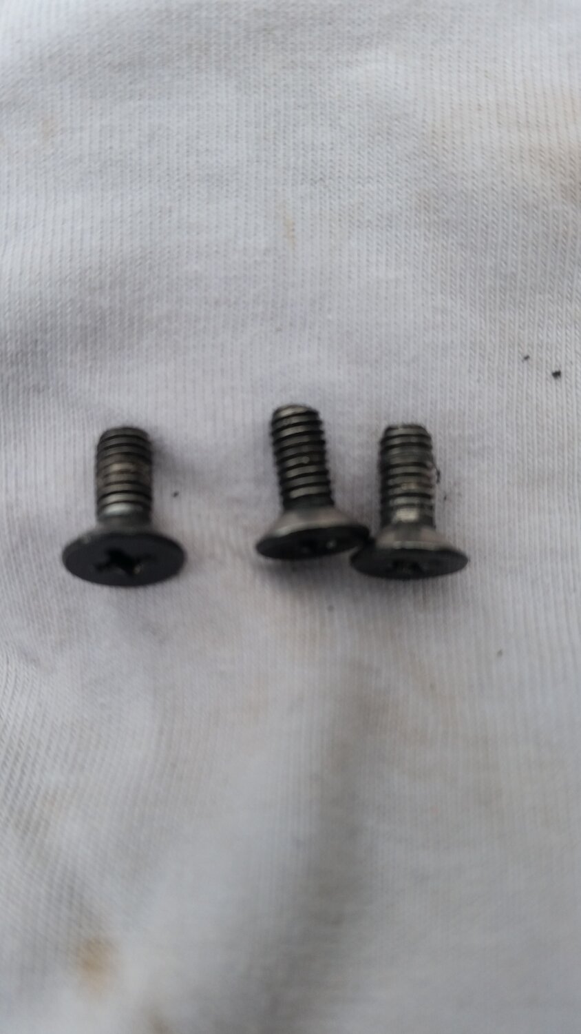

Hi mate why new wheel ? I have had an issue with x3 screws that have come loose and damaged the housing threads I have emailed NCM with a vid and teh screws . they carnt be re tapped I believe new wheel is in orderReceived the new wheel with motor. No tire attached. I can’t install this myself and will need to bring it in to a service shop.
why did you have to have a new rear wheelas I have an issue at the momentReceived the new wheel with motor. No tire attached. I can’t install this myself and will need to bring it in to a service shop.

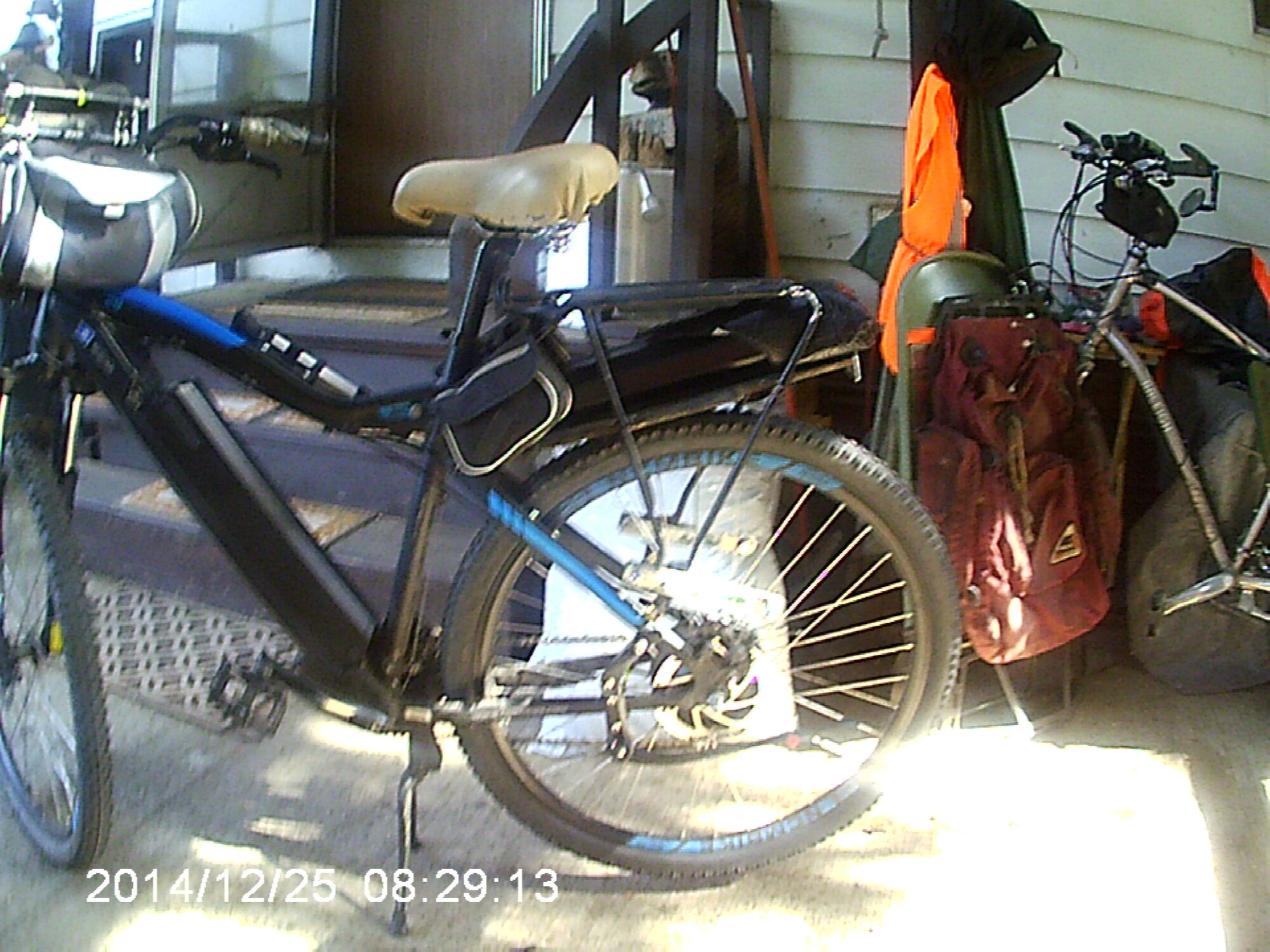

December 25, 2014? I'm assuming you just haven't set the date on your camera, or is your bike really 6 yrs old?Eureka, Have retrieved lost images! this is so handy; I can rock either wheel off the ground to check & adjust brakes,
remove & repair tires, & more easily mount a trailer, & I have the rear mounted kick for unlevel surfaces.
The modified rack has a 2nd platform below the top to carry a second battery allowing for more range than I´d
care to ride in one day anyway. Mounted high, it puts the panniers behind my thighs to reduce drag & heel strike,
( I have size 14 feet.)View attachment 64720
