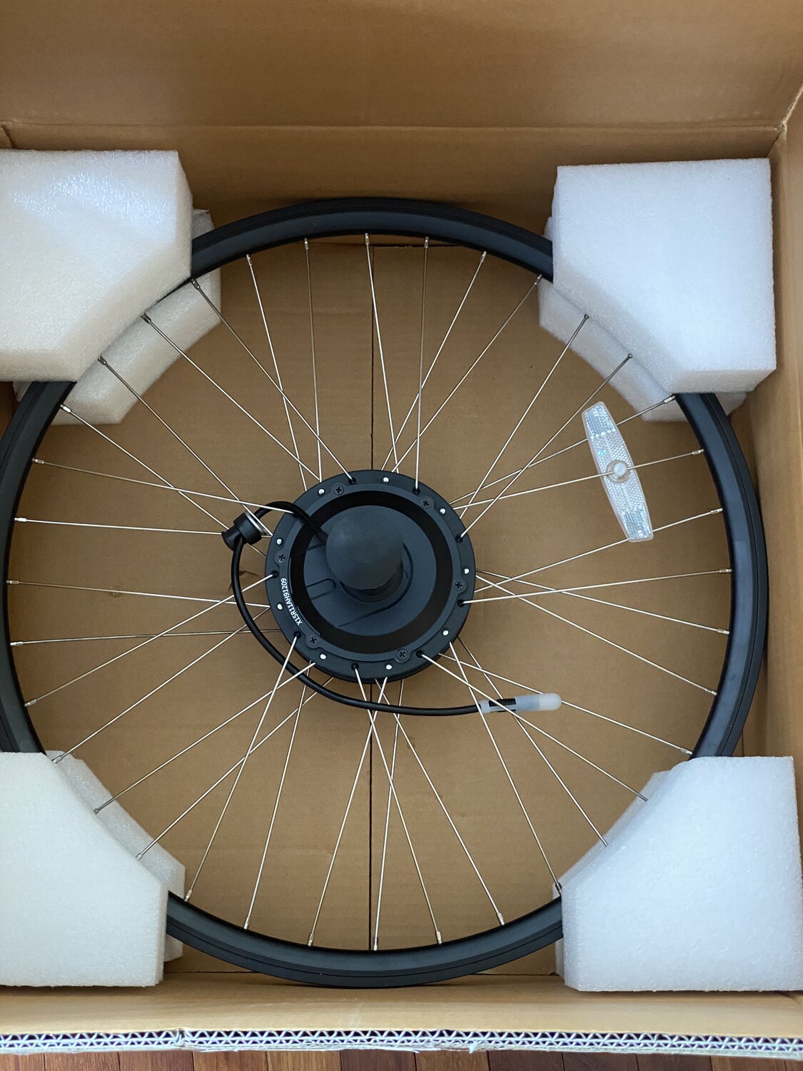

Received the new wheel with motor. No tire attached. I can’t install this myself and will need to bring it in to a service shop.
It honestly isn't that difficult and not only is it a skill well worth learning but you will also feel accomplished afterwards. I guess that Leon will pay for the LBS to do the job for you though but you should at least ask the guy in the shop to talk you through it so that you can do it yourself "next time".
Did they not send you the lovely electirc blue NCMBike decals to stick on too? ;)
Many thanks...I may try it next time,,,but I hope there is no next time!!

Leon Cycles was very responsive and sent me a new wheel/motor. I spent a couple hours swapping out the wheel (not too difficult, and you'll need a readily available freewheel puller), but I'm having the exact same problem. Could this be a controller issue? I could envision where the controller might send incorrect phase signals to the motor, but his seems unlikely.
