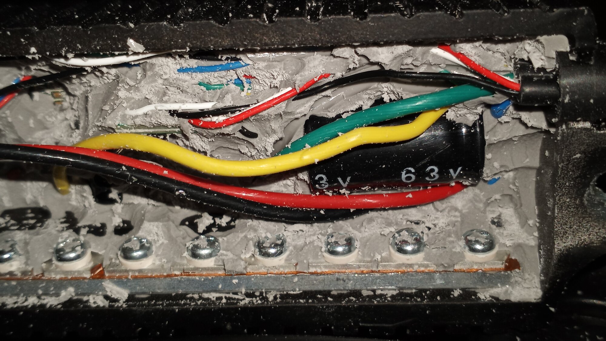

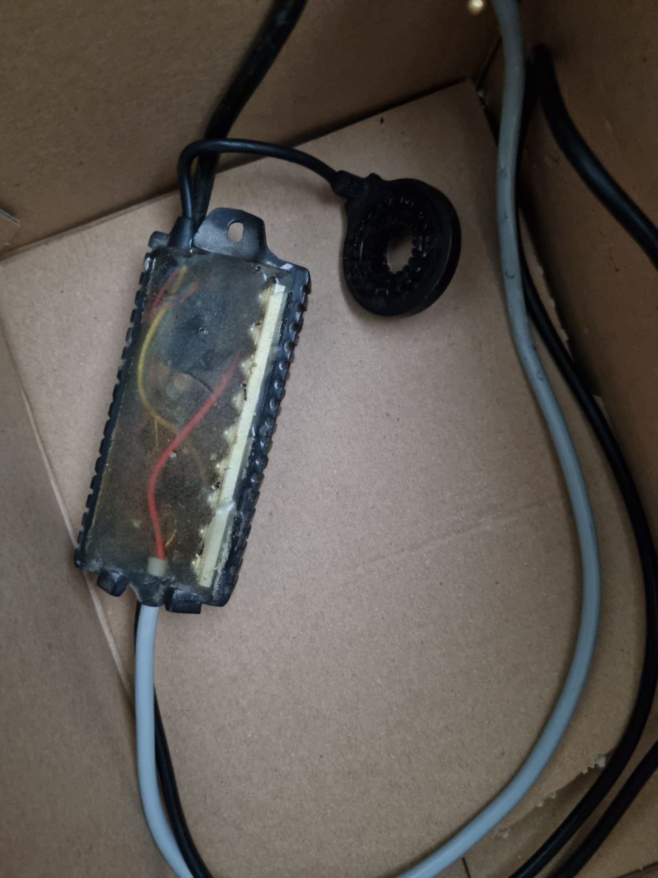

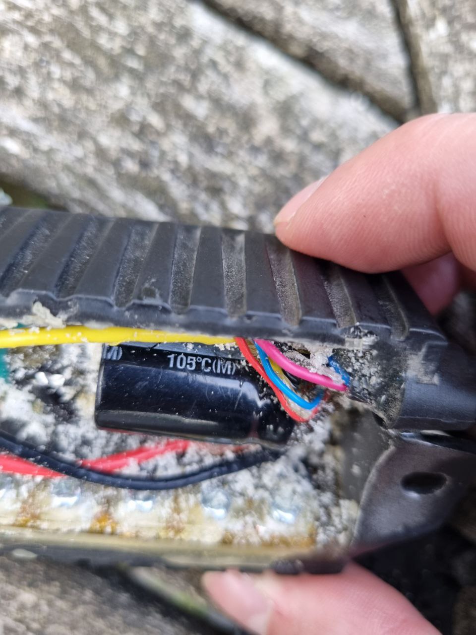

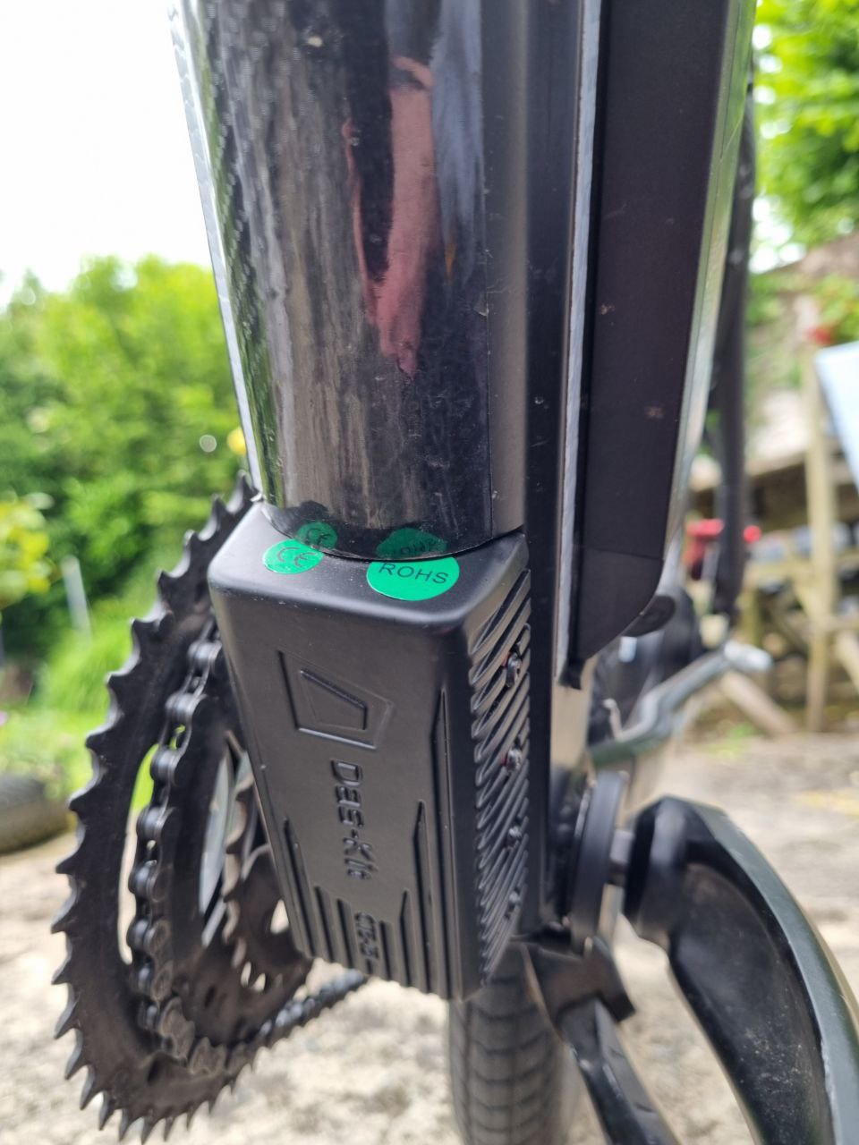

Quick update: Proplem solved! It was the controller! :) Today my new controller arrived so I changed it quickly. The ebike works as it should. Moreover, I noticed that it has more torque with the new controller, now I can reach the top speed in about 8 seconds on flat, and 4 seconds in the air. Before with the old controller it took me somewhere around 12 seconds from what I remember. On the website they say it is an 18A controller.In the first picture is the old controller and in the second the new one with green stickers.

That controller is a bit different than mine was.
My controller was filled with grey colored potting material, and all the cables were black.
I guess that not all CT5-I5 controllers are the same?
I know that the Das-Kit Off-Road display will unlock the European controllers from 25 kph to 32 kph, and that the American display should unlock my Canadian controller from 32 kph to ~45 kph, but I'm not sure if that is true or not.
I was figuring that all CT5-I5 controllers were the same and it was the display that determined the power output and speed, but that may not be true?
The European, American and Canadian CT5-I5 controllers may be different?
When I bought the ebike in 2021, it had a 36v battery and after unlocking the display, the maximum speed reached was 34kph. After I bought the new 48v battery the maximum speed was 45kph. So your controller has a 63v mosfet as I see?M i right? That's good to know! This means that it would also support a 52v battery without problems. The maximum voltage for a 48v battery is 54.3v and for a 52v battery it is 58.8v

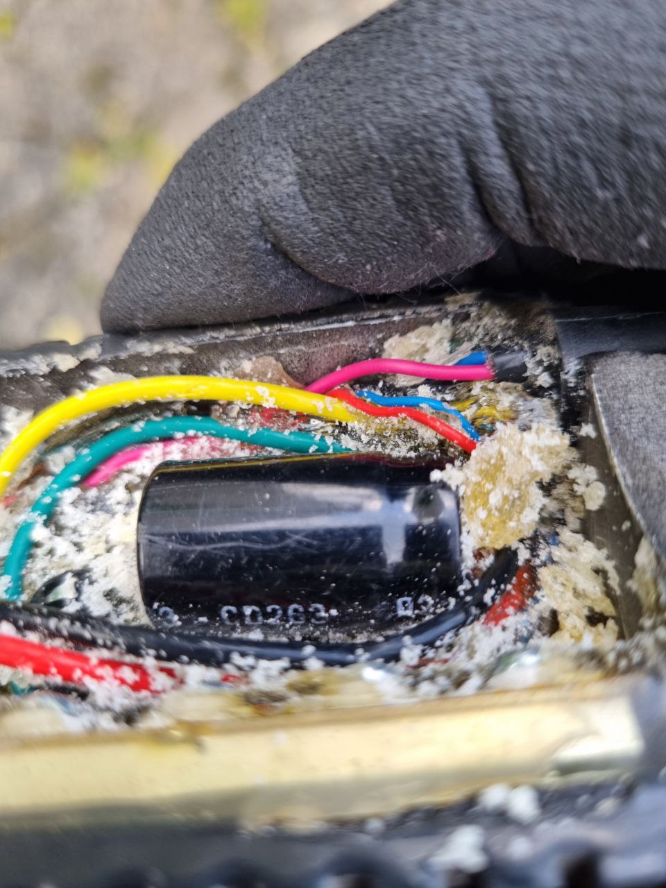

You made me curious so I quickly operated the controller. On that big capacitor it says 3 CD263 D2, and 105°C(M).

I used chatgpt: The 3 CD263 D2 capacitor, rated at 63V, is an essential component in many electronic applications, providing stability, safety and reliable performance.
so this capacitor would support a 52v battery that has a maximum voltage of 58.8v?
ChatGPT
Yes, a capacitor rated at 63V should easily support a 52V battery that can reach a maximum voltage of 58.8V. It is generally recommended to choose a capacitor with a voltage rating that is at least 20% higher than the maximum voltage it will be exposed to to ensure an adequate safety margin.
Detailed considerations:
Nominal Voltage vs. Maximum Voltage:
The nominal capacitor voltage of 63V is well above the maximum battery voltage of 58.8V. This provides a sufficient safety margin to prevent breakdowns and ensure reliable operation.
Durability and Reliability:
Using a capacitor with an appropriate voltage rating ensures that it will not be subjected to excessive stress, which contributes to the long-term durability and reliability of electronic circuit components.
Margin of Safety:
The safety margin of about 4.2V (63V - 58.8V) is considered adequate in most electronic applications, preventing damage caused by minor voltage fluctuations or transient overvoltages. if I put a 52v battery that has a maximum voltage of 58.8v in full charge, does it work without problems? ChatGPT Yes, if your battery has a maximum voltage of 58.8V at full charge and the capacitor is rated at 63V, then it should work fine. The battery voltage is within the rated capacity of the capacitor, providing enough safety margin to protect against surges.

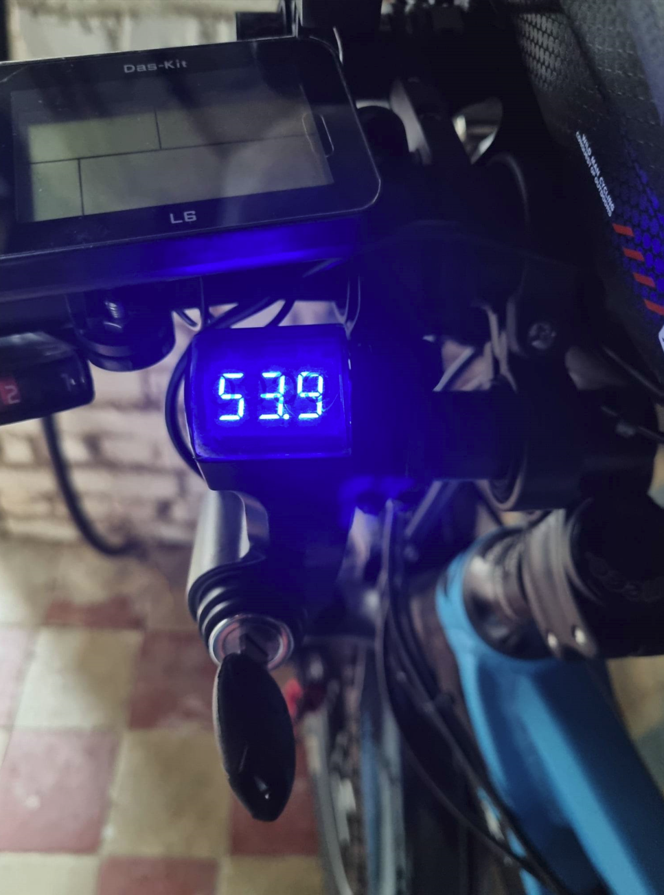

As long as the capacitor of the controller is 63v, a 52v battery will work well. Probably the only problem will be that the display will no longer show you the percentage of the battery, just as it happens when the display is set to 48v and you put a battery on 36v, or vice versa. But you already have a button directly on the battery where it shows you the percentage, in addition to that you can also put a voltmeter like on my ebike I have for example. :)
Just an FYI,..
@Ravi Kempaiah is developing a motor with Ananda.
They are using 80 Volt capacitors for their 52 volt systems.
If there was no point or value in using 80 Volt capacitors, they wouldn't be using them.
58.8 volts plus 20% headroom is 70.56 volts.
54.6 volts plus 20% headroom is 65.52 volts.
A 63 volt capacitor charged to 58.8 volts is charged to 93.3%
An 80 volt capacitor charged to 58.8 volts is charged to 73.5%

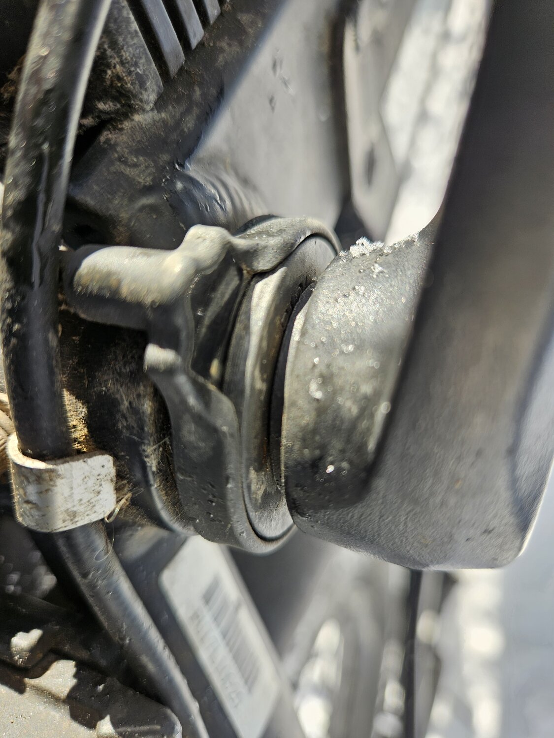

Good news, I got the new sensor (inner ring with magnets) and it finally fixed the issue of on/off power. I totally forgot how it is to ride this bike with a working sensor!!! :)
The "bad" news is that I just found out today the inner sensor could be removed and my magnets were all covered in dirt and rust. Probably I only needed it to clean them?! I'm too tired to try so let's pretend it's broken. My problem is finally fixed. It only cost me €15 shipped from NCM!

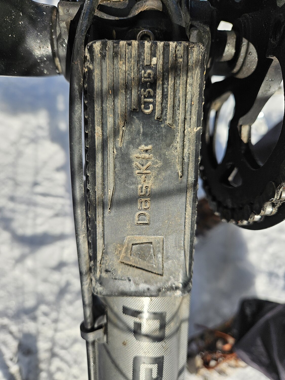

I experienced a similar issue last week where the pedal assist just stopped working. Usually my bike sleeps outdoors even in winter and I had never experienced this kind of malfunction in earlier years. I took the bike indoors, cleaned the sensor and voilà, everything works just fine now.
Looking at the sensor I see there is a cavity where dirt can easely accumulate so a good thing to do is to clean up this area once in a while, I guess.
