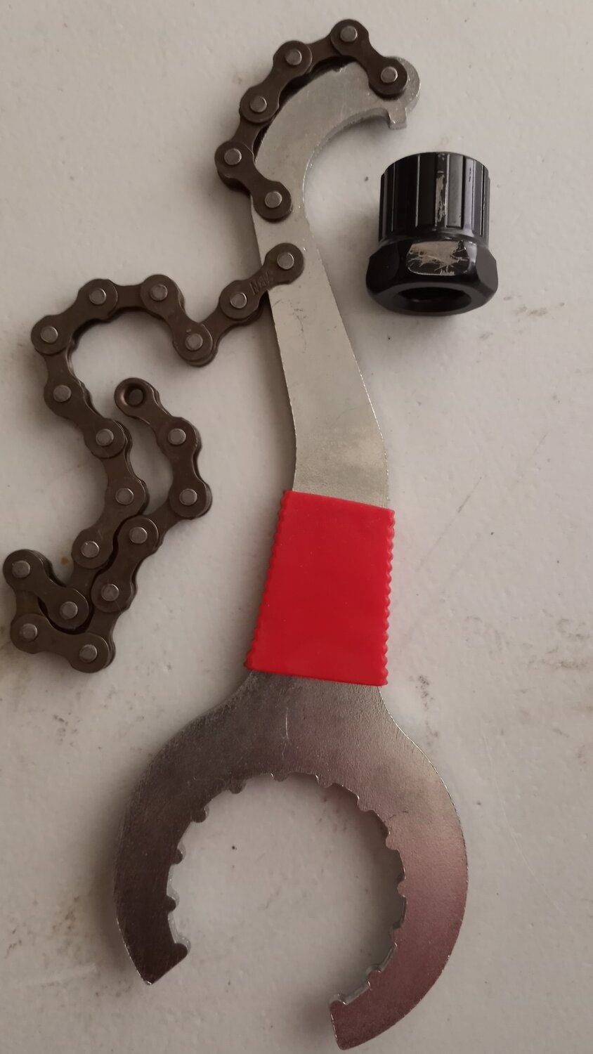

This is the chain whip and freewheel tool I've got. Note the black paint that I scraped off the the tool.
I just noticed that the chain whip has the notch in it to operate as an HCW-17 tool.
I got a whole kit for $20 CAD. (I already have a chain breaker, so I didn't need a kit with one.)
It's all junk but I think everything will work without breaking, except the freewheel remover?
