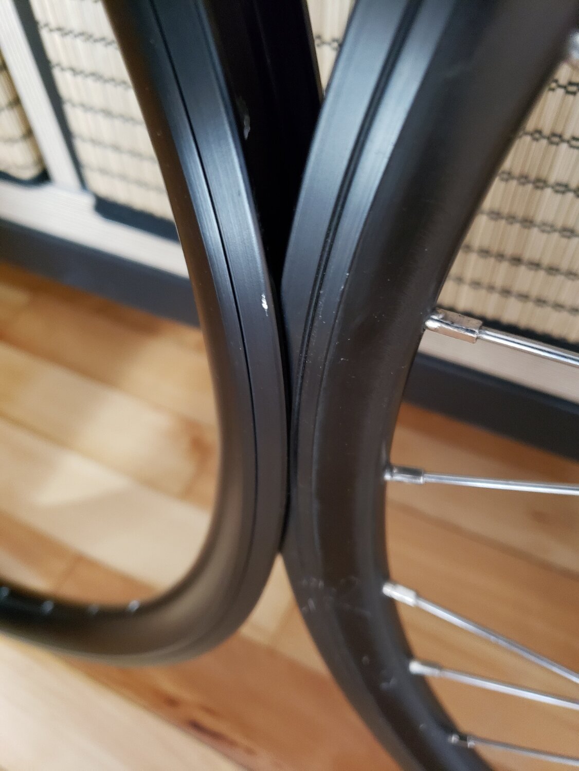

Hi all,

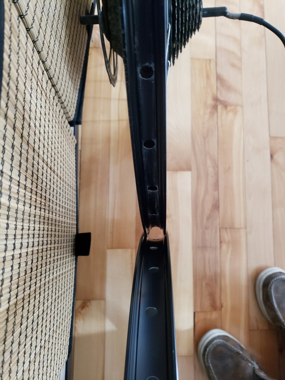

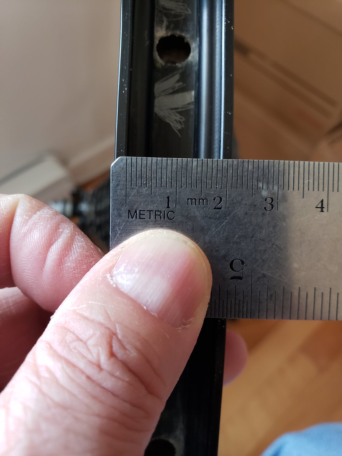

just updating on my fidings while searching for a 27.5 x 1.9mm 36 HOLES/SPOKES rim.
You can see on picks 1 an 2 the new rim is larger than the old one. In fact the old rim fits right into the old rim.
I tried returning the larger rim to Amego and have it replaced by the proper size but after a few e-mails I never got any more replies. They don't know.
The rim is about 50$ including shipping so I elected to take care of it later and ask for an RMA.
So I went along to order from Leon Cycle and they pointed me to the Milano Plus full wheel with motor mounted.
I just needed the rim so this sounded like an overkill. Replacing a 50$ rim with a more or less 450$ wheel, but I did go with it any way.
So I received the new wheel with the motor mounted and noticed again the rim was larger than my own original rims.
Something is wrong, probably my original bike was mounted with older model rims/wheels and the new standard is the wider wheels and they don't carry the older wheel size anymore. If so they just should say so on their website.

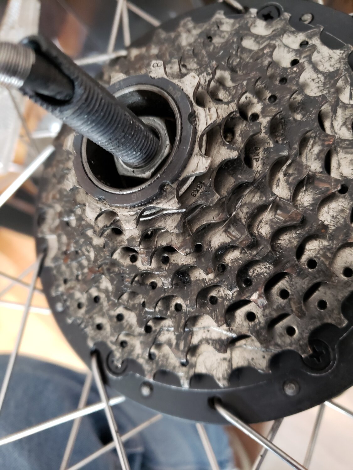

So anyway I decided to mount the new larger rim on my front wheel and install the new larger wheel whit the motor in the back as it should be. Easy, right? Not so said the blind man.
I have to dismount my disk rotor from and cassette and install them on the new wheel. The rotor is easy but come to dismount the cassette is different. Obviously my FR-5 tool does not work on this. Notice the lock ring is outside of the gear assembly (pics 3 and 4). I've been to the bike shop and they dont sell this tool so I will need to bring the wheel in to have the cassette removed, possibly replaced with a compatible 8 gear cassette.
I just want to ride the bike.:mad:

Hi all,
I have to dismount my disk rotor from and cassette and install them on the new wheel. The rotor is easy but come to dismount the cassette is different. Obviously my FR-5 tool does not work on this. Notice the lock ring is outside of the gear assembly (pics 3 and 4). I've been to the bike shop and they dont sell this toll so I will need to bring the wheel in to have the cassette removed, possibly replaced with a compatible 8 gear cassette.

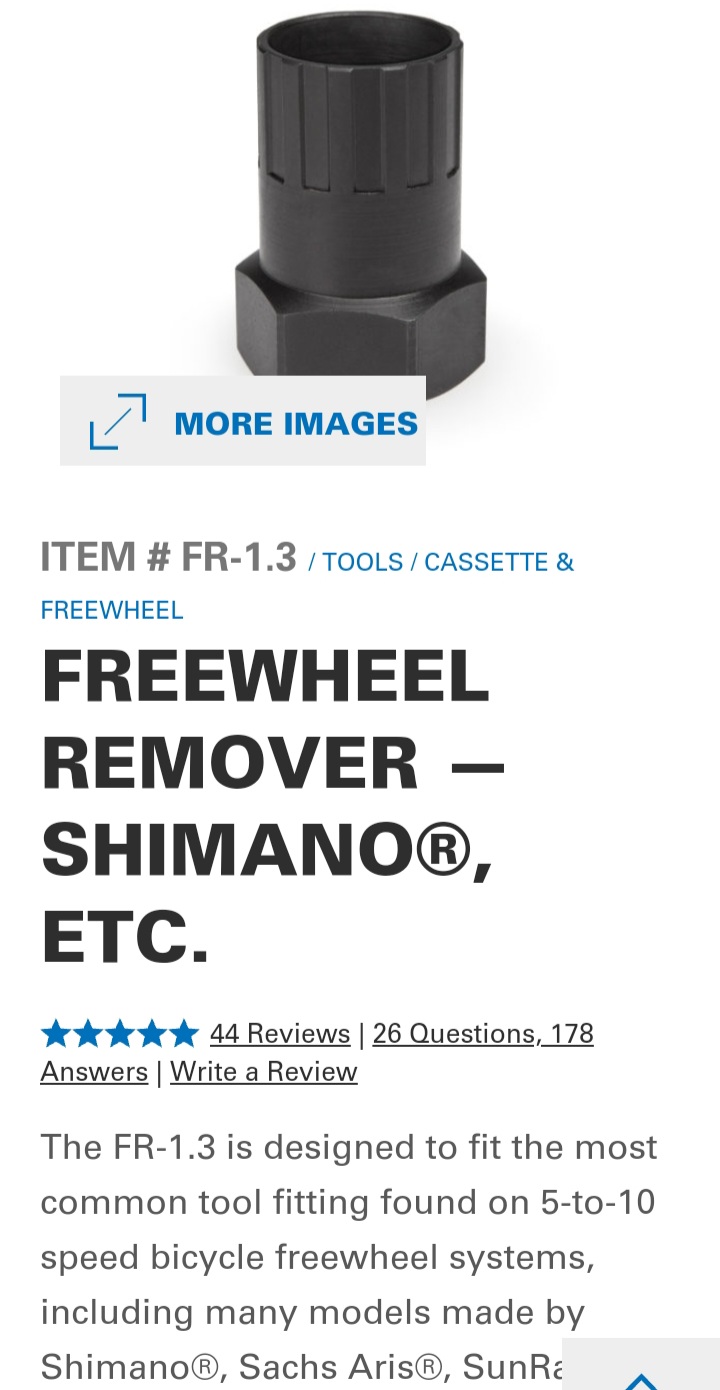

You can get a freewheel removal tool from Amazon at:
If you want the Park Tool version and are willing to pay a bit more, MEC have them:
I have used the knockoff version with no problems. Worthwhile investment if you need to replace freewheel down the road.
PS - I agree that that is an expensive way to replace a rim! What is the width of the new wider rims?

Hi,
The actual inside width is 2.5mm compared to 1.9mm for the original.

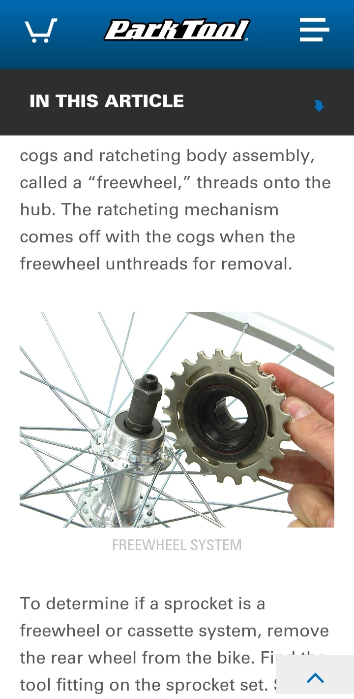

I don't profess to be an expert on this, but as far as i know the Milano+ has an 8-speed threaded freewheel (mine does) and a freewheel removal tool like the one I pointed to is what is needed. However, if you're taking it to your LBS, no doubt they will get it done. You might take note of what tool they use.

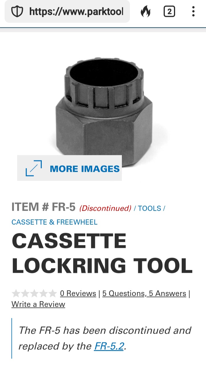

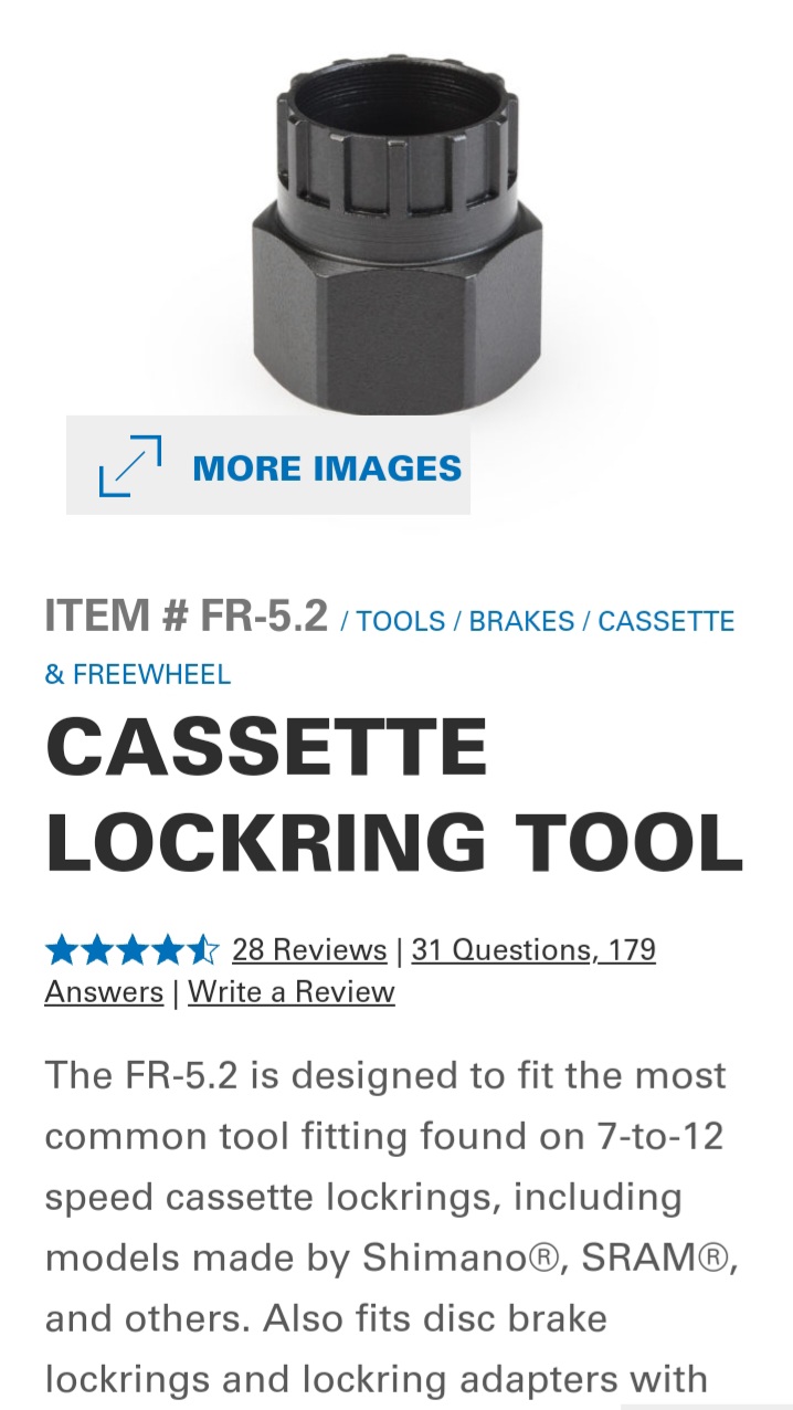

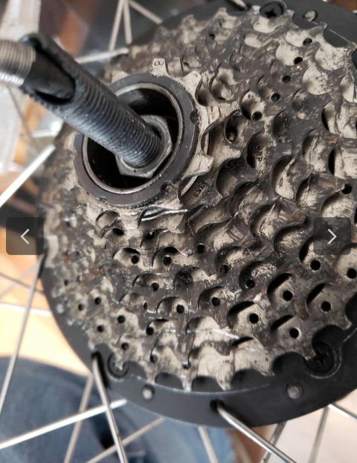

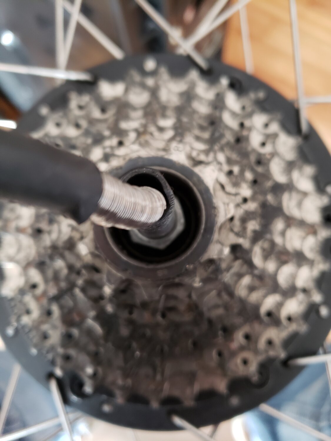

,.. The rotor is easy but come to dismount the cassette is different. Obviously my FR-5 tool does not work on this. Notice the lock ring is outside of the gear assembly (pics 3 and 4). I've been to the bike shop and they dont sell this tool so I will need to bring the wheel in to have the cassette removed, possibly replaced with a compatible 8 gear cassette.

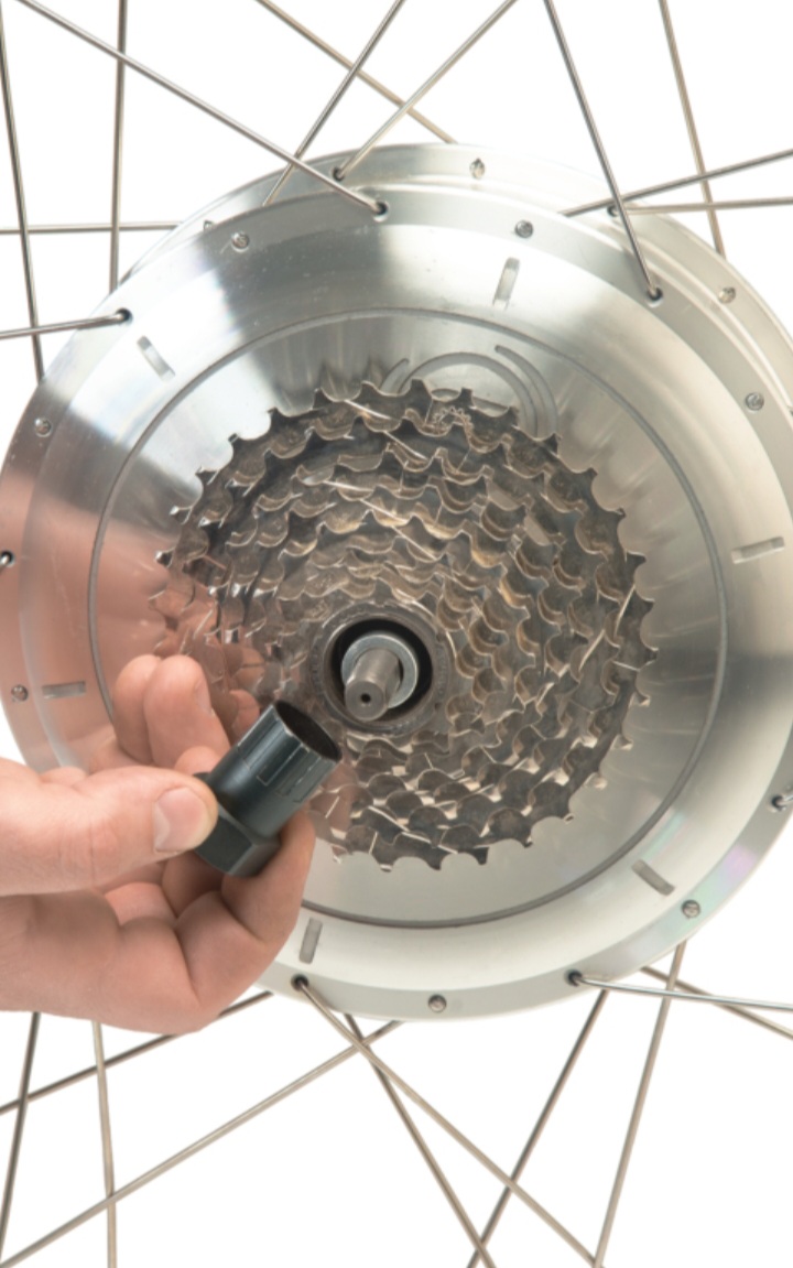

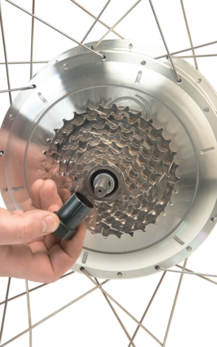

I'm pretty sure that the FR-5 tool is what you need to remove the entire freewheel from the hub.
The FR-5 has been replaced with a similar tool with more reach.
You might need one with a longer reach?, but it has wider splines that are more shallow.

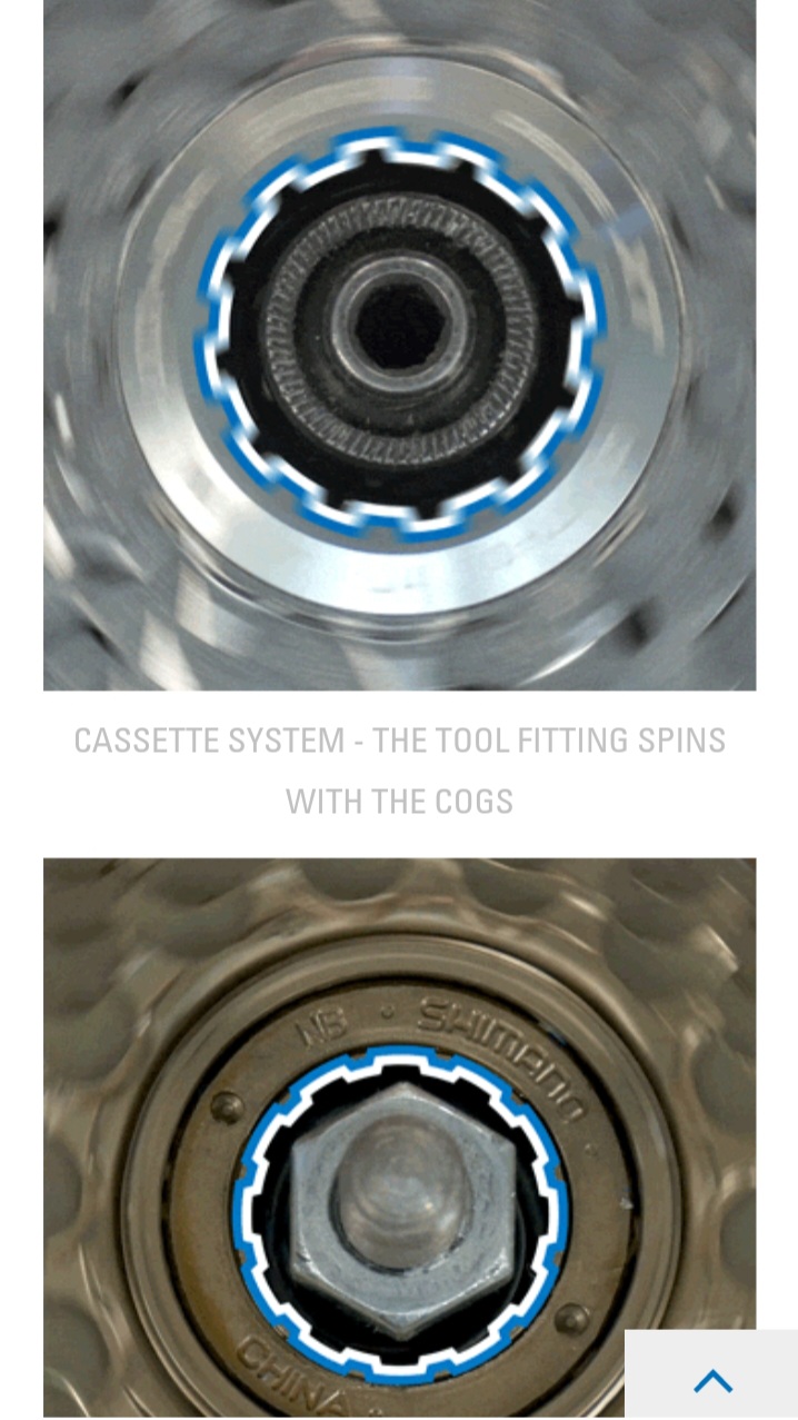

Screenshot_20230423-000042_DuckDuckGo.jpgScreenshot_20230422-235356_DuckDuckGo.jpgScreenshot_20230422-235445_DuckDuckGo.jpg

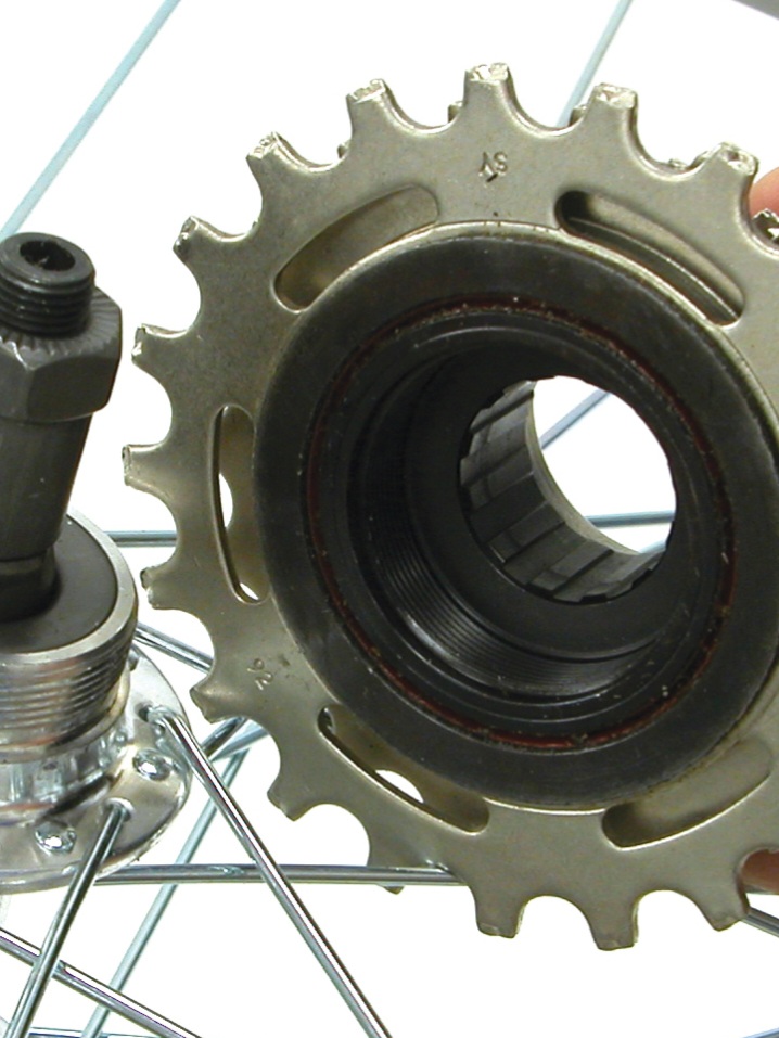

You would feed the motor cable through the tool to get inside the freewheel.
You've got the hex nut inside the freewheel, so you probably have the older design that doesn't require a chain whip.
Screenshot_20230422-234027_DuckDuckGo.jpgScreenshot_20230423-000714_DuckDuckGo.jpgScreenshot_20230423-000544_DuckDuckGo.jpg
Notice the splines inside the freewheel,..

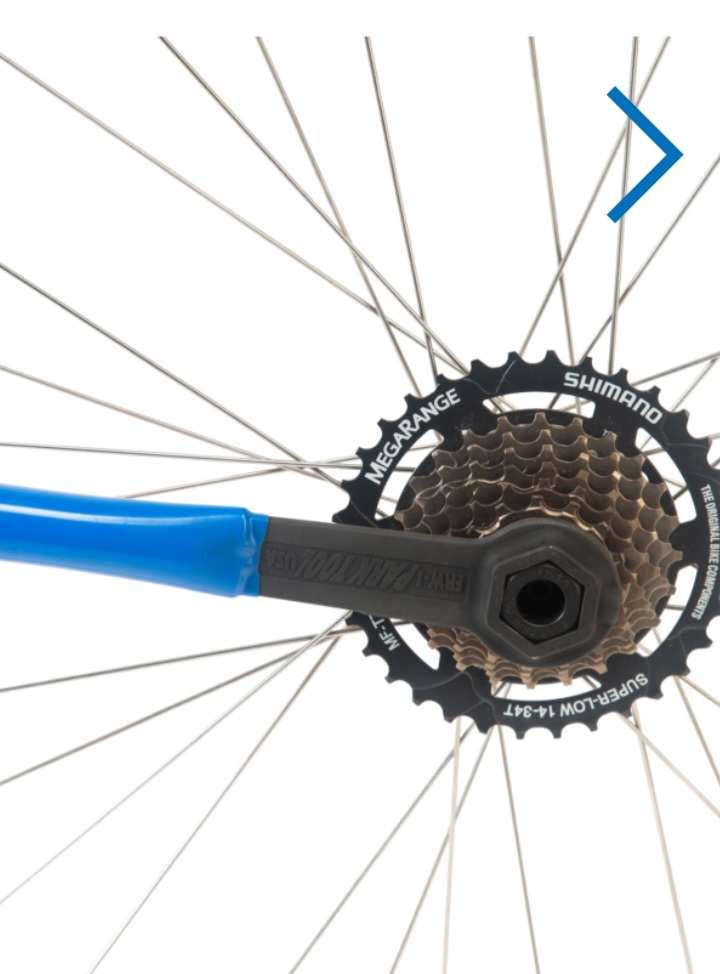

The HCW-17 is for taking the cluster itself apart to replace a single sprocket.
A lot of people need to replace their small 11 tooth gear.
I'm no expert either but after watching the Park Tools video and looking at what you're working with, I'm pretty sure the tool that you need is the FR-5.2 or the longer FR-1.3
I've got the knockoff version like Fred has and I'm worried that it will snap if I ever go to use it.
It's not hardened steel, it's just a piece of crap painted black. Lol 😂
It's a really thin walled tool with not much meat to it and the freewheel can be seized up really tight on the hub.
The wrench they use to turn it has a two foot handle for tons of torque.
I'd suggest getting the proper Park Tool version that's hardened alloy steel.
Try to count the splines and get an idea of their dimensions if you can see past the axle inside your hub.
View attachment 152195View attachment 152196
View attachment 152210View attachment 152211View attachment 152212
