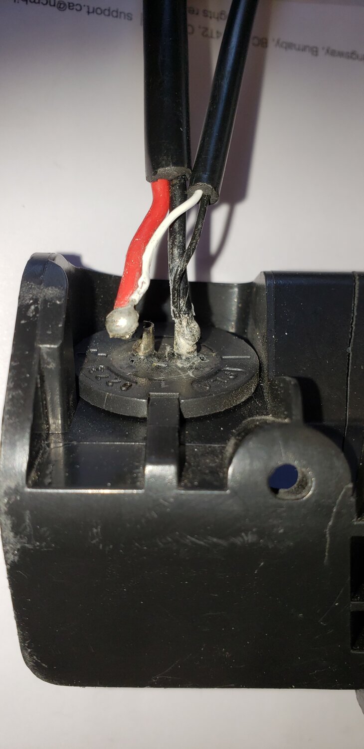

I have a NCM Milano Plus. I really like the bike.
But I recently experienced some power issues as many have mentioned in this forum. I followed instructions other members had provided and they were very helpful in troubleshooting the the issue.
I was riding the bike a couple of days ago and the power completely shut off. I was not able to power up the bike and I had absolutely no display. I had to ride the bike back home on manual power. Fortunately I was not to far from home.
After disconnecting the front light and both brake cutoff switches, I still had no reading on the display. I continued with disconnecting reconnecting all cables making sure no pins were bent or out of line.
The battery LED showed the battery was fully charged. Eventually I noticed the top mounting socket for the battery was just a bit loose. There are 3 screws securing the socket to the frame. One to the top of the frame, one to the side and one to the bottom of the frame. The ones at the top and side were very tight but the one on the bottom was a bit loose. I had to buy a 1-inch screwdriver to get to this one as the space is small.
Once I unscrewed the mounting I connected the battery and the power came on and the display was fully functional. Twisting the wires and the power went back off which led me to beleive it was a faulty connection. After Inspecting I found the weld on the positive terminal of the socket was broken.
The picture below shows the inside of the battery locking mount piece. You can see the weld is clearly broken on the battery's plus/positive terminal of the socket. Further you can see on the right hand side that the part is cracked 2/3 of the way from top to bottom.
Just ordered the part and I should be back up and riding shortly.
nice find :)
