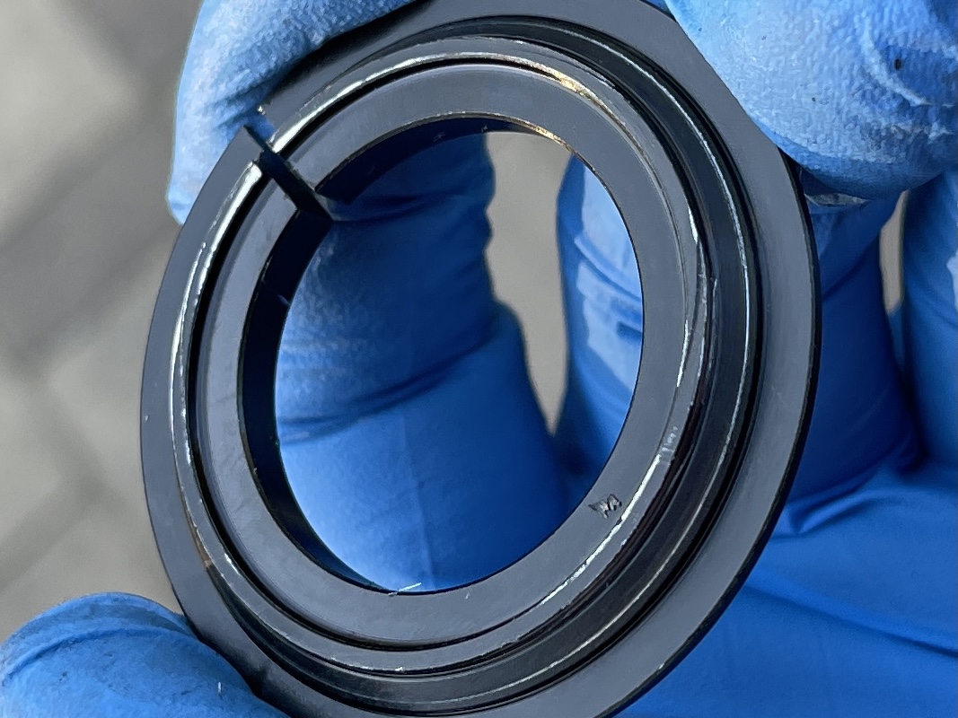

Anyone have a problem with a loose headset on the Moscow? I could never get mine to not rock back and forth at the top.
I’m in the process of upgrading the fork so I took the headset out and found that this bike uses a crown race reducer to fit the straight steerer tube fork with the tapered head tube and tapered headset. My crown race reducer had gotten all chewed up from the bottom bearing rocking over it. So I decided to buy a new headset because of this damage. Luckily I removed the top and bottom cups of the headset because I learned the bottom cup is a hard to find size, it’s a 55mm vs the more used 56mm cup. I got tonight and as I compared the fit of the new vs the old head set on the fork I noticed the original Neco headset is extremely loose at the top bearing (not at the bottom bearing where the damage was). The top compression ring of this headset isn’t holding the bearing snug and this allows the top of the fork it to wiggle around just under the stem.
Can someone that has an NCM Moscow with the original fork and original Neco headset check to see if your headset is loose? I want to know if it’s just my bike that had a flaw.
The way I tested it was to stand next to or in front of the bike, squeeze the front brake with one hand and put your other hand around the headset just below the stem and rock the bike back and forth while the front brake is locked up. If it’s loose you will feel movement between the Neco headset and the part of the frame it sits on (head tube).

pic of the damaged crown race reducer:
