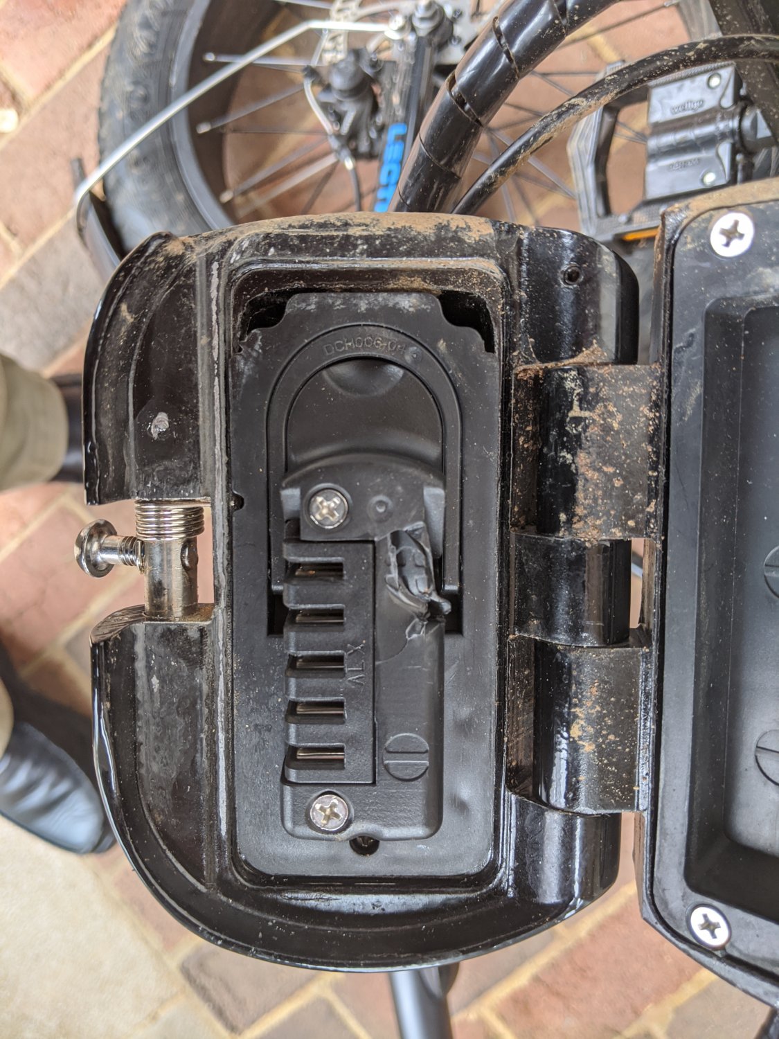

Noticed this while swapping batteries today, looks like a good place for some more loctite! My other battery is fine though.
hey so yea hope its just a hardware issue and Loctite or resealing the joint works/ed. but if you start noticing its capacity dropping fast or excess heat be careful. I hope im not telling you stuff you already know and I cant really see from your photo what the cause is. but lithium ion batteries can produce gasses and because theyre sealed cells if they do they puff up / expand. this could cause things to get pushed out slowly. At least with other cells ive seen expanding from gasses there didnt seem to be much danger just a sharp decline in capacity. but I never continued to use them long after they start puffing up. Excessive heat coming from the battery is the only dangerous thing to watch for as far as I know. anyway hope it was an easy fix.
To SpEdward; I ordered and received my Lectric XP in December 2019, received it one week later in perfect condition. Not a single screw, bolt, or pedal was loose! Every item on this ebike is working as it should, perhaps, I am one of the lucky ones. However, documentation did caution, to check all of these items to make sure that they were secure. I suspect with what is going on in China with the virus outbreak, delivery of these ebikes will be delayed as well as everything else that comes from there.
It was just the case coming loose, the batteries are separate.

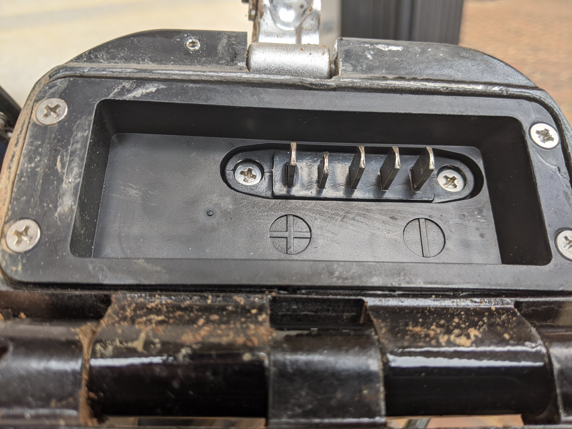

I took a spill the other day (too fast on wet bricks), broke the right brake lever and the electrics went out. I checked the battery to reseat it, and it looked like this:
I also noticed one of the posts (second one in on the left, the positive side) was indented in, lower than the other posts.
Is that normal? It works again, but I'm waiting for the brake lever to arrive from Lectric.
Thanks for the help.

Posts are all the same height on mine.

Mine all the same

Mine are all the same length.
if its still working id guess the wire connection is still ok. but probably moved just enough plastic to not hold the post tightly.? have you tried to move it with some needle nose pliers? if it is easily moved around I would try pulling it flush with the others and melting the plastic around the base so that it holds it snug again. otherwise taking those screws out n seeing what it looks like from the back side. its not the battery so shouldn't haft to worry about getting shocked
