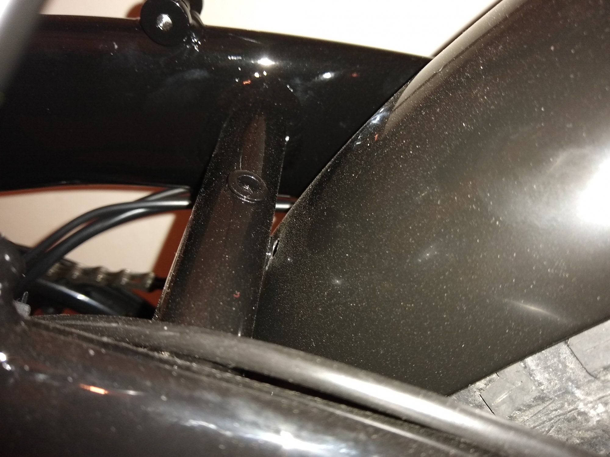

My rear fender rattles. How many spots is everyone's rear fender attached to the bike? Mine is attached at the bottom by the peddles and on the back with the wire. About a third of the way back it looks like there's a place for a screw, but there isn't one. Should there be??42695
