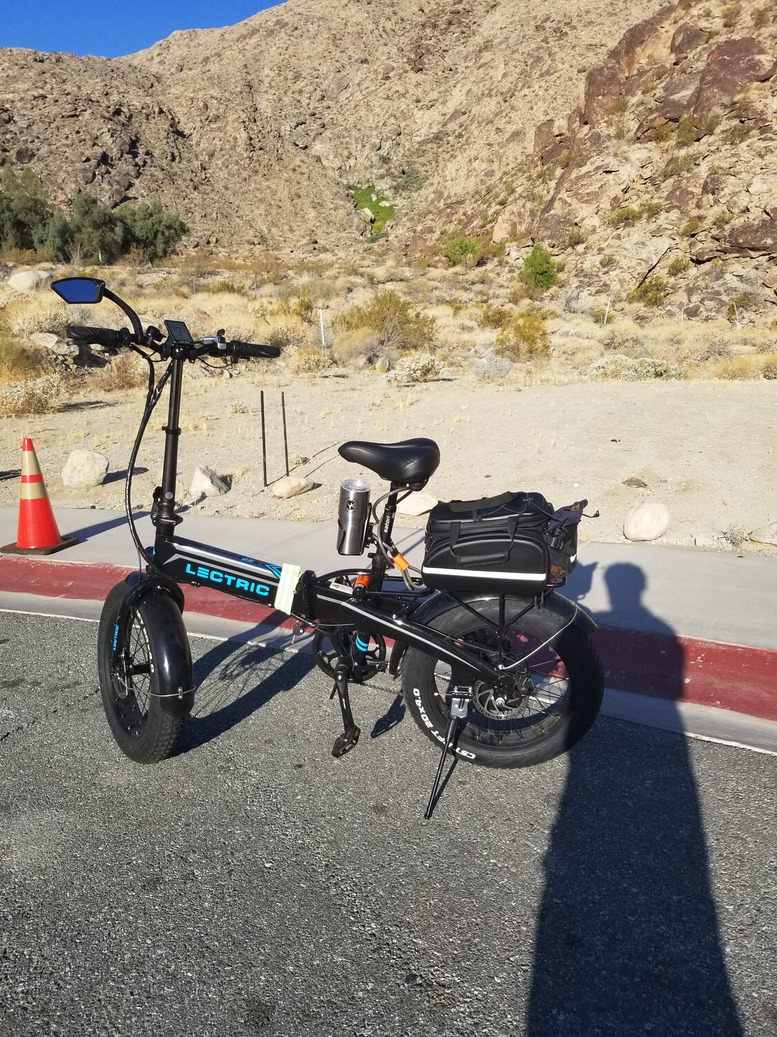

I ordered mine on May 27th and it arrived July3rd as advertised. My rear brakes need adjustment and other than that the bike has performed like a rockstar. Accessories arriving daily courtesy of Amazon!
Congratulations, interesting location for your coffee holder.
Its actually my water holder. The holder I ordered is too big for the small bottles that we buy at the grocery store, so I broke out the stainless tee prize from the golf club. It's all part of my new weight loss routine. Up by 5am. On the road to the golf course at 615. Hit 30 or 40 wedge shots then take a 10 mile trek home. So far I have gained 3 lbs. People say I should pedal more...
I ordered mine on May 27th and it arrived July3rd as advertised. My rear brakes need adjustment and other than that the bike has performed like a rockstar. Accessories arriving daily courtesy of Amazon!View attachment 59004
I like your rear bag. By the way what is the patch doing on the frame? Is it to keep the latch secured or anything else????
