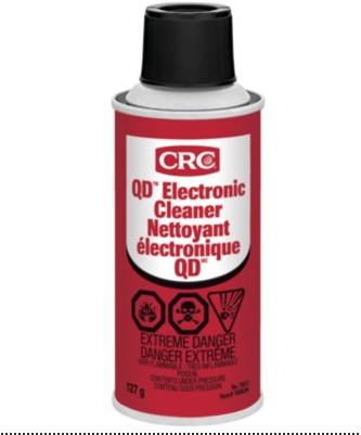

What are thoughts on this product?
To spray on battery connections on bike and on battery.
Qd Electronic Cleaner. Excellent Precision Cleaning Solvent. Instantly Removes Oil, Grease, Dirt Or Flux From Tape Decks, Radios, Office Equipment, Computer Components, and Other Sensitive Electrical Equipment.
  • Instantly penetrates hard-toreach areas to safely dissolve dirt and debris from sensitive electronic components
  • Leaves no residue
  • Cleans contacts, connectors and sensitive electronic equipment
  • Helps prevent contact failure
  • Quick drying, plastic safe formula leaves no residue
  • Cleans contacts, connectors and sensitive electronic equipment. Helps prevent contact failure
  • Leaves no residue
That should work. I like that it is “plastic safe” although I would still be wary of getting it on the exterior paint finish. Just in case. 😊
  • Leaves no residue
That's what I use works well
I pick it up tomorrow, but today no battery errors. Hope that continues and I'll use the stuff anyway. A clean contact is a happy contact!
I've chased too many intermittent errors in electronics to think it won't be back without some kind of intervention, and the impact reset isn't always the best choice.
