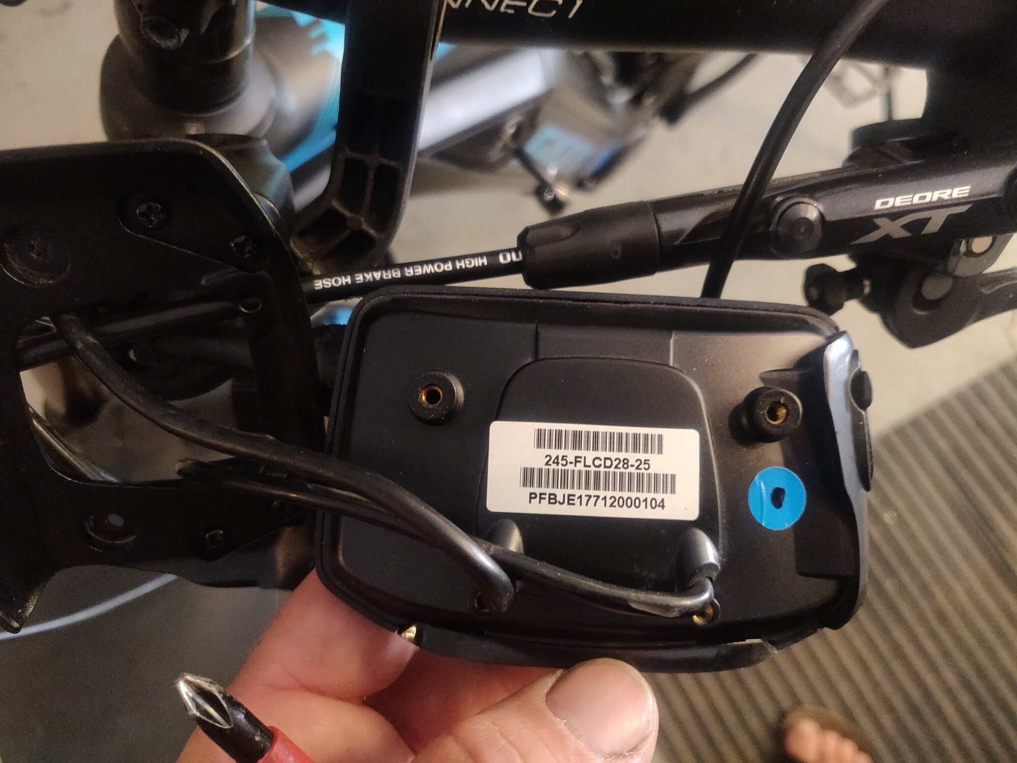

Here's a picture from behind the screen. Is this a newer model?
The bike is purchased in Germany and we live in Finland. The owner would not want to send a bike to Germany for warranty service. I study this a little bit for studying, too. We have a Giant fault code scanner in a store, and I was wondering if the bike could be taken into account because it only costs 20-30e. How accurate those testers are with the fault codes, or whether their response is closer to chance 😁
That's the newer screen so should be waterproof ( so long as it's not damaged ) - I've subjected one of those to pretty extreme wet weather without issue.
