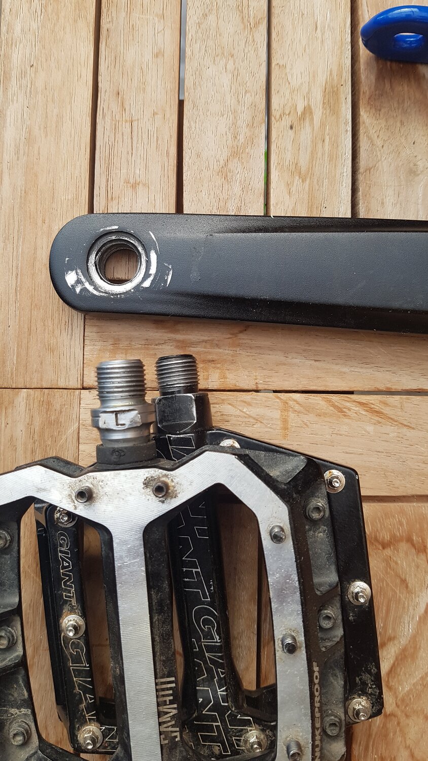

I have a Explore E+1 and I too have had many issues with it. I got the bike from a dealer in Essex in March 2020 just before the lockdown, I live in Oxford.
7th April I cycled home from work in the rain, needless to say the electrics packed up. Despite all the info on here Giant, both via email and at the local dealer said they'd never heard of this happening. It took 3 weeks to fix and I got it back on 28th April. I had to pay £60 Labour as this was not covered. The new bits: thumb controller and display seem modified suggesting Giant do know about the issue.

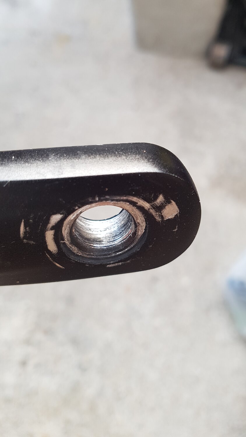

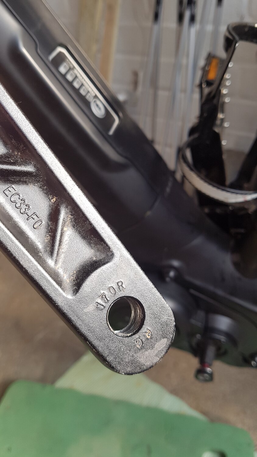

But here's where it gets astonishing. On 8th May I went for a pootle along the Oxford canal. In a bumpy bit just north of the city the Left pedal went from secure to off in 500 yards, stripping the thread as it went because the alloy is so soft. After getting rescued when I got home I checked the pedal arm to find the bike has 2 Right crank arms fitted and 2 Right pedals fitted. Pictures supplied. I was going to fit other platform pedals to the bike too!
I have contacted Giant directly about this and apparently the bits are now on order.
But the pedal arm is some random make called SAMCX they sell at £10 an arm on the net. Not what I would expect to find on a premium brand. Because Giant only list 1 arm for the bike I am expecting another Right arm to arrive, so this process will continue to happen. It's why the Left has a Left hand thead!
I have been looking for other pedal arm makes to fit. Shimano do the FC-e6000 but they are no stock everywhere. The arms are square taper JIS fit while most other ebike makers have changed to Isis. This is old tec really.
While checking the bike over I noticed the rear light does not work. I took it off and saw it is bolted directly to the rack without a diaphragm to absorb shock. I checked supply with a volt meter. The light is an Axa Blueline 6V but the supply measured 8.86V - 10V. This over-supply and the vibration would kill most lights.
As it stands I have had the bike 2 months or 9 weeks. Of this it has spent 3 weeks at a dealer and another week broke in my garage.
These bikes are not built fit for purpose. The groupset, fork and motor are good but the bike fails with anything Giant got involved in. Their Giant ride evo app does not work, even the paint is flaking off at 2 months old!
I guess I chose wrong. There are no parts available on the net and the dealer is slow to get bits due to Giants tardy approach.
I could never recommend a Giant anything to anyone now.

That's sucks, I'd be fuming if I had your experience. Thank you for sharing and documenting the issues. Fellow Explore E+1 owner, bought around the same time with 700km of (dry) riding. Fortunately mine hasn't missed a beat but I do intend to commute in the rain. The Australian models seem to come with different pedals - Wellgo M149s. Does UK consumer law provide any avenue for exchange or refund?
Those two pedals are L&R threaded? Sounds and looks like your dealer is a complete idiot. I'd say they swapped out a crank arm off your bike for another customer and received the wrong replacement from Giant and fitted it anyway. The Nukeproof and Giant pedals don't even match. Did you buy it like that?
That I think is an avenue I am going to have to explore. Giant dealers are hampered by the parts department. The man I spoke to said the pedal arm is coming from europe so will be a week just to get to the dealer!
Hi, The pedal on the top is a L pedal not from the bike. Its a SAM HILL platform pedal. The one underneath is from the bike. Can you see the threads are different. The SAM HILL pedal is LH thread and marked L, the Giant pedal is RH or normal thread. The pic with the Pedal arm showing it is RH has the other giant pedal and arm in the background still attached to the bike. I did ask the dealer if they removed the pedals when fixing the electrical issue as the receipt states it had a new motor. They said it's a standard receipt and they never touched the pedals. I hope this makes the pics a bit clearer. Proper poop!
