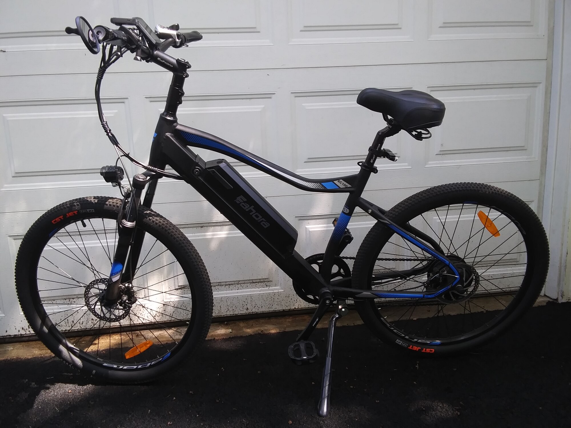

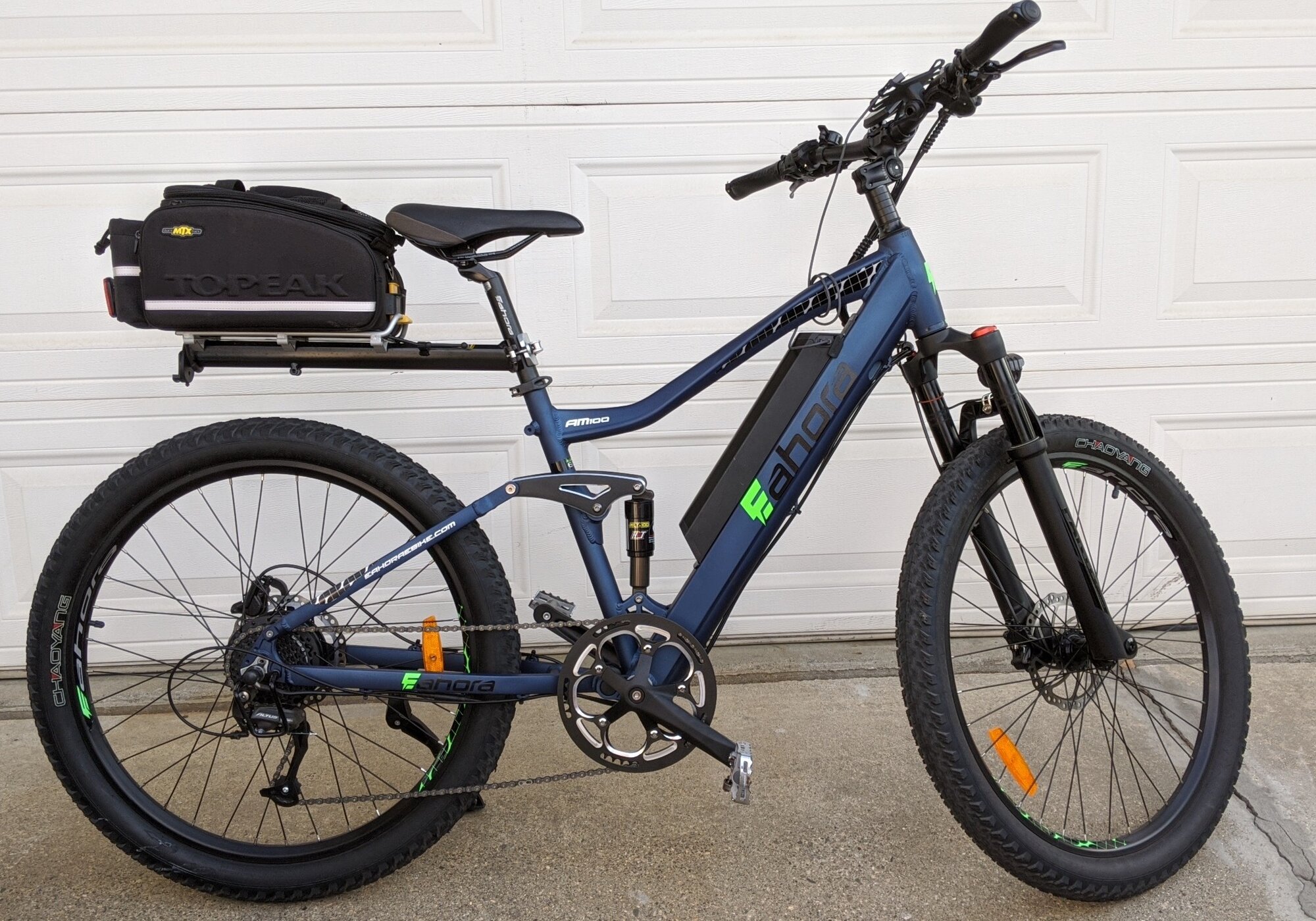

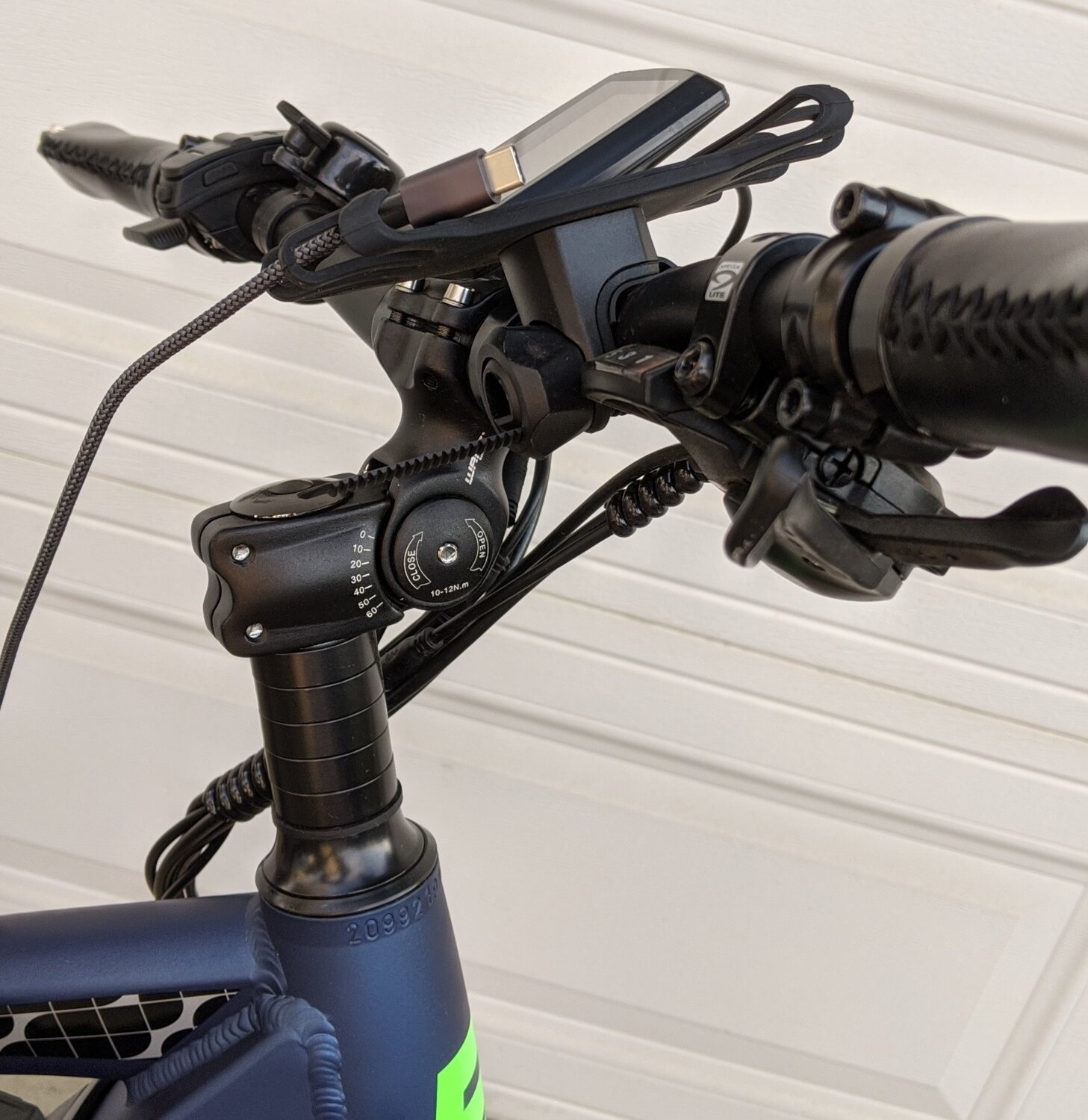

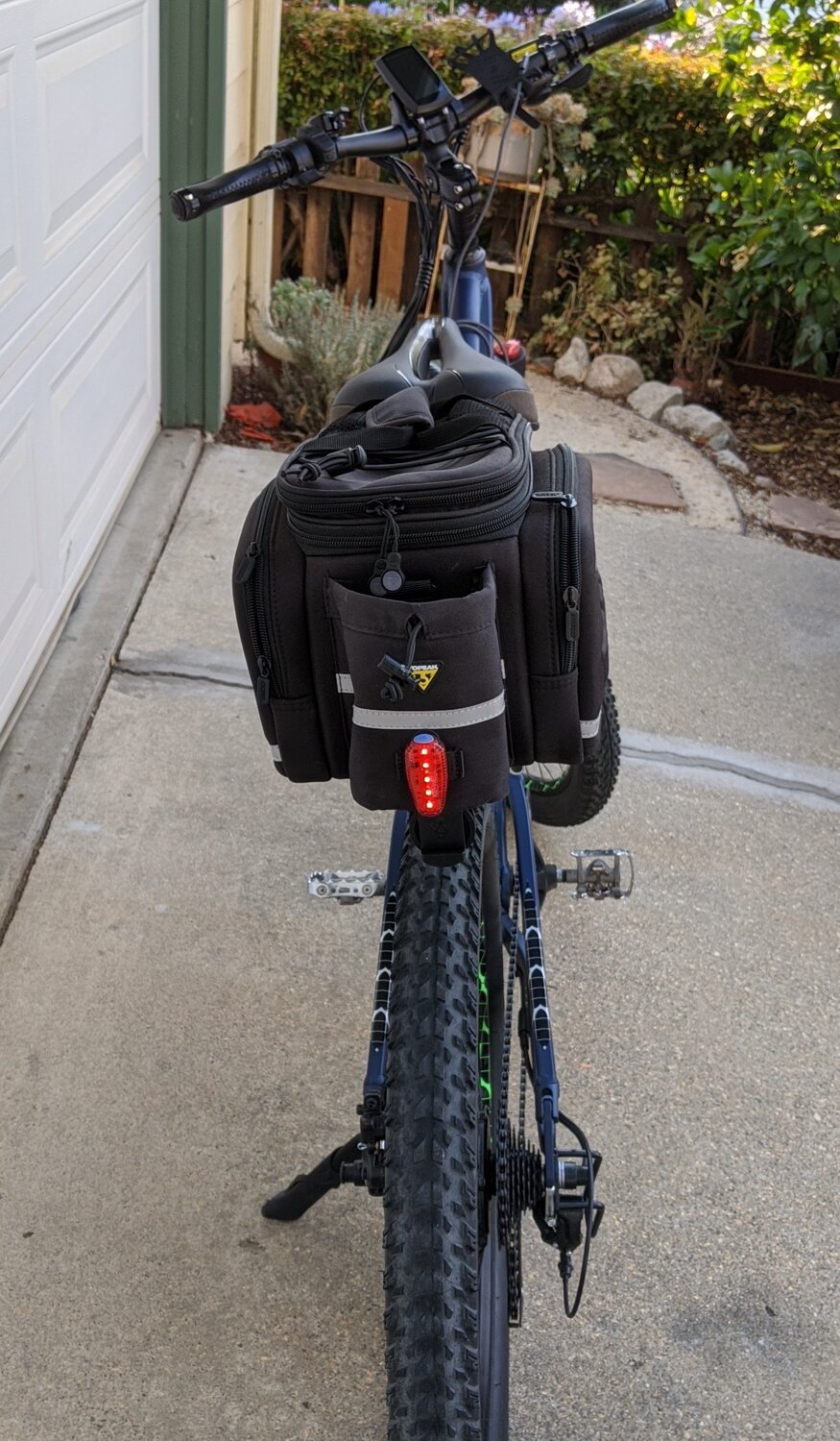

ZZ,
Here's my latest configuration with all its mods and accessories:
  • Serfas seat
  • Pivoting handlebar stem
  • Phone holder and USB cord
  • Taillight
  • Topeak MTX bag and rack
  • Clipless hybrid pedals (one side flat, the other spd)

Nice! Interesting that your throttle is on the left side whereas mine is on the right. Your shifter looks different from mine as well. Are you using the USB port on the battery for your phone? Just wonder how many watts that draws.
My Selle seat is much improved over the 2nd seat I tried, but no seat is perfect, I suppose.
I'm pretty much done with accessories for now, but am waiting for the suspension seat post. This is the taillight I got and it's working well--it has a blue/red flashing option in addition to the white but I'm hesitant to use mode that since it could be seen as impersonating a police bike!
Also I still have the Maxxis Hookworm tires to put on.
I tried this bike cam but it is kinda flakey--can't tell when it's on and recording, and Amazon stopped selling it. Would be perfect since it has an internal battery and it's very small, but still 1080p.
Haven't changed any of the PAS settings because I'm satisfied so far with the settings as delivered, but I do need to go into the advanced mode out of curiosity to see what they are.

Did you see the stem that I have to replace the original? Even with that short stem, I need the seat all the way forward to ride upright. Is there a reason you are not interested in the smaller (and cheaper) XC100? I think it would fit you better. The main difference is the that the XC100 does not have rear suspension, only 7 gears instead of 9, and smaller tires. The eAhora webiste states that the AM100 is best for riders 5' 7" and taller. The XC 100 is for 5' 5" and up. https://www.eahoraebike.com/products/eahora-xc100-e-pas-mountain-electirc-bike
