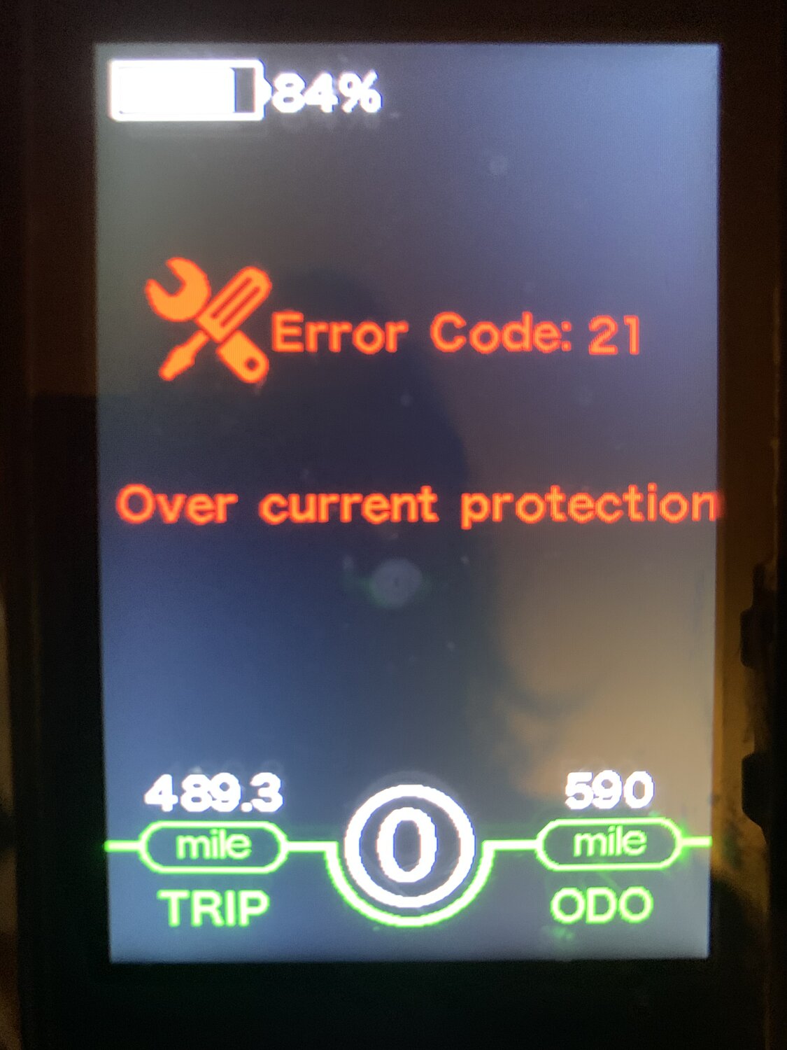

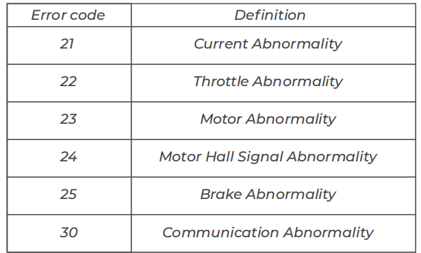

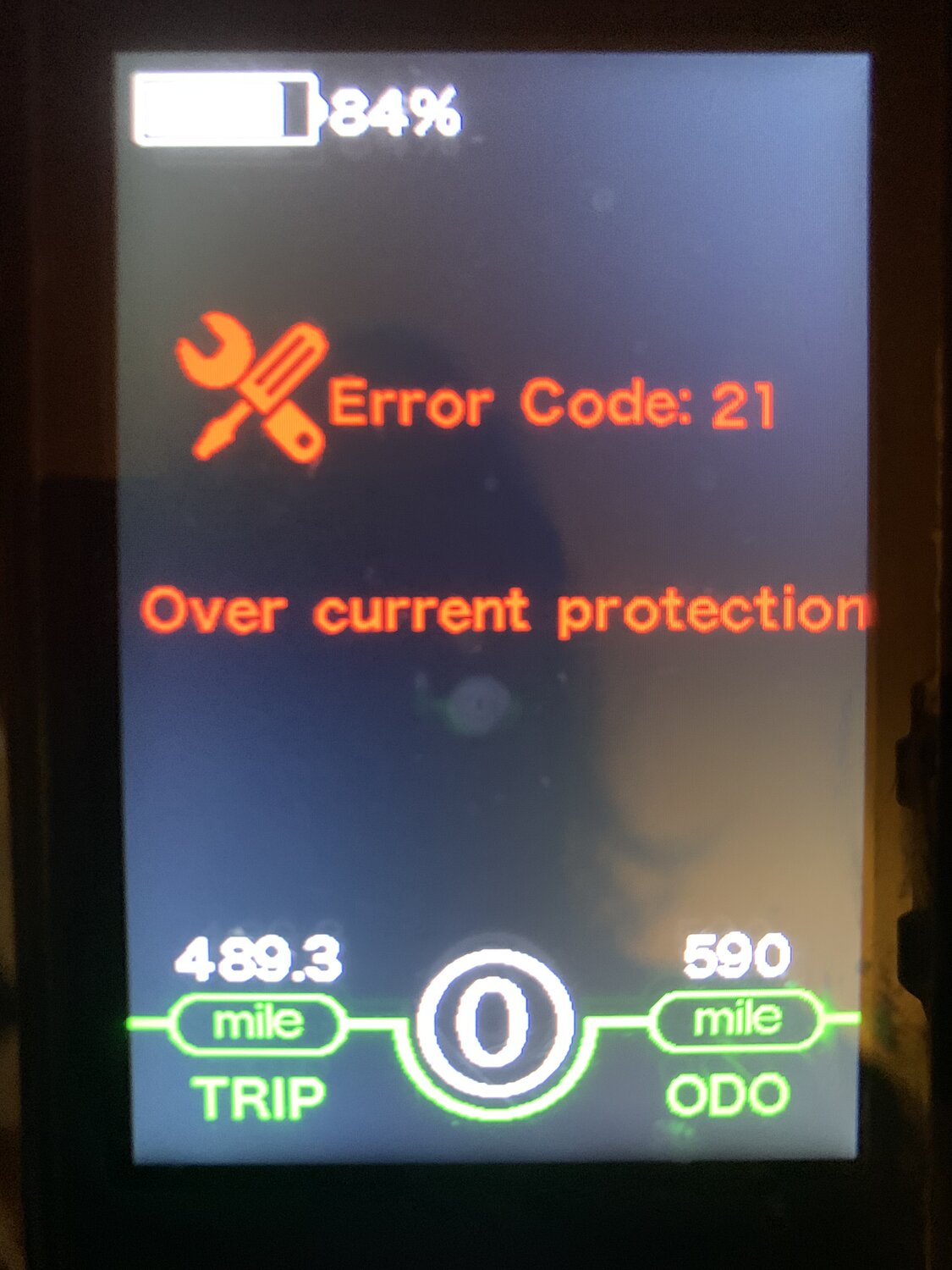

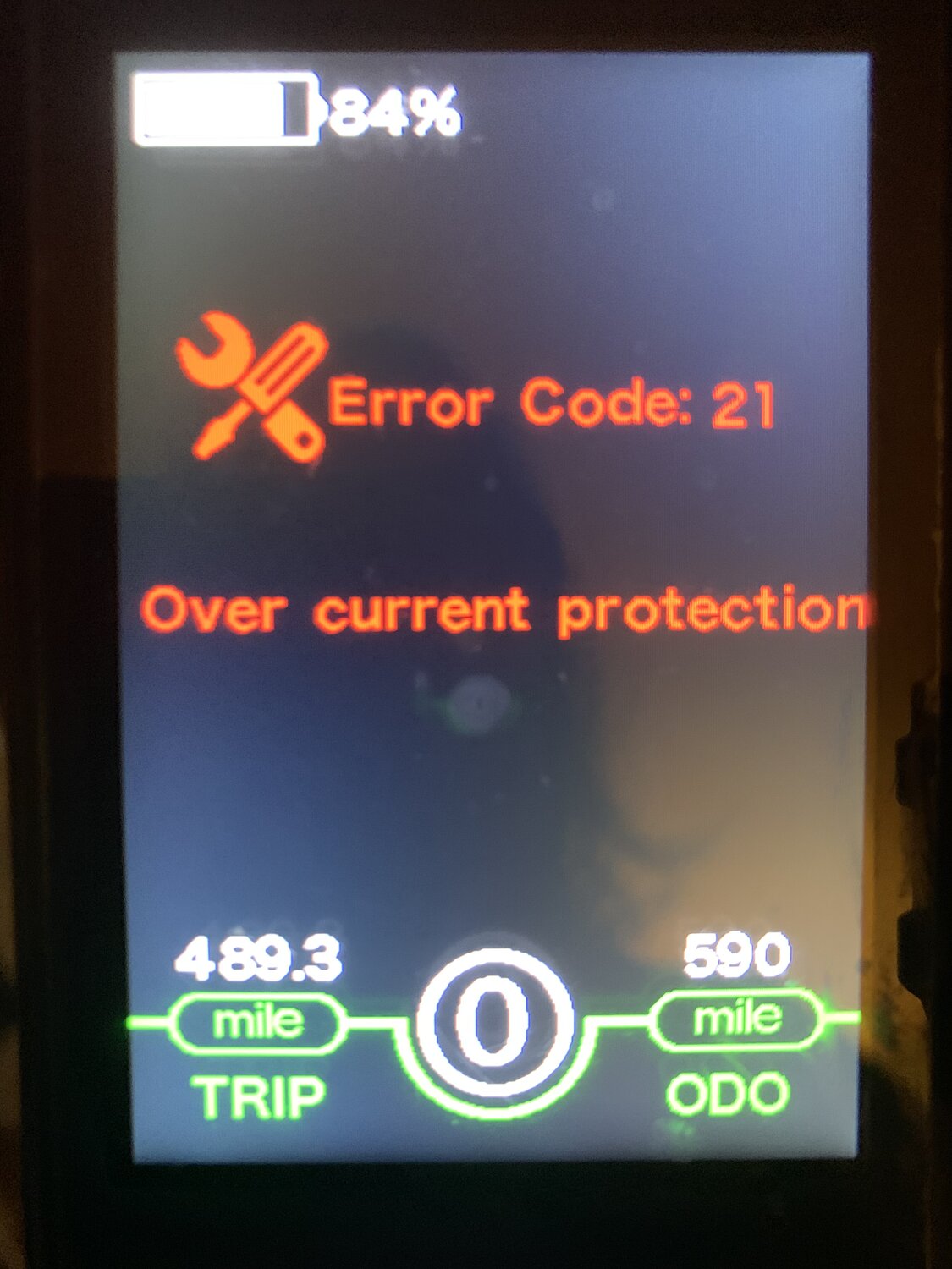

Hey I'm getting "Error Code: 21" "Over current protection". I've had this Eahora X7 500W bike now just over a year, with a few other problems I've managed to solve. Earlier I got a different one, E24: "Fault with motor hall sensor inside". That turned out to be just a loose connection to the motor, on a cable just inside the chainstay. This E21 though has me stumped. I've tried changing Current Limit setting to min and max, and Factory Restored all settings. Tried disconnecting/ reconnecting the battery, unplugging & reseating the connector to the display. Yet E21 persists, and it disables all motor function. Anyone know if I need a new display/control unit?

E21 refers to current abnormality, please turn off the bike when it occurs. Then unload the battery from the bike. Wait for a few minutes, re-install the battery and turn on the display, the error code will disappear in general.
If the steps above can’t solve the problem, then the controller needs to be replaced. On this occasion, please send us a picture of the error code. Please contact at [email protected]. We'll help you figure it out.
