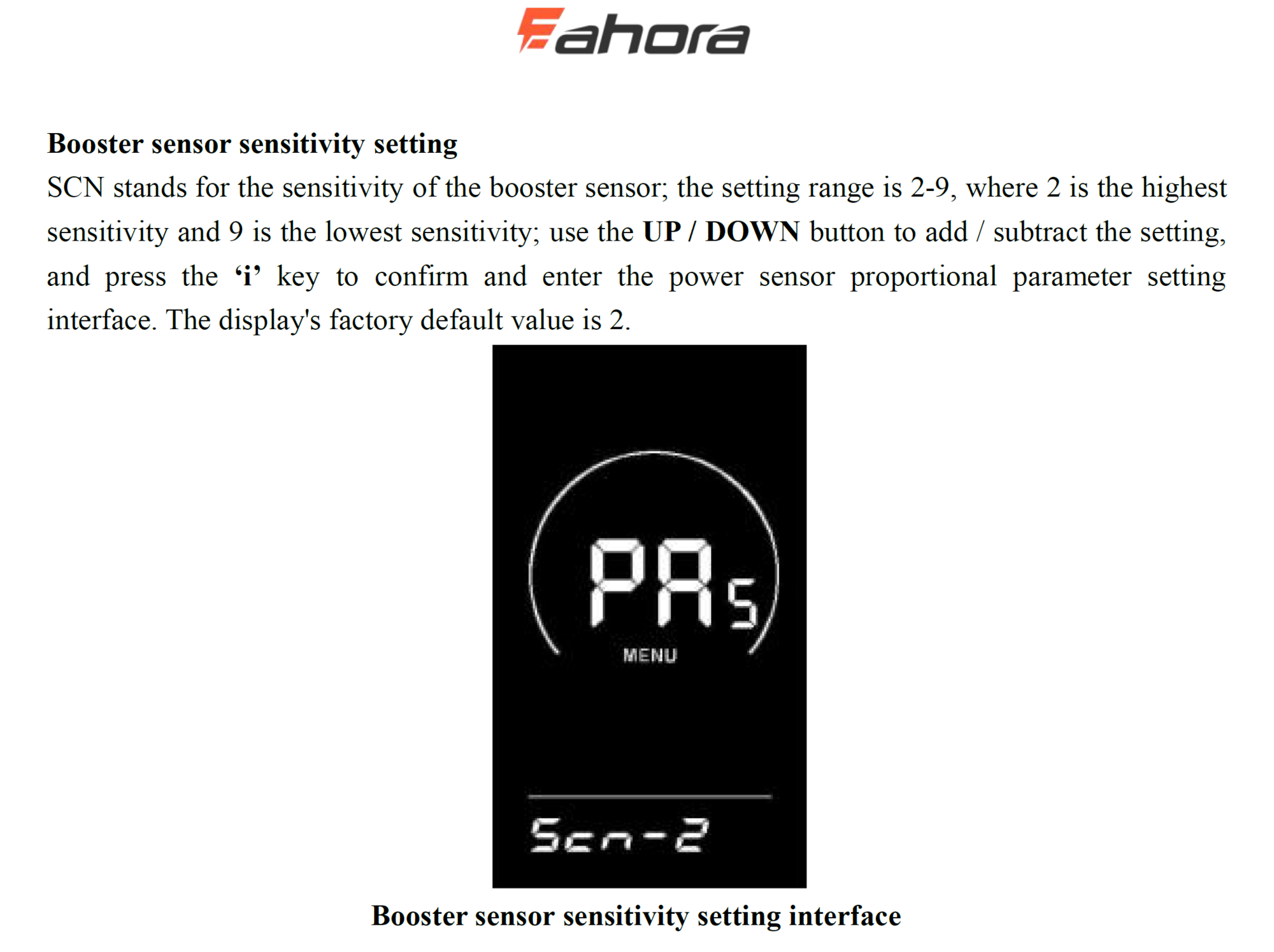

ZZRider,
Thanks for your comments. I do appreciate the way you can customize the settings on the eAhora bikes. From reading several comments in this forum, it appears that there are not a lot of e-bikes that allow the user to program the controls. But it is a shame that they don't promote and support this feature. I think it would be a great selling point. Tech support did not advise me that it could help with my issue and their manual discourages users from making adjustments to those settings. From the manual: "Ensure you do not change Personalization settings. Changing Personalization settings may cause your bike to stop working properly." I would think that the majority of users would be intimidated by that warning and not bother to pursue it.
As it turns out, the surging I was experiencing is not "normal". It was caused by the fact that the factory setting for the power boost on Level 1 was set at 56%. Default is supposed to be 50%. I have now set it at 40% and it virtually eliminates the surge problem at low speeds.
And thanks for suggesting using the "+" and "-" buttons more aggressively. I have paddle shifters on my EV that allow me to adjust the battery regeneration level on the fly. I use those whenever I can and rarely need to use the brake pedal unless coming to a full stop. So it is a technique that I should be able to learn with a little practice.

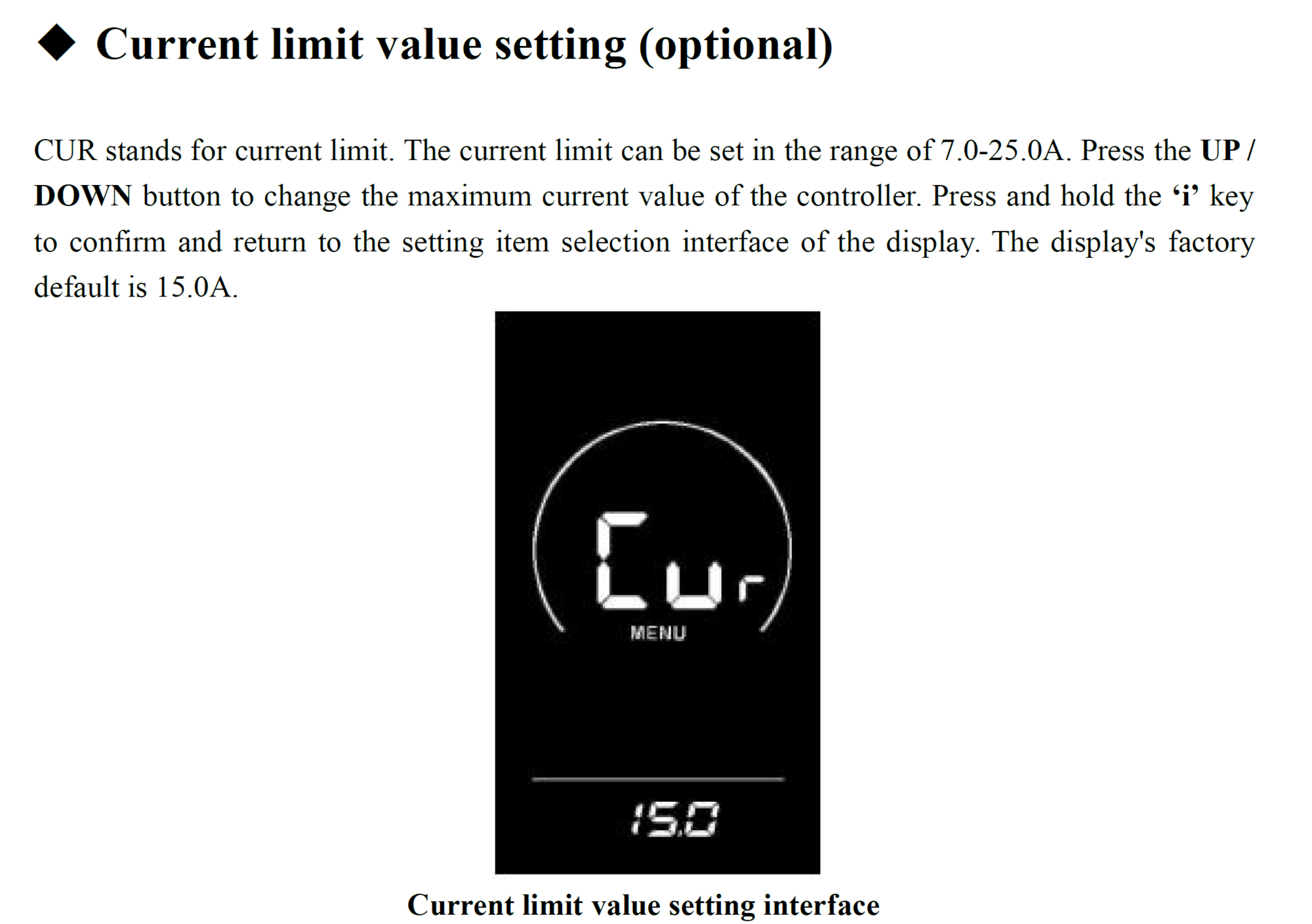

Two last questions: Do you or anyone else know what the CUR (Current Limit Value) is all about? Default is 15, but can be raised to 25. I wonder if that would raise the max speed? And what about SCN (Booster Sensitivity Setting). What does that do?

View attachment 61284View attachment 61285
Yes, some of the listed defaults in the manual may not match your particular eAhora ebike. I had the same thing with the "LS" setting. And I was wondering about the Cur setting as well, which led me to this website that has lots of good info on voltages, wattage, and torque:
That booster setting could be the amount of current supplied when PAS-x kicks in...just a guess. But there is also a setting for the magnetic disk reading also, which may go hand-in-hand. So many options to learn!
On what should be a simple setting, the display backlight one, the manual states there are 3 levels of brightness. I like to run my headlight even during the day for more visibility to oncoming riders, and it auto-dims the display when you turn it on, so to compensate, I want to raise the brightness of the display, but the manual has a disclaimer:
"Regarding the background parameter setting of the display instrument, please do not change
it at will, otherwise normal riding cannot be guaranteed."
