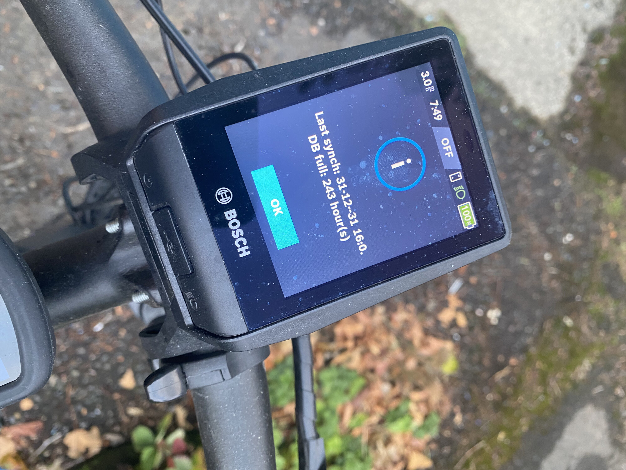

I get this message on my nyon every time I ride. the date makes no sense and it syncs my rides every day so why is it full? how or can I clear it?

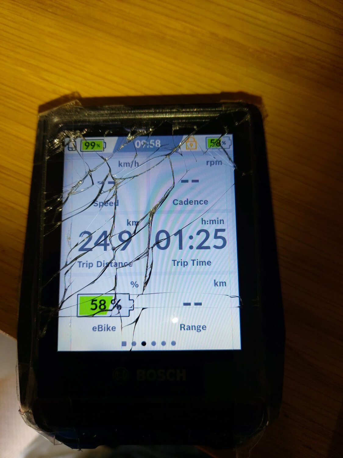

Nyon BU350 screen replacement. The screen of my Nyon is extensively cracked following a slow speed "incident". Despite all the cracks it remains fully functional even although the glass would come completely out of the housing if not retained by tape. No longer weatherproof so not a desirable situation. Does anybody have experience with replacing the screen?? and if so is there a specific part number??

In terms of replacing the shattered screen on my Nyon BUI350 all the responses I have from Bosch are indicating there is no repair option or replacement parts available. You would expect that any company wishing to maintain its reputation would at least have an exchange program in place so that if repair is not an option there was at least a changeover policy to supply a replacement at somewhat less than full retail price. To have to pay for a full price replacement because Bosch will not stock parts does leave a very bad taste . The short term solution for me will be to install a gorilla glass screen protector improve the weather proofing.
If you have had a similar experience or perhaps a more postive experience with a supplier for a screen replacement please let us all know.
bosch for the most part is plug and play not repair. though its pretty cracked you may be able to cover it with a screen protector. I did that on my garmin.
Yes, as noted in my post that is my plan. The most frustrating part is that to restore to good working order I have to pay $500-$600 AUD to replace the screen by buying a totally new unit. Perhaps Bosch could consider a service option where if you returned the old unit replacement direct to them there it could be repaired/replaced at something less than full retail price. Much better for brand reputation.
