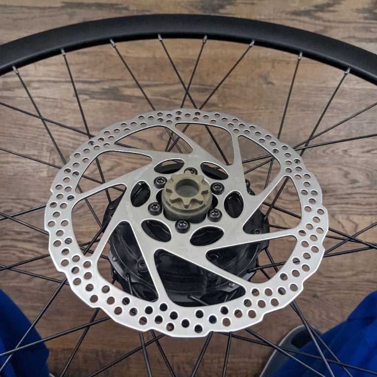

Sorry guys, I was expecting to do a wheel swap previous weekend, but last Friday on my morning commute motor on my C380+ start making weird sounds, so I dropped the bike to the Propel for diagnostics and few days later they reported that motor was faulty and they are waiting for the new one from Bosch for replacement... Just 800+ miles in 4 month and already dead motor, hopefully I just was not lucky to get a bad one and this is not a systematic problem. So, if I get bike back sometimes next week, I may do a swap sometimes following week.

  1. How did you decide the spoke tension of 1300Nm?
    Was that what you measured on the old wheel, the max you could do, recommended by Kindernay...?
  2. What Torque did you use on the wheel axle?
    Someone mentioned that if too tight, the shifter does not work, what was your experience and value used?
