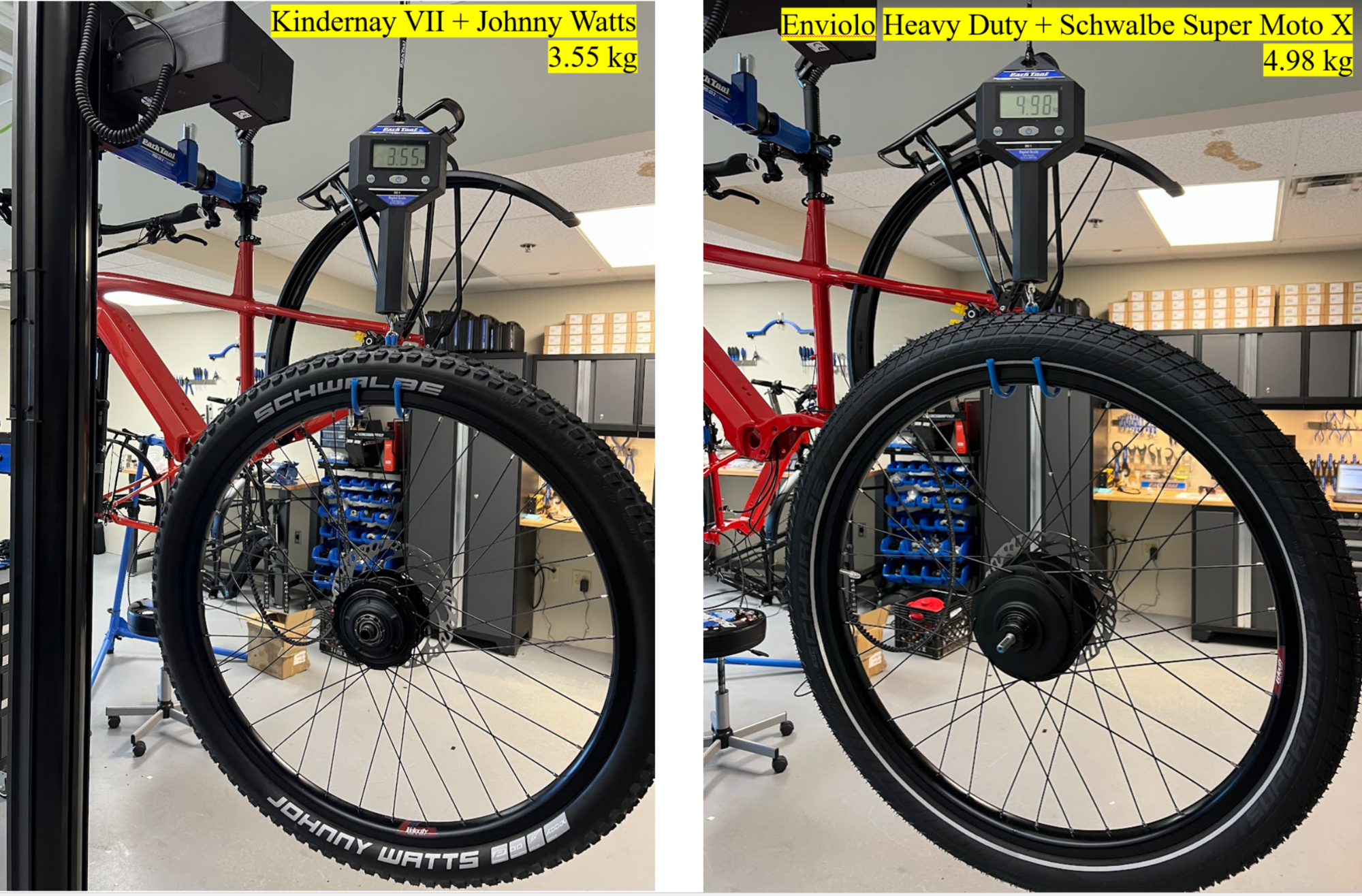

One of our customers upgraded from Enviolo Heavy Duty to Kindernay VII IGH. In the process, we also upgraded the tire from Schwalbe Super Moto-X to Schwalbe Johnny Watts.
We noticed some drastic changes in the weight difference and handling.
  • While the Enviolo Heavy Duty IGH is excellent, it weighs a bit and has a 380% gear range.
  • Kindernay VII is by far the lightest IGH that can handle 150+ Nm of torque and has a 428% gear range. As you can see from the picture, it makes a difference.
  • Some of the weight difference is also from the tire itself.
  • Including the front and rear tire change and going with Kindernay VII saved about 4.5lbs of weight. Tire mass is rotational weight, and overall, saving ~4.5lbs made the bike accelerate quicker and a bit more nimble.
  • Advantages of Johnny Watts: better rubber (ADDIX compound), better sidewalls, tread designed for all-round usage, and being a foldable bead, it is possible to go tubeless even though they don't advertise TLE.
    Perfect for trail riding and off-road use without purchasing a different bike.
  • Kindernay is quickly becoming popular with our employees, if it matters anything
As Cycling About wrote, compared to a traditional drivetrain, Kindernay VII offers a whole lot of advantages of low maintainance, belt drive system without a lot of weight penalty.
Now, chains are heavier than belts, and the overall system might be on par.

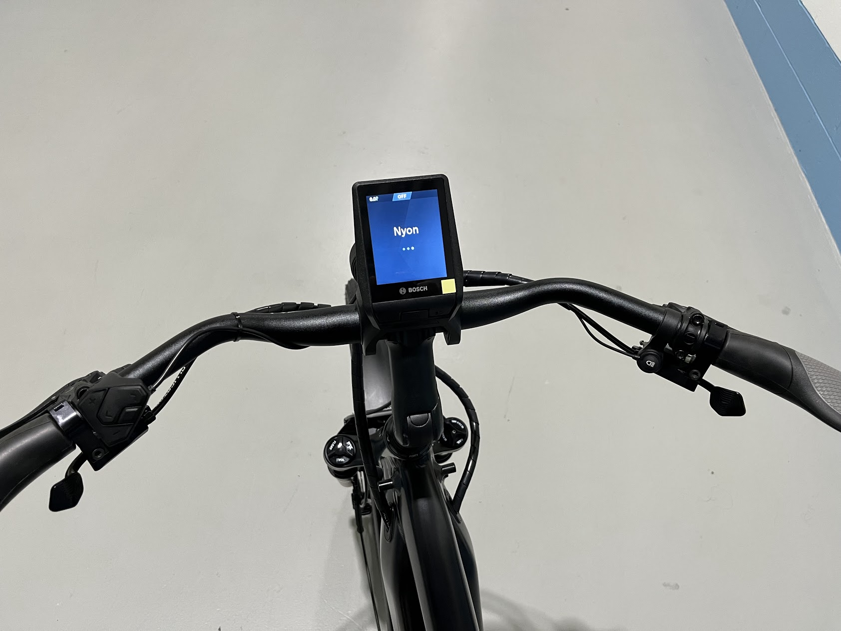

The ride quality, agility rendered by less rotational mass, and the low-maintenance aspect draws serious attention. Many serious riders clock several thousands of miles yearly, and having a robust, low-maintenance bike becomes key.

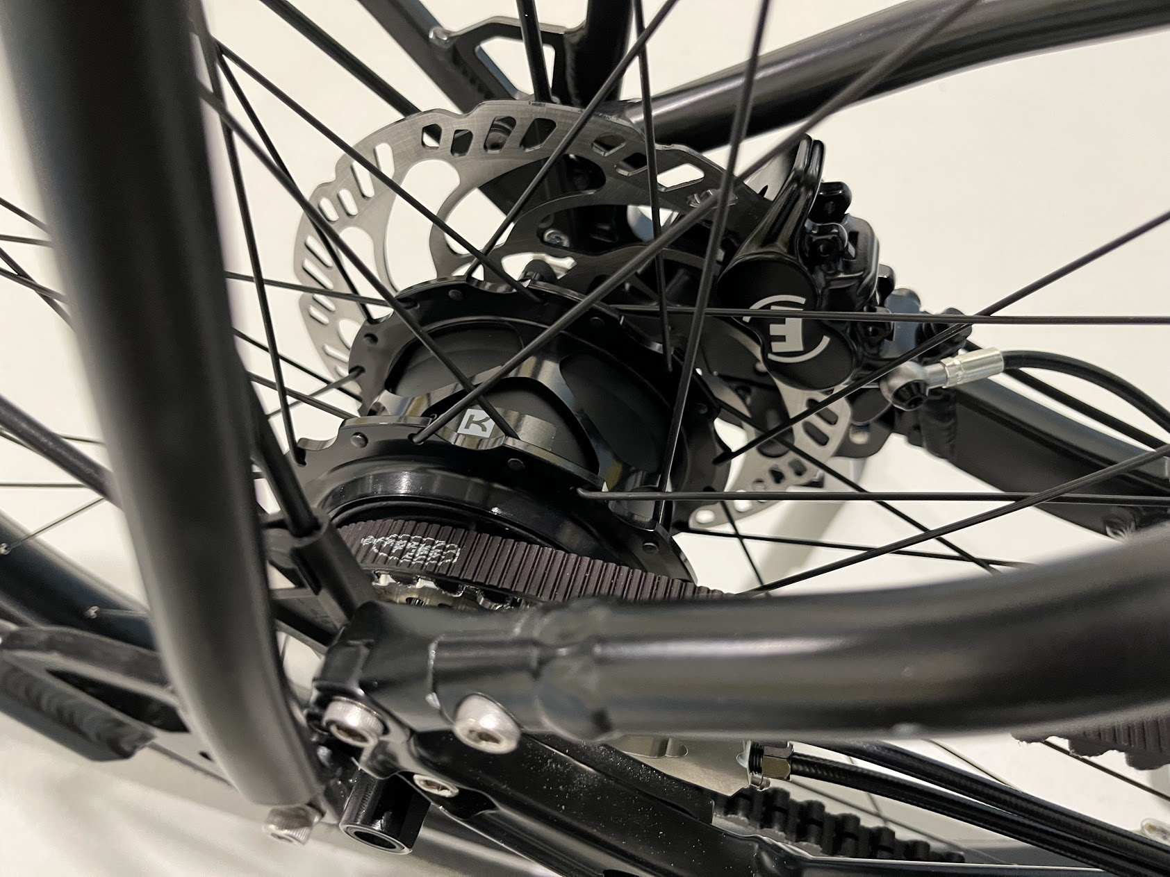

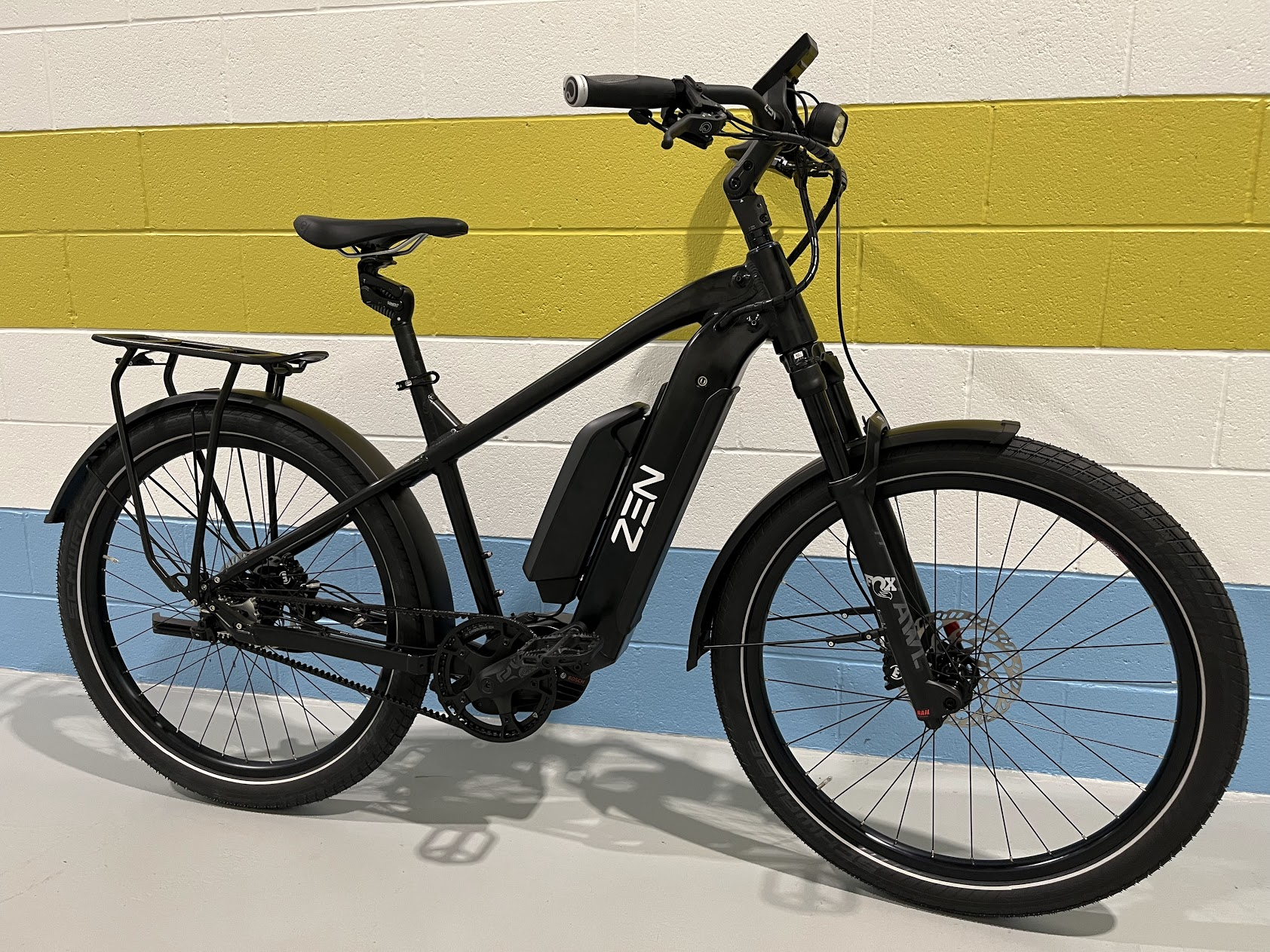

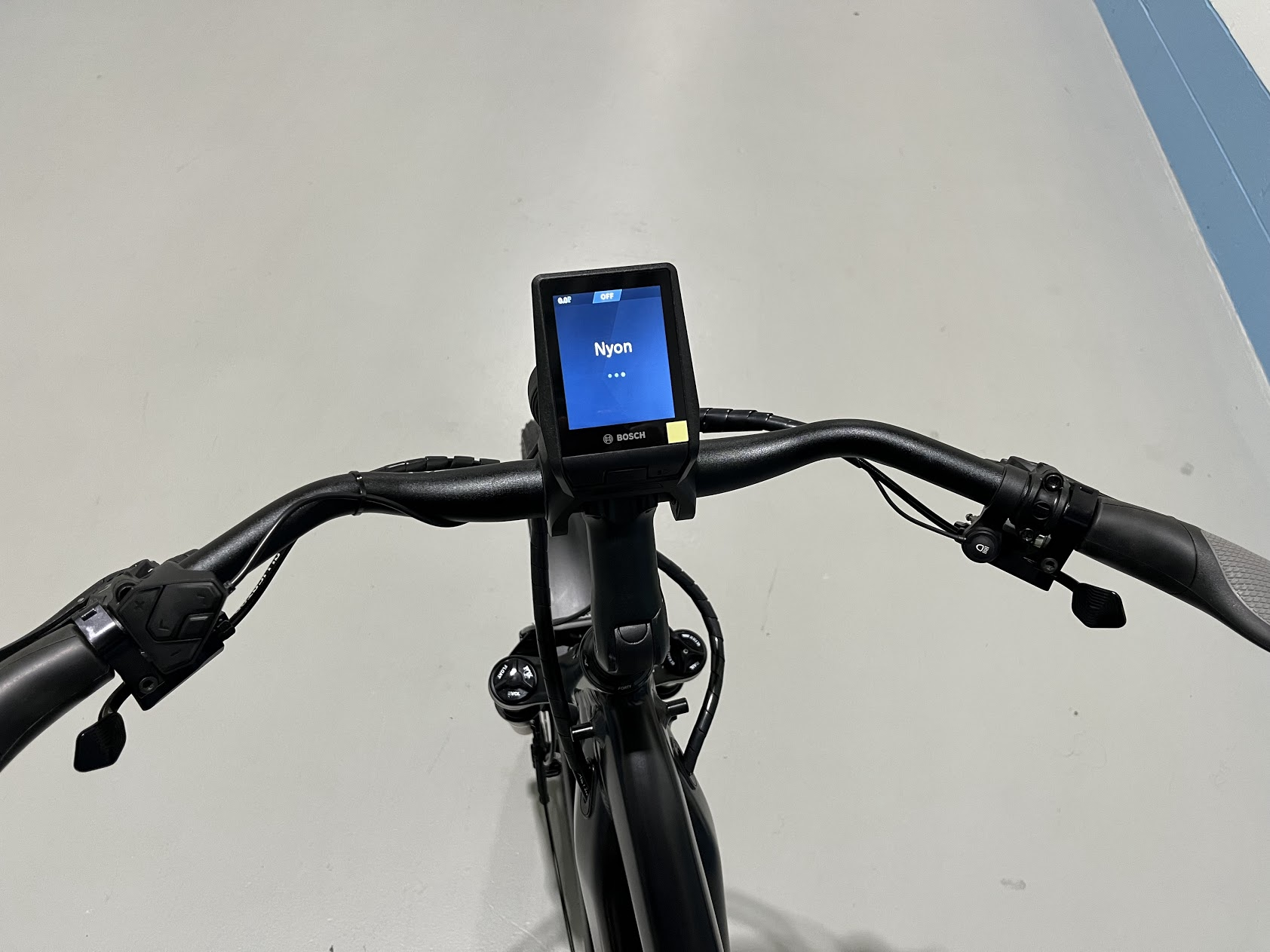

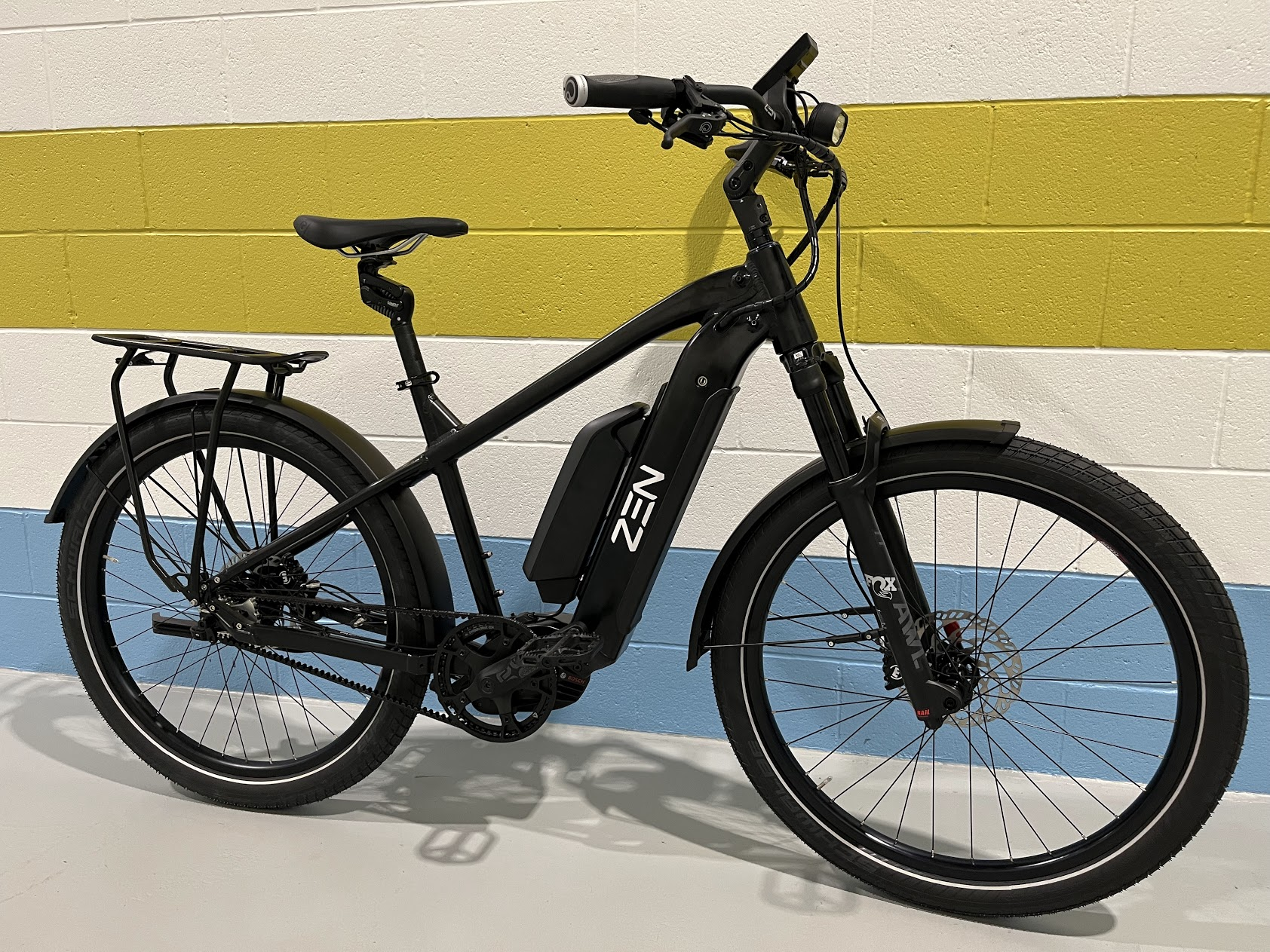

Here are some close-up pictures. If you look at the handlebar, it is super clean. We built this bike for a friend of ours who lives in Freeport, IL

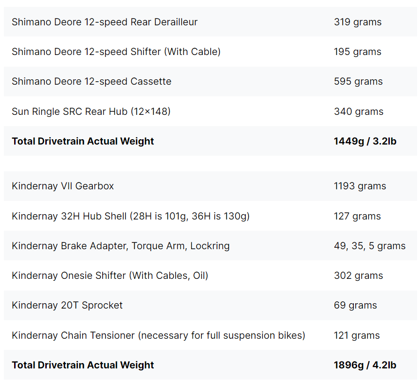

Some interesting tidbit from Cycling About.
Original source mostly focused on pedal bikes but they do have commentary on E-bikes: https://www.cyclingabout.com/kindernay-vii-gearbox-hub/
Kindernay VII and eBikes​
A Specialized Kenevo enduro eBike might be the perfect use case for the Kindernay VII hub.
It’s worth noting that big gear steps work particularly well on eBikes.
This is because electric bikes accelerate much faster than regular bikes, so riders will often find themselves shifting two or more gears at a time. SRAM has recognized this as a problem on eBikes and makes a cassette called the EX1 with 24% average gear steps.
Due to the higher overall bike weights and power assistance, the added weight of a Kindernay hub works out to be less significant on an eBike too.
