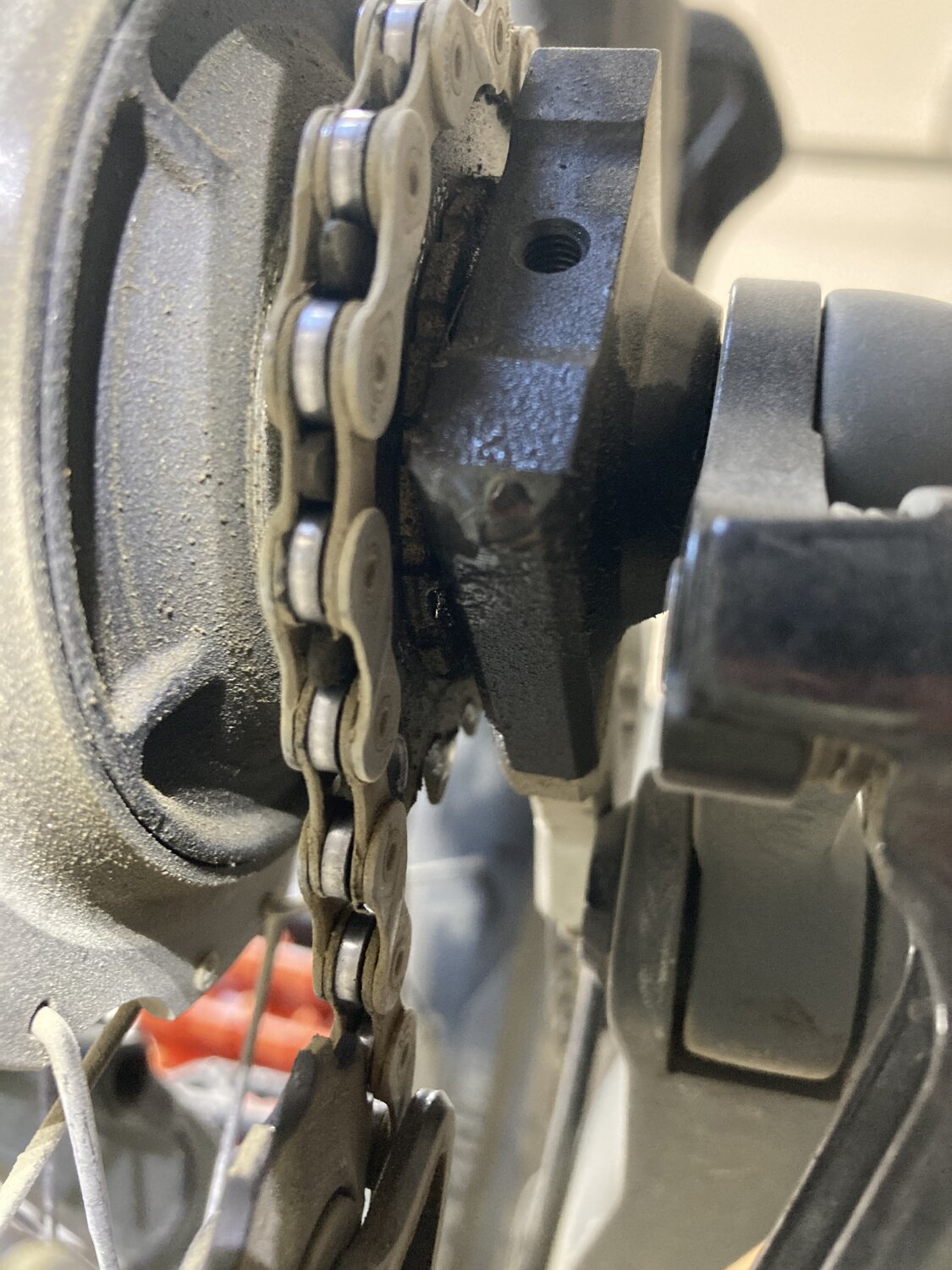

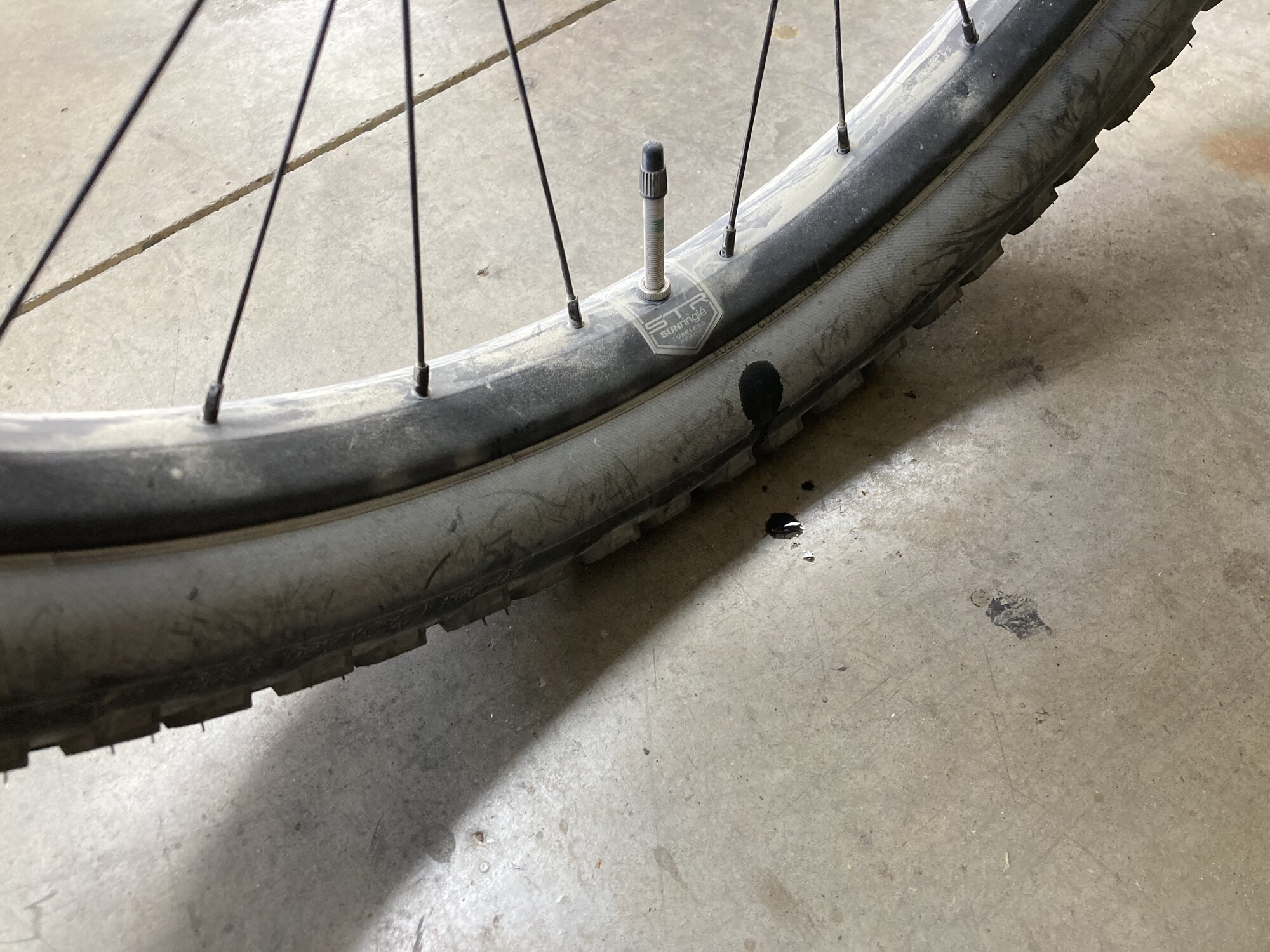

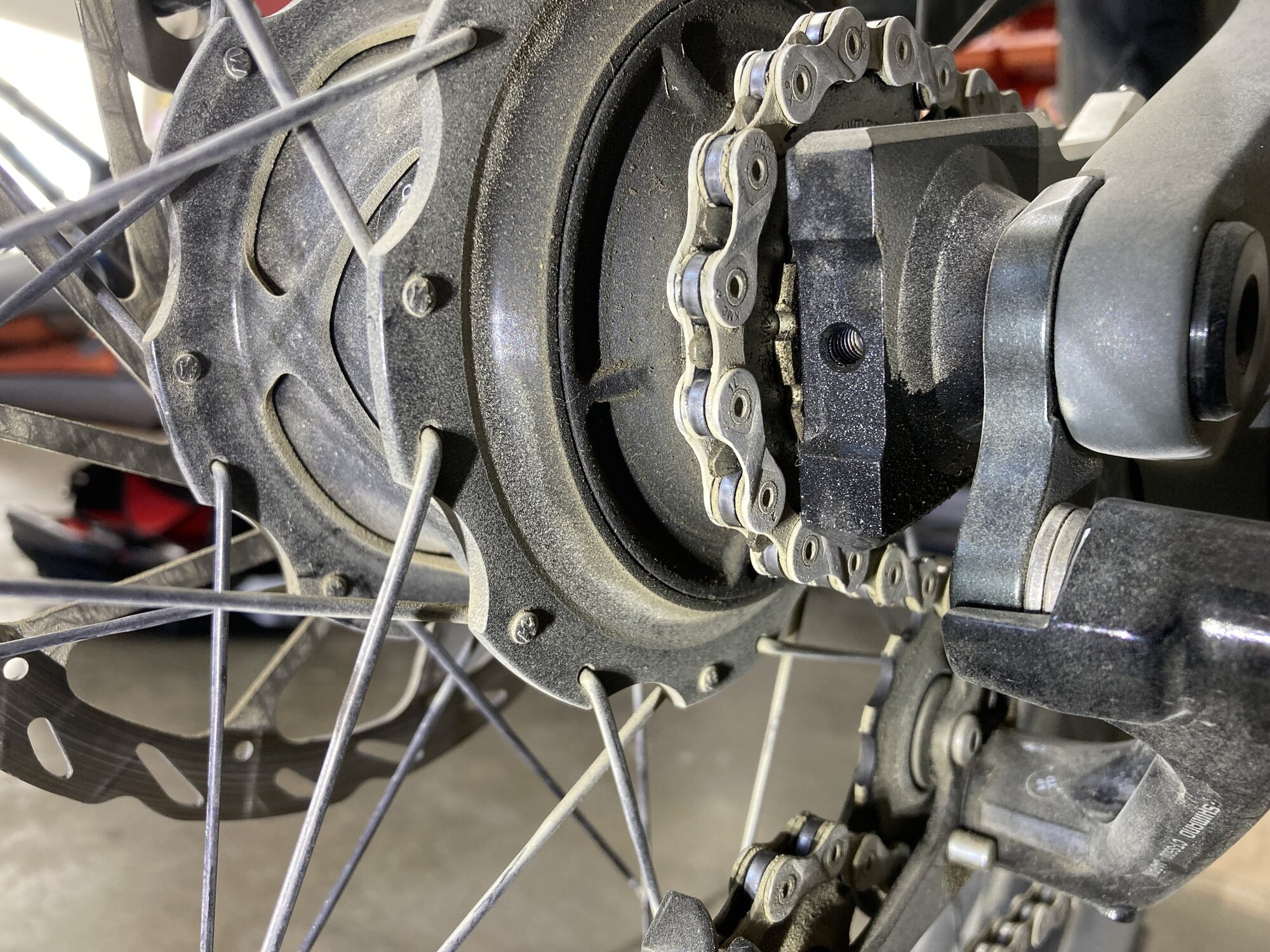

Im pretty sure I found out why I'm having shifting problems. I just found out my hub is leaking fluid. :mad:

On the ride, before I noticed the leak, the hub was reluctant to shift into 7th gear. It got worse during the ride and eventually I wasn't able to shift into 7th gear.
A couple of hours after the ride I checked on the bike and found the leak.
