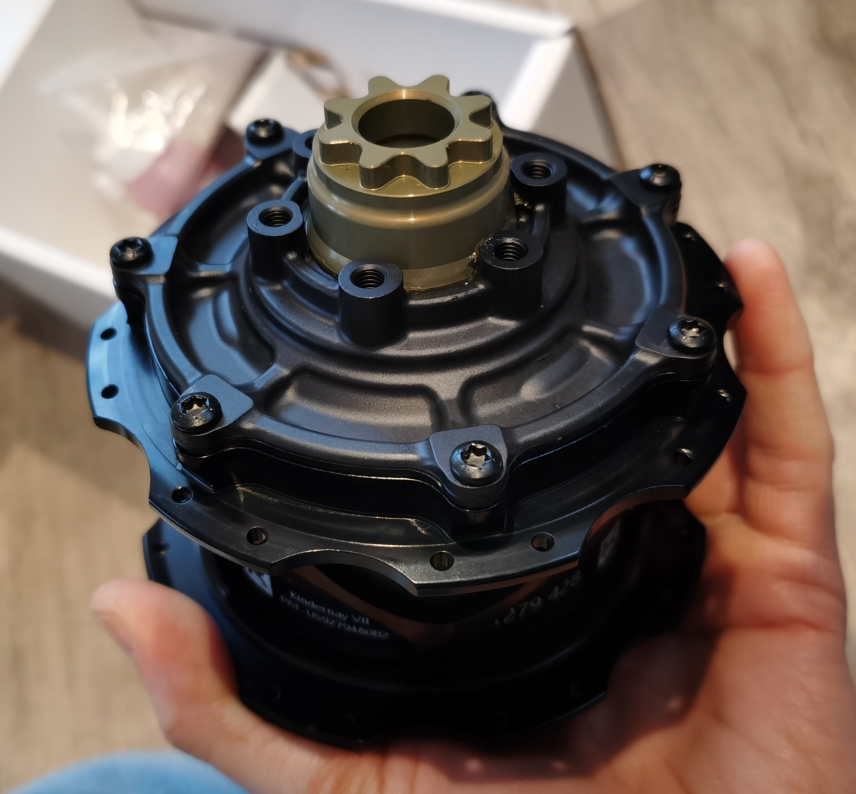

OK, Cycle monkey just responded back. They said they had issues with email rerouting and were not able to see the emails but now figured out the issue. Cycle Monkey has mostly 142mm Kindernay VII kits in stock with onesie shifters, but they also had a 148mm Kindernay VII with twoise shifter. I wanter onesie shifter and it looks like they have spare parts for Kindernay hubs in stock and were able to swap the parts to convert it to 148mm Kindernay VII with onesie shifter. So if you are looking for particular size Kindernay the retailer may be able to swap the parts if the retailer cares the spare parts to convert it to necessary size (TORQUE ARM, MATCH CAP, ACTUATOR HOUSING).
The Kindernay VII from Cycle Monkey is arrived. The Onesie shifter cable length is about 1650mm which is probably OK for external cable routing but it is too short for internal cable routing through the swingarm. It needs to be at least 2500mm long. So I have to discard the existing hoses and attach longer hoses.

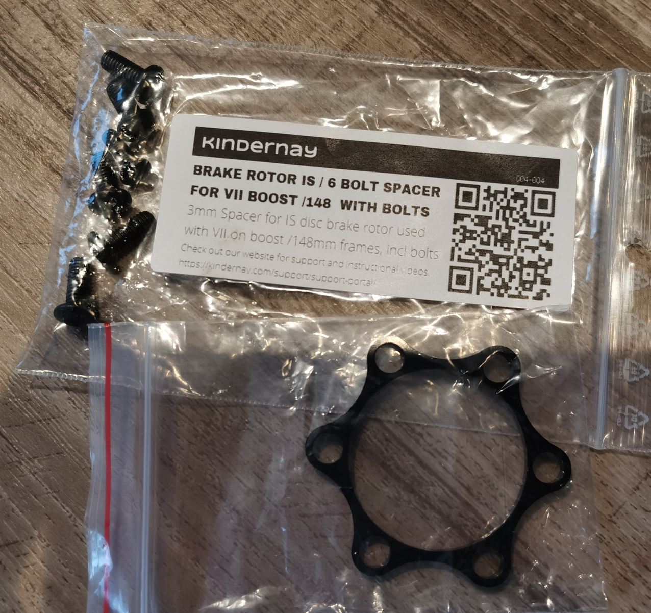

By the way, besides TORQUE ARM, MATCH CAP, ACTUATOR HOUSING parts which configurate the necessary spacing size of Kindernay VII (135X10mm, 142X12mm, 148X12mm) for 148X12mm configuration you also need brake disk spacer and brake disk screws specifically for 148mm

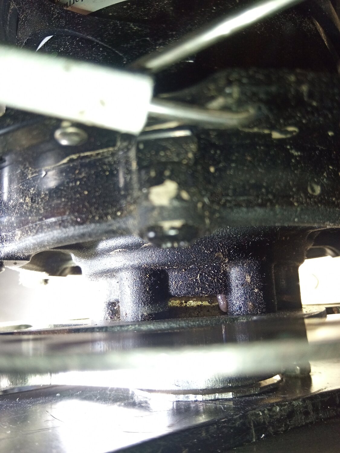

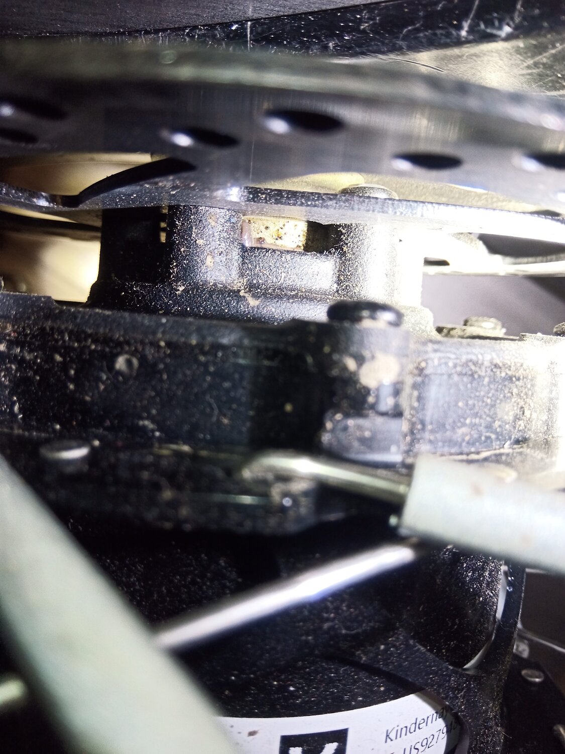

Might this be my velvet oil leaking from the hub? I have been riding it for a week now. what is the correct procedure now? How do I know how much oil is in there? How do I know when to replace? the leak is also on the non-drive side.

Oil leaks is the biggest issue this hub has. That is the reason they originally instructed to put 100ml of oil into hub, but later changed it to 25ml - when you put 100ml there it was leaking a lot. My original hub was getting leaks starting first oil change and sometimes it was really bad (like getting oil puddle after 10 hours without moving). Eventually I lost 5th gear in the hub (after about a year or active riding and 2000+ miles) and got a replacement hub from Kindernay. New one currently has 600+ miles and one oil change on it and is working much better - no leaks so far.
For my old hub main leak point was shifter connection interface on right side - its bottom part was almost always covered with oil. Do you see something like this in your setup?
