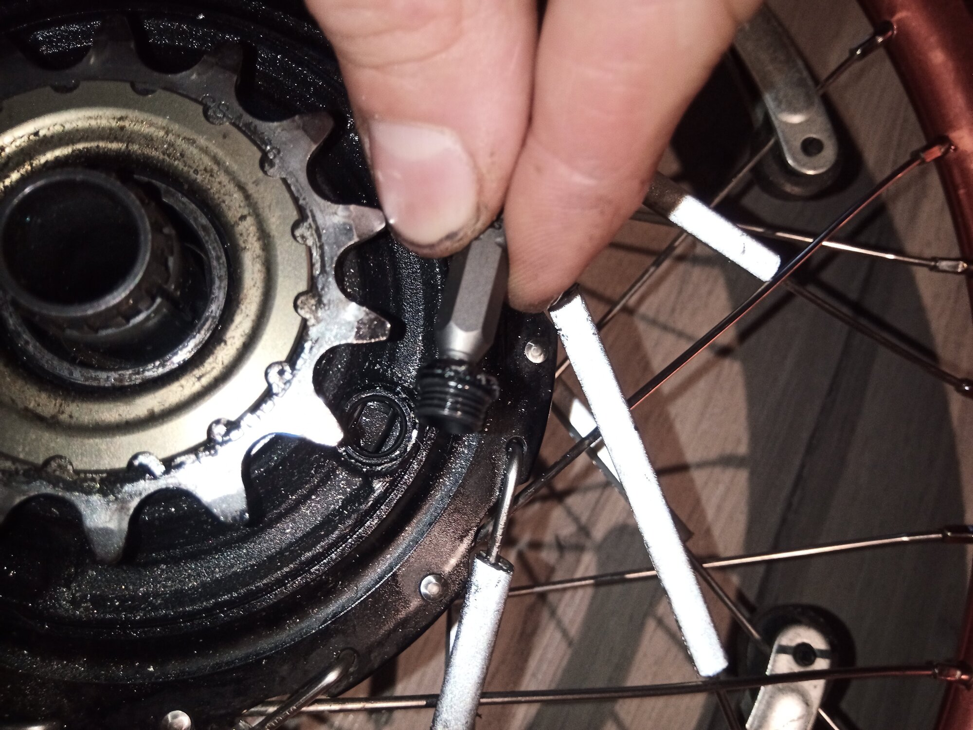

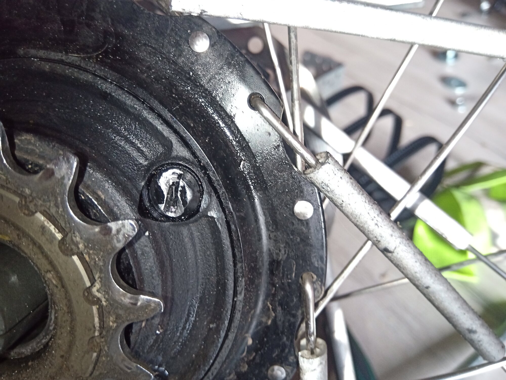

Guys, Im fckd... wanted to change the oil after the ride and the screw didnt come lose, its stuck there and was stripped when I tried to usncrew it, what now? yes, my lock ring and sprocket are still attached, as I am using 14T sprocket, which doesnt interfere with the screw. i screwed the screw in by hand, no extra force. feels like the screw plug is made out of aluminium... it was very brittle

im thinking about using screw extractor, does anyone remember if the oil plug is a solid piece of metal or if it is hollow on the inside?
Hard to say for sure, but I think it is solid. Also they have the version with hex interface, which is much much better than slot one you have.
You might want to tack weld an aluminum rod or tube to the plug to crank it out. You have to file the top of the plug to expose bare aluminum and you have to use microwelding technique to tack weld the rod in multiple spots and not to damage the housing of the gear hub. Then you can crank the plug with the rod.
An alternative way is to drill two small holes and crank it out with a twin hole screwdriver. You have to use the biggest screwdriver possible to reduce the stress on the plug and on the screwdriver. Do not drill holes all way through, just drill them deep enough to engage the screwdriver.
where can I buy that? looking for replacement plug and I can only see this flat interface https://kindernay.com/product/oil-plug-assembly/
had to use a screw extractor, for anyone else that may experience this in the future, yes, the piece is solid and screw extractor did its job. but i ruined the plug
