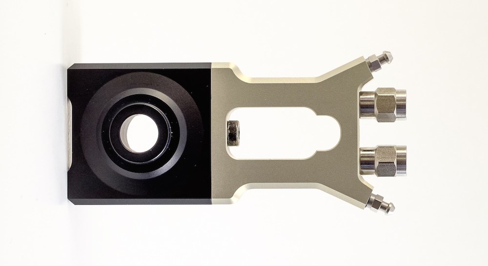

My Kindernay VII is slowly dying (after about 6.6k miles) - seals are not holding oil anymore, everything I am putting it is on the floor withing 2-3 weeks. However it still works, so I plan to use it sill it stops completely. However shifting become more annoying issue: I hardly can shift to 6th gear now (1-4 is fine, 4-5 is acceptable, 5-6 almost impossible, 6-7 if fine if you can get 6th first). I will re-bleed the shifter to see if it help, but I am suspecting it might be some wear - same shifter I used with 1st hub, which broke, so it has around 8.4k miles on it. Does anyone who had Kindernay and not using it anymore, willing to sell me the shifter unit (the one attaching to the hub) - I am willing to pay reasonable price and cover the shipping. Please let me know! Thanks!
I'm also having issues with my part that attaches to the hub. The bike was shifting fine, but over time it would no longer shift to 5 & 6 gears.
I tried bleeding the lines, but ended up with zero gears. I did bleed the lines a year or so ago and was able get all the gears working. Unfortunately, this time it was a no-go.
I took the bike into my local bike shop and had the tech try his luck at bleeding the lines. No luck with him either.
I then tried contacting a guy in Europe who supposedly has parts for the kindernay hubs. I was thinking that the seals in the aluminum part that connects to the hub gear were starting to leak and hI hoped that I could just purchase that end connector. Unfortunately, after a couple of back-and-forth emails he stopped responding to my emails.
Unfortunately, it looks like I'm going to have to bite the bullet and have my local shop replace the kindernay kit with a regular derailleur running gear. I'll probably sell the hub itself, which shifts fine, online.
You can try contacting the guy for parts. You may have better luck than I did. mail@trailcamp
Thanks. This is sad, but at least explains that those symptoms I see are common. I bought some parts from Kindernay when they were still alive for backup, but never bough this one - big mistake :(
Anyway, I will try full service for the shifter tomorrow - if it works, I will have time till spring (hopefully), otherwise I will need to migrate to other hub earlier than I wanted. I am not going to derailleur in any case - I am belt guy and never will use chain again. Aiming for 3x3 hub, which I hope will outlive my current ebike and move to the next one when time comes...
There are still a couple available online on ebay
Yeah, so those. I would actually buy one probably if they would be the proper size, but they are not :( I need 135/10, those are 142/12 and one is 148/10-12. I won't be buying hub as extra for shifter which even in best days cost < $100. I probably missed the window when existing owners/small resellers were cleaning out the shelves.
I'm wondering if the seals inside the actuator on my kit hasn't failed, since I can't even get one gear to work. I wish I could just buy the actuator.
