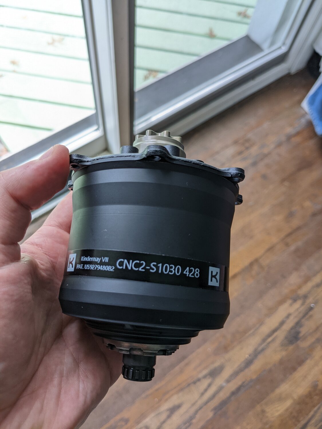

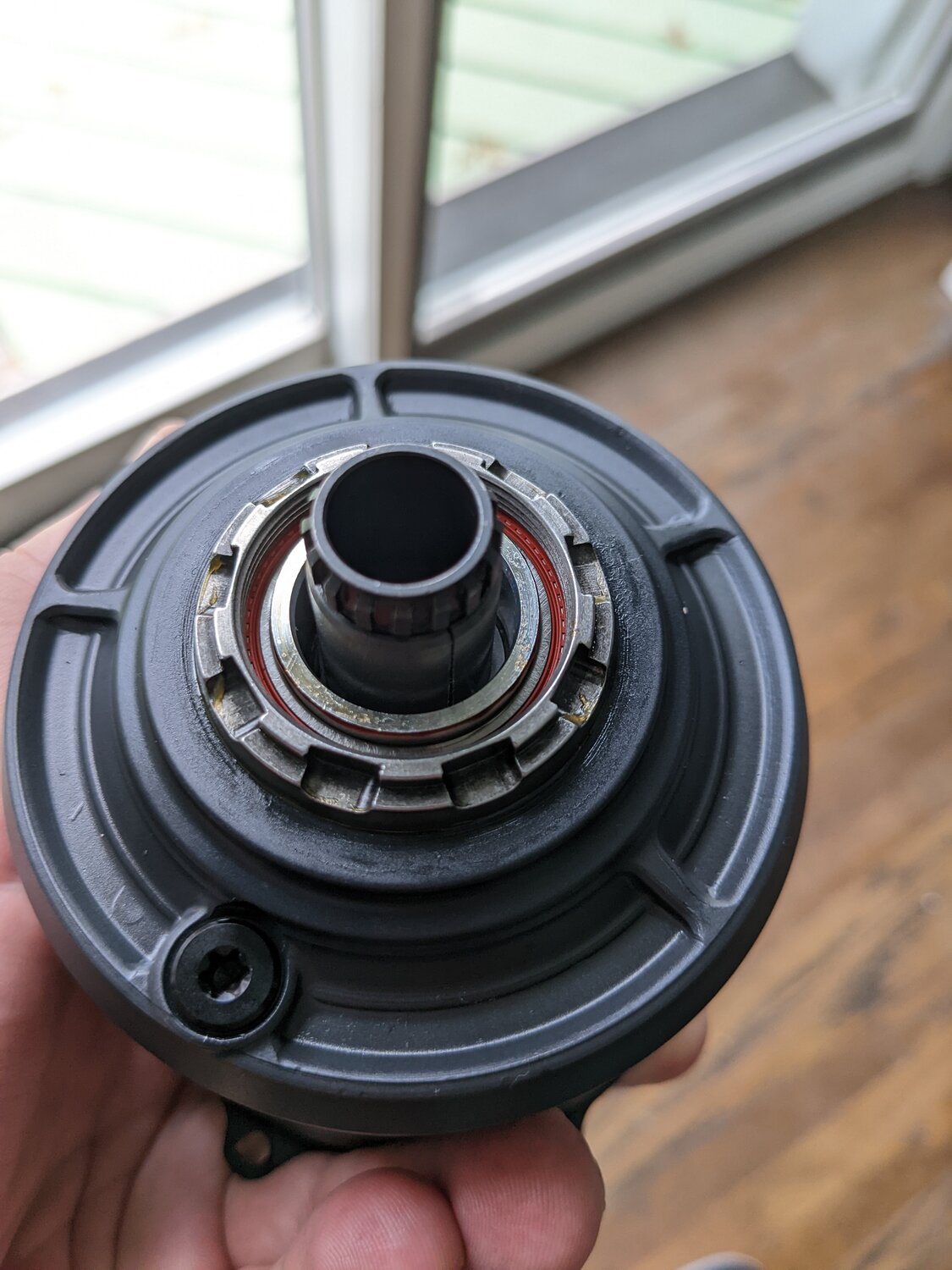

Got the replacement Kindernay VII hub few days back and it looks quite different from the early one I had before (original hub photos are here):
1. The surface is matte now, not glossy.
2. The break disk rotor side manufactured completely different way: old hub was cnc-machined, new is definitely manufactured using casting.
3. The oil screw now uses torx head, not slot.
4. Sprocket fix ring is notched now, not hex, which makes it much easier to work with (hex one required expensive adapter from Kindernay to tighten reliably).
Going to rebuild the wheel now and hope this time I get more luck with this great hub!

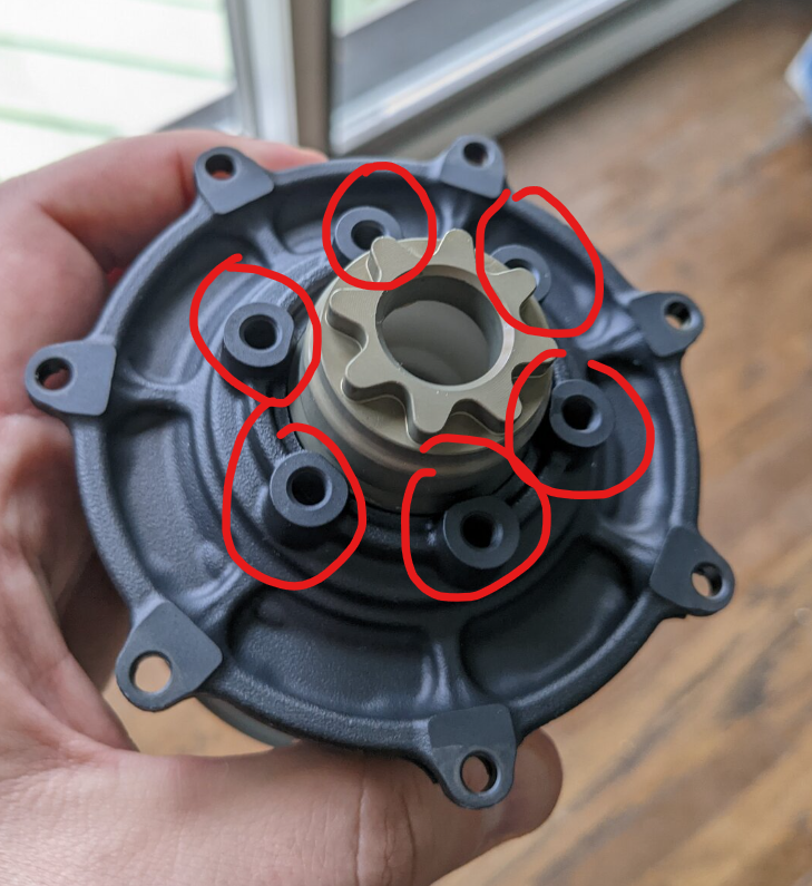

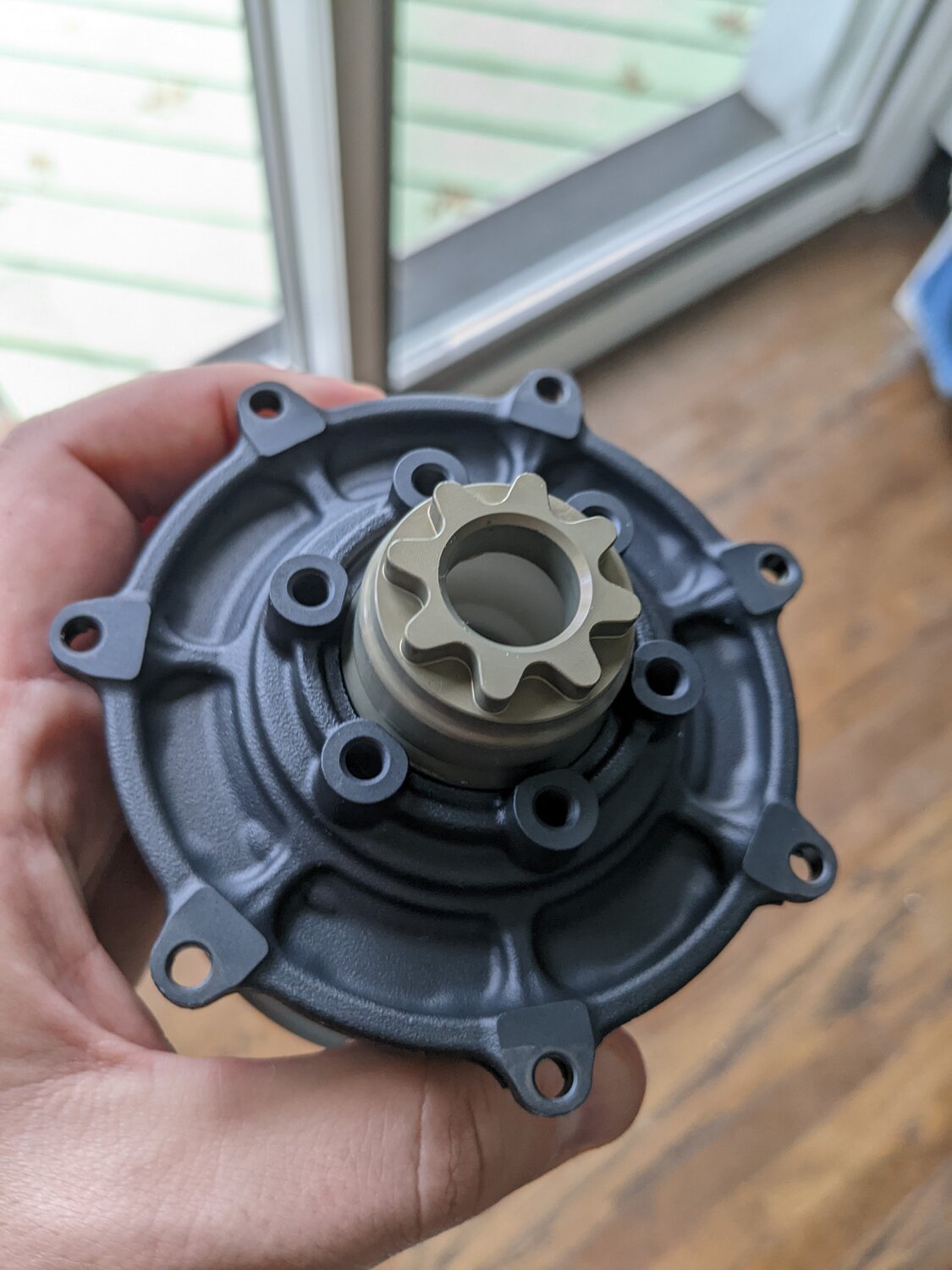

Wow, I did not know this feature exists on Kindernay VII. On my Kindernay XIV I have to purchase expensive proprietary design Kindernay rotors and do not have such premium to put regular brake rotors. The Kindernay brake rotors suck, they are too thin and I bust them faster than regular cheap brake rotors I used before I installed Kindernay XIV. The Kindernay brake rotors also develop inconsistent brake feeling.
Yes! This is another reason I choose VII over XIV (in addition to price and unwanted extra gears for ebike). Standard mount is so much better! Using it with Magura MDR-P 180mm rotors on both wheels and breaks work great!
OK, now I see why I was confused. Originally Kindernay VII did not have 6 bolts interface
There are two versions (6 bolt and 7 bolt) and 3 sizes (135x10, 142x12, or 148x12mm) for Kindernay VII, so you choose what you prefer while ordering. They offer both from the beginning, since original hub I had was pre-ordered in September 2020, months before they start shipping them.
