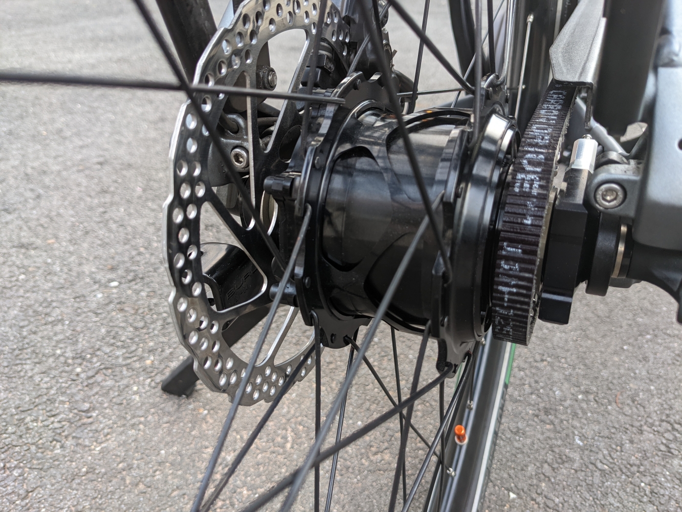

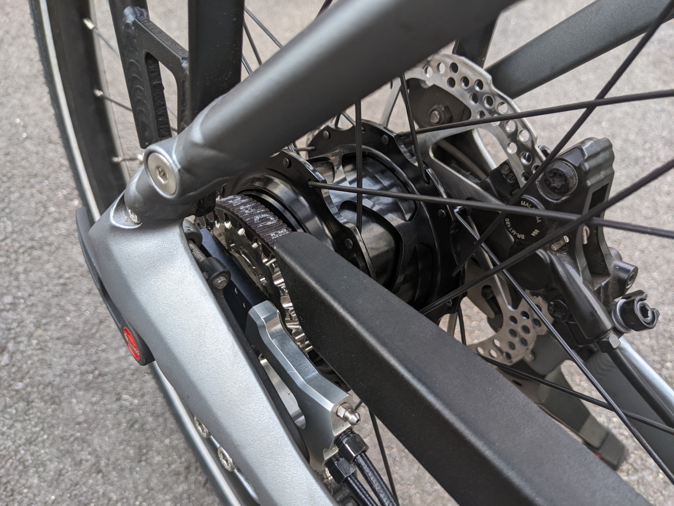

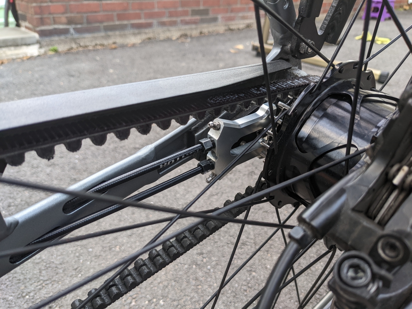

Did proper cable job today and finalize the setup - Enviolo is officially gone today and Kindernay is on duty!
Two things I had to do after first ride this week (~11 miles): tighten the spokes and replace the screws which mount hub to the cage - not sure what went wrong on first tide, but I lost 4 of 7... Put blue locker this time and tighten them properly - should stay there now I hope.

My K14 oil was pretty gunked up and glittering all over at 150 miles. I'm going to change it again at 300 or so.
The drain plug has very brittle metal and the shoulders are easy to chip using a standard screwdriver blade and it turning sideways in the slot before contacting the shoulders. I took an older screwdriver and ground the tip back till it got wide enough to be a correct fit.
Holy crap :)
Yep, blue loctite is an absolute must and a requirement of the install.
Torque at 3Nm, but do 3 or four passes at that value to fully absorb the screws' tension
