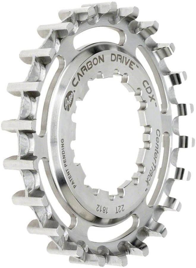

Thanks, I actually did this, but in most US stores I see same oneGates Carbon Drive CDX CenterTrack Rear Sprocket 22 tooth 9-spline, which is a bit different from what I saw on bike-components.de. Also, Gates doesn't make it easier by not putting the proper reference on the (some?) sprockets and using some 4 digit code instead, which I wish I could match with the reference number itself.
The one they confirm the compatibility with is CT1122HMNS with code 5115 and one on sale in US is 1812. Any idea how to map this number to the part reference id? Will try to confirm the compatibility with 1812, but overall I would probably pay more for the part from bike-components.de since I will know exactly what I am getting and price difference is not that huge...
Kindernay confirmed the compatibility with Gates Carbon Drive CDX CenterTrack Rear Sprocket 22 tooth 9-spline from the post above, so I ordered one from 365 cycles store - around ~$80 and should arrive next week. Now if only Kindernay ship the hub in coming weeks...

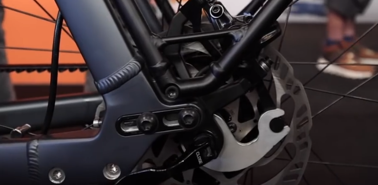

Is this new torque arm design for Kindernay VII (he mentioned several designs for the torque arm there)? From this video (around 13:45)
Great find, thank you for that, the video has great close up of the new torque arm assembly, this is just the info I was looking for :)

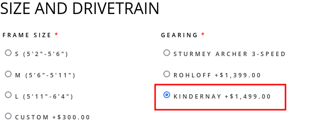

You will need to know the rear hub spacing to order the correct part for your bike. Do you own "Ultimate Commuter Pro"? Which rear hub do you have? It will be compatible for sure - they even offer the Kindernay option on the web site.
He has the Kindernay on his bike already. He just doesn't know the specs of his hub and is wondering if he'll have trouble finding replacements if his is the one being discontinued.
@opimax I suggest you contact WW to get said specs.
I don't think there is something to worry about. UC Pro is not a far bike, so whatever he has installed on it will be fine. @opimax you can always confirm with WW and Kindernay if you have any concerns.
