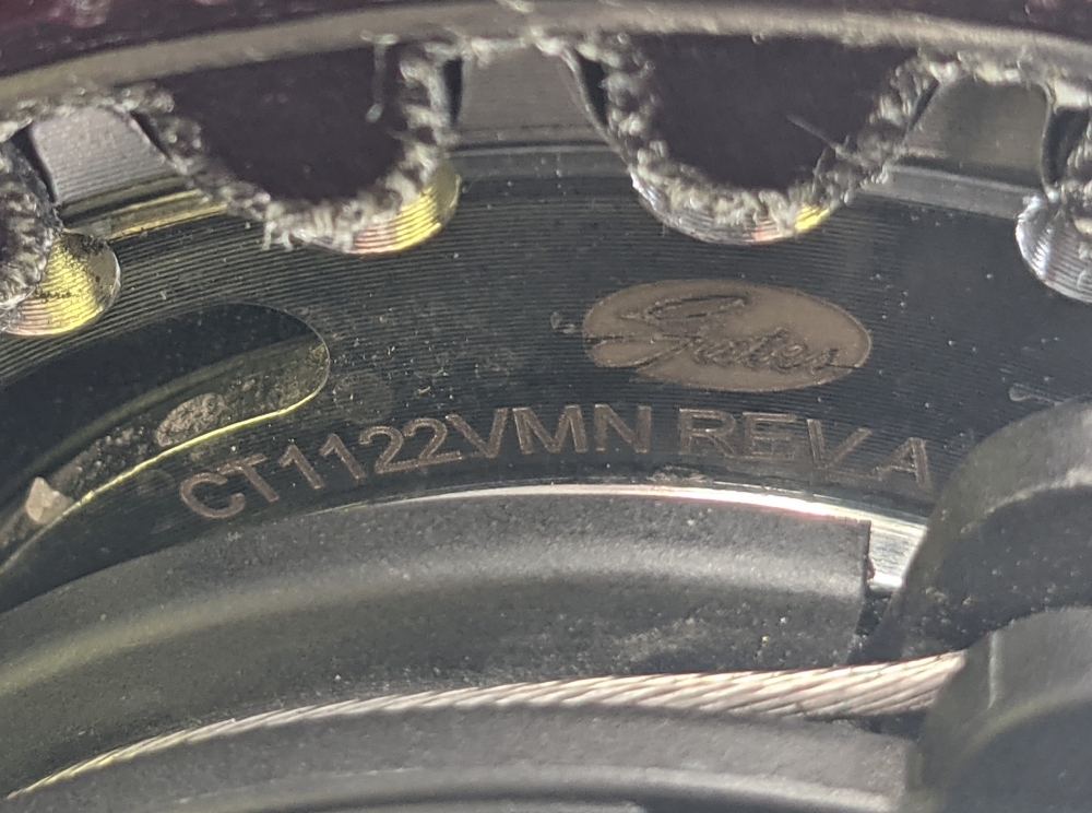

Do you know which rear sprocket the Enviolo is using.
The table below from them shows they have two different sprocket and belt lines.
One has the same 45.5mm Kindernay is using, so that would be perfect
But the other is 48.7mm, which would mean you would need to check if the front sprocket belt line could be reduced by ideally 3mm.
I could never find what is the acceptable offset between front and rear the Gates belt can handle, but the straighter, the less wear for sure.
One last question, the Enviolo is not a thru Axle, so can the frame rear dropout accommodate the Kindernay Thru Axle?
My bike has CT1122VMN REV A (which is logical, since this is the only option for 135mm real spacing), so Kindernay should be fine here. BTW, thanks for sharing this page - I will be able to pick the proper sprocket for Kindernay using provided values.

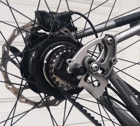

Should be possible. The frame has a mount for the sliding dropouts and I probably need to find thru-axle compatible - hopefully this is doable.
P.S. Looks like it doesn't really need new dropouts - I see just some skewer used with XIV model here without using true thru-axle dropouts.

Re reading it more closely, the difference of Belt lines for Enviolo depends on the dropout version
If you have a 135mm dropout, than it looks like the Belt line is the same 45.5mm, the 48.7mm is for 148mm dropout.
For the Axle, you need to get 12mm wide opening. From the Video, it seems even a slit dropout can work once the bolt is tight.
I would ask ask Kindernay's opinion on that...
Actually, 10mm since 135 uses 10mm, while 142 and 147 are 12mm (unless I am wrong with what 10 and 12 means for spacing). And enviolo-specific dropouts are already 10mm, so should be no issues here as well.

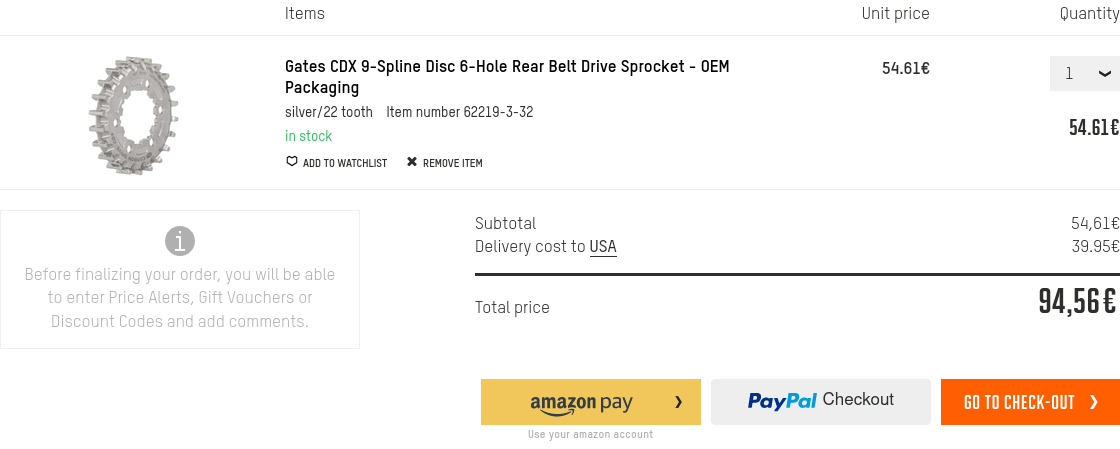

bike-components.de has them both in stock, but shipping cost to US is hard to swallow (especially for such a small part!) Any other places to order the Gates parts in US?
