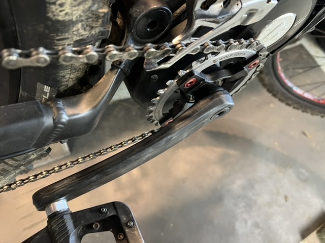

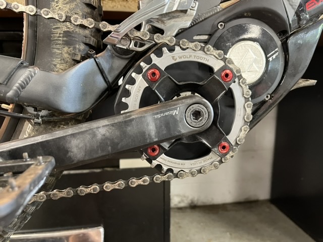

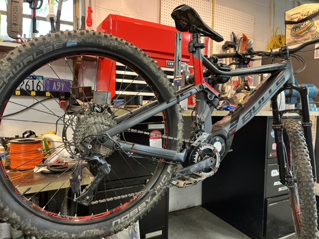

Converted to a 1x yesterday and today. Too much congestion with the front DR. Plus I’ve loaned the bike for some very short rides and the riders can’t seem to understand the concept of cross-chaining. But the real reason was for simplicity because I don’t really need the granny gear. I went with a Wolf Tooth narrow/wide DropStop 32T chainring. Seems nice. In these photos the front DR has not yet been removed and the chain has not yet been degreased and cleaned (now done).

1x conversion now complete. Really cleans up the controls, eliminates uncertainty as to gear selection, etc. Chain line is a-ok. Wolf Tooth suggested no need for a chain guard due to the clutched DR and it pedals great.
