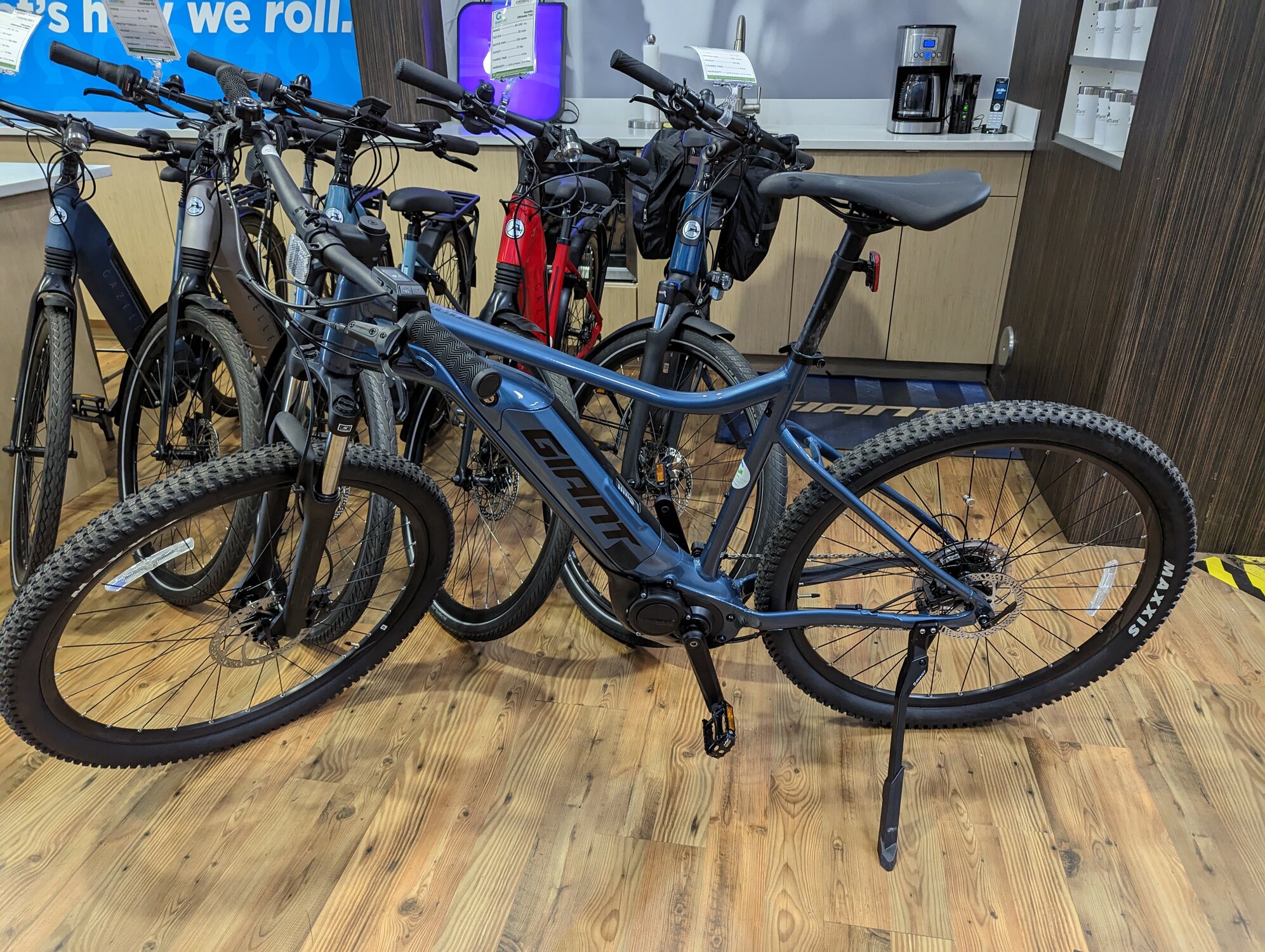

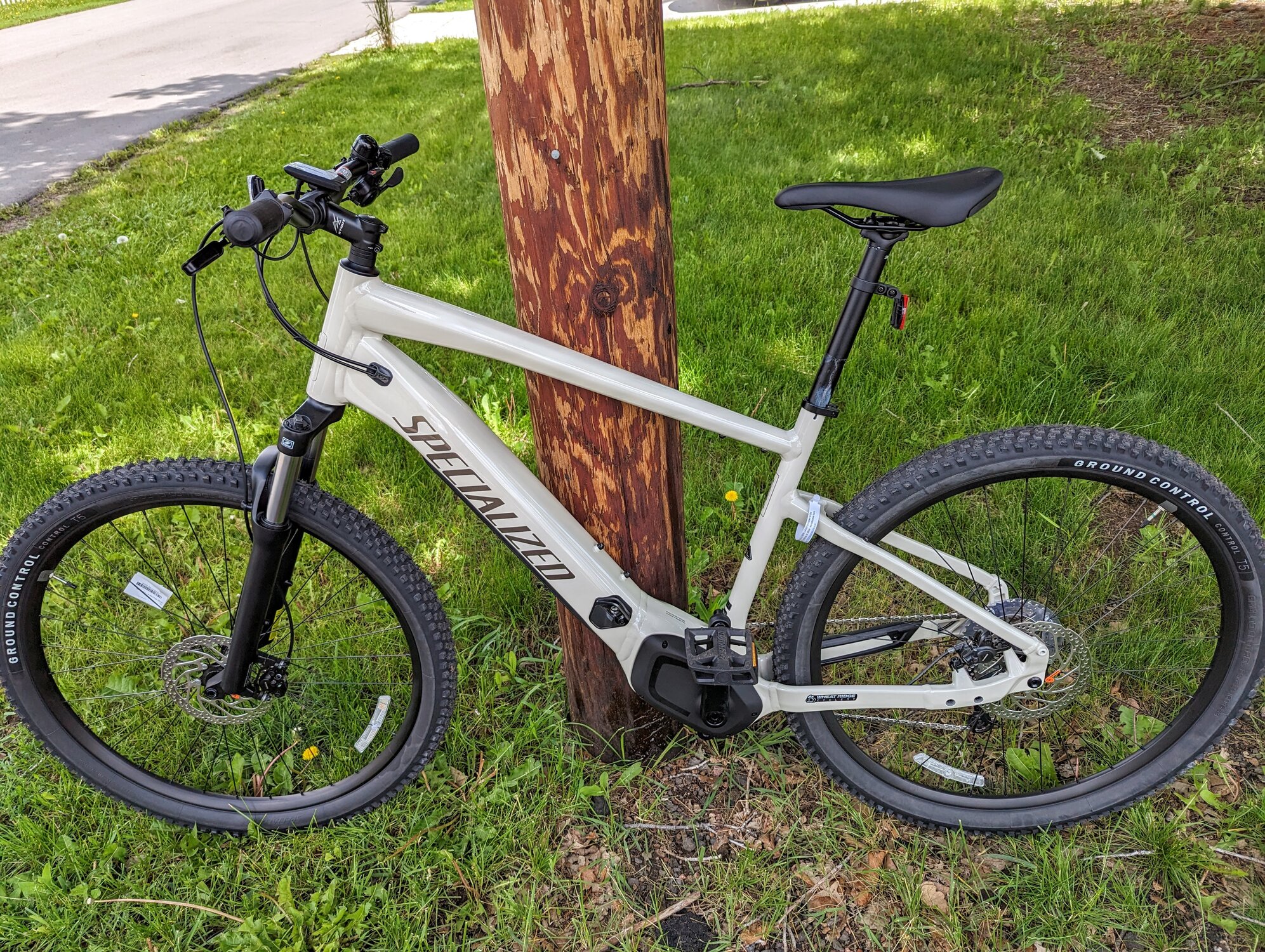

The 2 I have test ridden and am down to choosing between are:
Giant Talon E+ 3 https://www.giant-bicycles.com/us/talon-eplus-3-29er-20mph which needs a 1" longer stem;
Specialized Turbo Tero 3 https://www.specialized.com/us/en/turbo-tero-3-0/p/188110?color=317404-188110 which fits well.

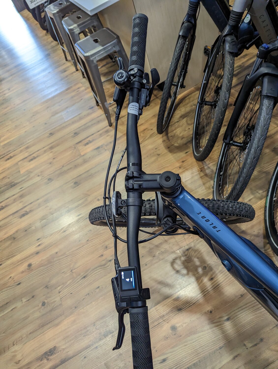

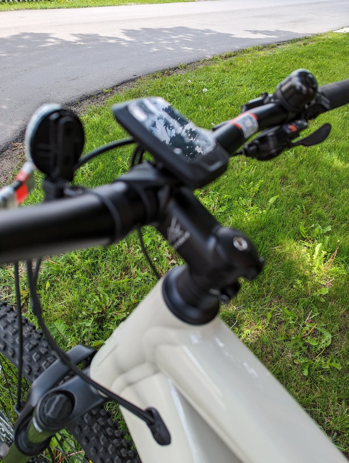

The Talon's tweaked Yamaha motor is quieter than the Tero's tweaked Brose. Both have 9 geared Alivios, tho the Talon has Altus shifters which are sweet. The Alivio drivetrain is not as smooth as the Deore's. The Talon's display is unreadable, but the Tero's MasterMind TCD, is very legible and modifiable. Both will need a dropper, and eventually a drivetrain upgrade. Both have larger tires than I think I need, but were quiet and gripped really well. Eventually, the coil shocks on both will be swapped for the lighter weight air shocks.
I think either will be fine, tho I would have liked to find something that needed less upgrades. Either bike would be ordered thru the same responsive LBS that will be glad to have me as customer rather than a looker. Suggestions for alternatives would be great, as well as opinions on these last 2 bikes. Thanks so much.

I find the MasterMind TCD much easier to read than the alternatives I've tried. The display is bright and crisp and it doesn't have a goofy font that makes 5's, 6's and 8's all look the same.

Just some remarks, Stuart. (Only discussing the Tero 3.0).
The upgrade is not as easy as it seems. Not cheap.
Expensive.
Very improbable, as most of shocks fitting the Tero are OEM parts.
If you could afford $4,500, the Tero X 4.0 is what you want, and more. It probably can be set to Class 1 by the dealer.
Additional remark: If you believe any of the heavy full power e-bikes is easy to pedal unpowered then you are probably very wrong :)

My son has had the Talon for over a year now. It's been flawless. The only thing that bugs me (not him) about it is that the battery pack is not upgradeable.
I have a Stance and love the dual suspension (even at the store). I recently upgraded the battery to 800wh.
That said, I don't think you can go wrong with either of your choices.
