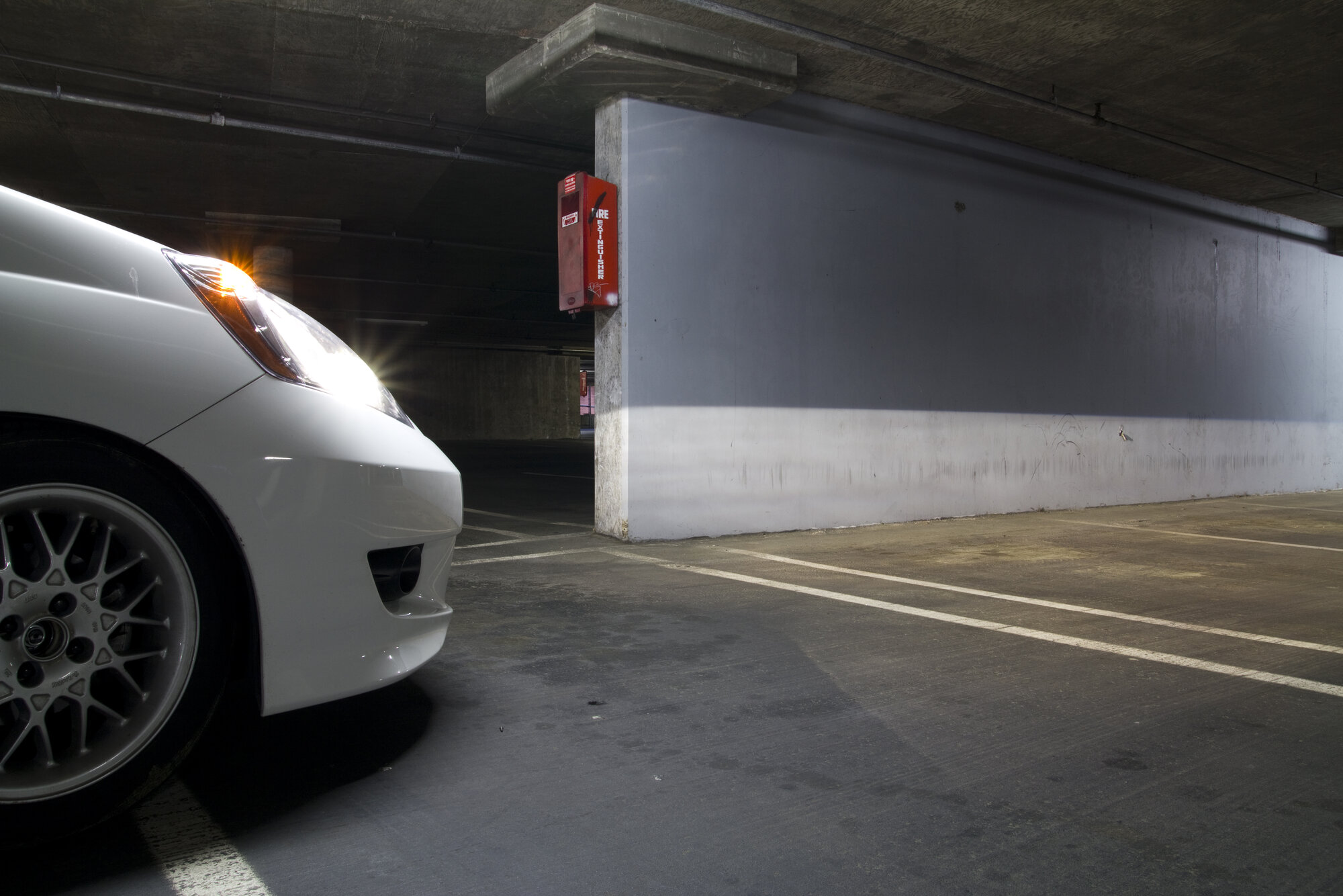

I used to dabble in the automotive light "retrofitting" hobby. TRS is regarded as one of the best sources for HID/LED retrofits. Something like the Matchbox 2.0 would be compact enough for bike use but you still have to build your own enclosure and the power source is going to be heavy unless you tap into your existing ebike battery. I'm sure it's worth it to some but I don't know if I'd want to add a projector, bulb, ballast, igniter and possibly a power source to a bike. It would be a very cool project, though.
edit: here’s a pic of my old Honda Fit “fitted” with HID projectors. The line on the wall is the beam cutoff, not a different shade of paint.

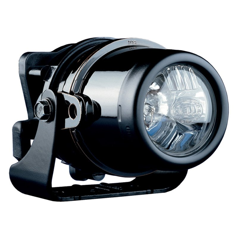

Did you take a look at the link... the Hella DE is a micro projector light.
It's about the size of traditional high-quality long-range bike lights... not to be compared to the $3-6 lights above. ;)
