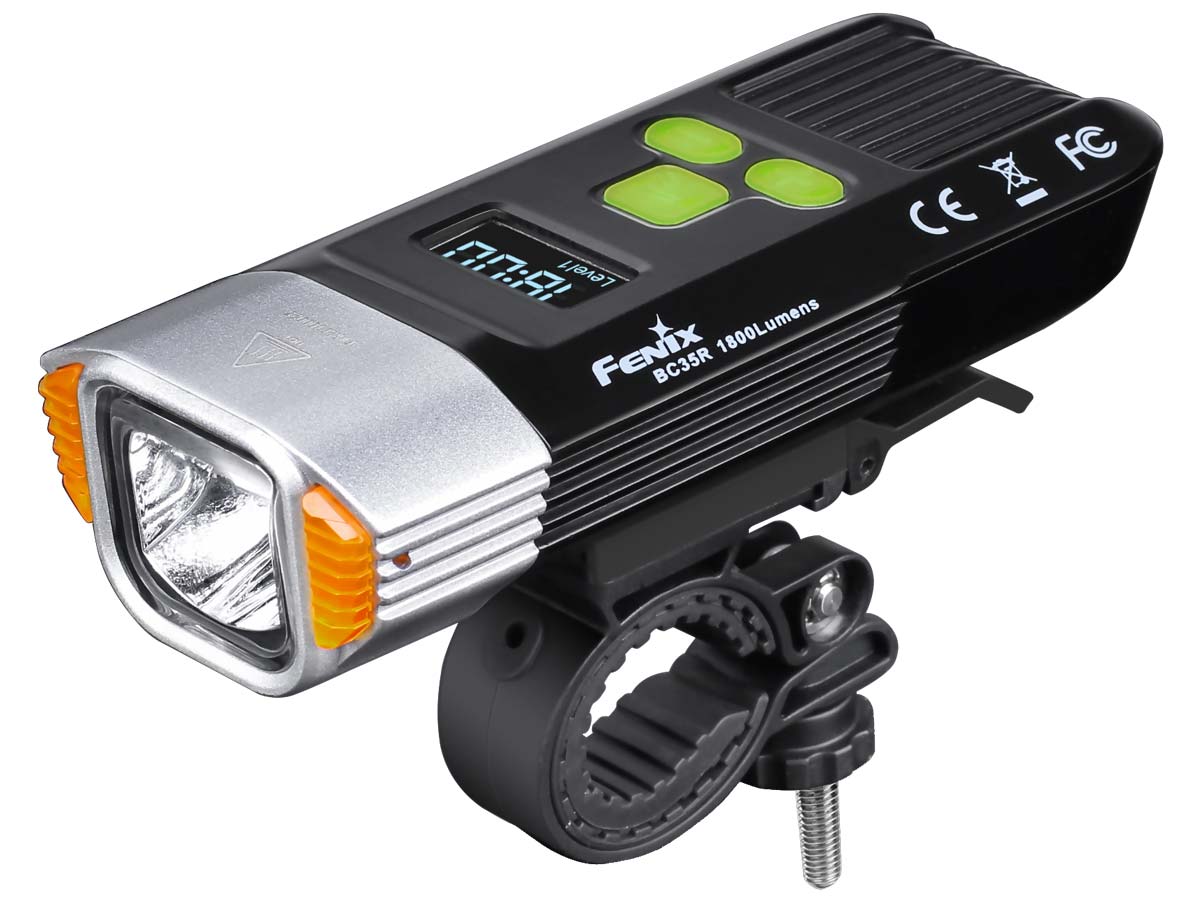

I also like a removable light that multi-tasks as a light on another bike and a handheld light when we travel. I'm using the Fenix BC21R. It has the beam cutoff, replaceable 18650 battery, etc. Very handy little light.
Nah doesn’t seem like it has a cutoff line since they mentioned it for about 2 seconds and never again.
Plus you can kinda tell with the lenses they use, it just produces a spot light.
Edit...the first ali link has one it’s a minor model name difference, it’s the R version, seems that’s the one with a cutoff
Again it’s the lenses, the one with the square lense produces their cutoff version, circle=spot light
For fenix it seems their cutoff models are the lights with square lenses like the one I linked.
The circle lenses they have look like they all have the same spot light with no cutoff. The BC30 you linked seems like they tried to make it a cutoff with the circle lenses but diffusing the beam via top and bottom of the lenses as you can see the clearness of the center but the wavy (on the lens)
Again this is just for their brand and definitely not the same with other brands that may have a cutoff point..just different tech.

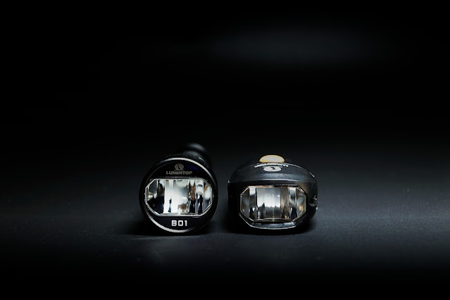

thanks! I just looked them up and I think I prefer the C01 just because of the shape
Lumintop B01 i C01
Lumintop B01 (z lewej) i Lumintop C01
I'm a B01 user. When I first got it, I remember being unimpressed on my first commute with it. But when I used it on a proper trail ride where there was absolutely no other sources of light pollution, it definitely "shined".
actually, never mind.. the C01 is 400 lumens and the B01 is 850 lumens.
Yeah that was linked earlier or in another thread, I didnt mention it because of the subpar lumen rating.
