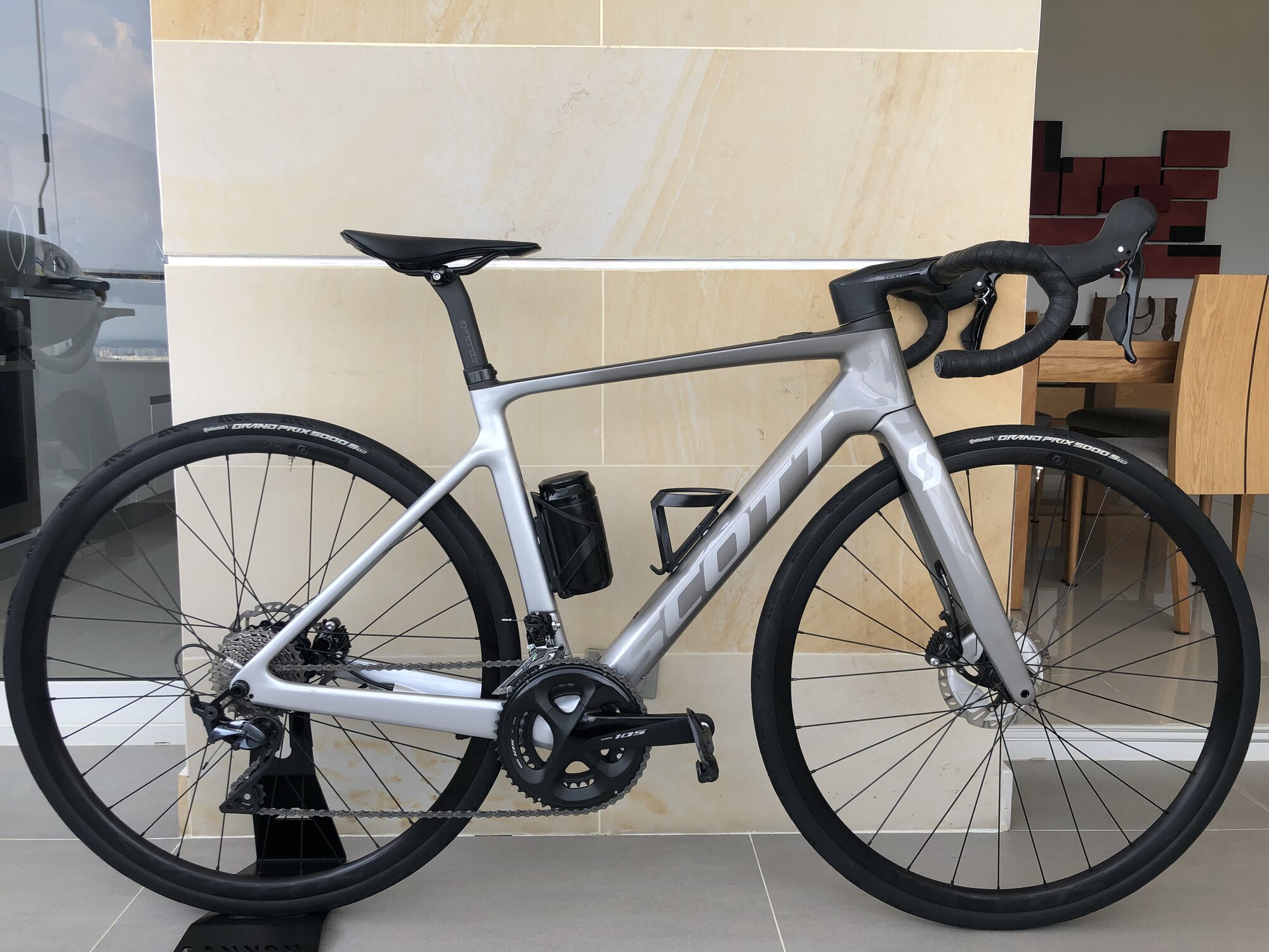

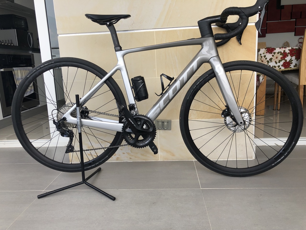

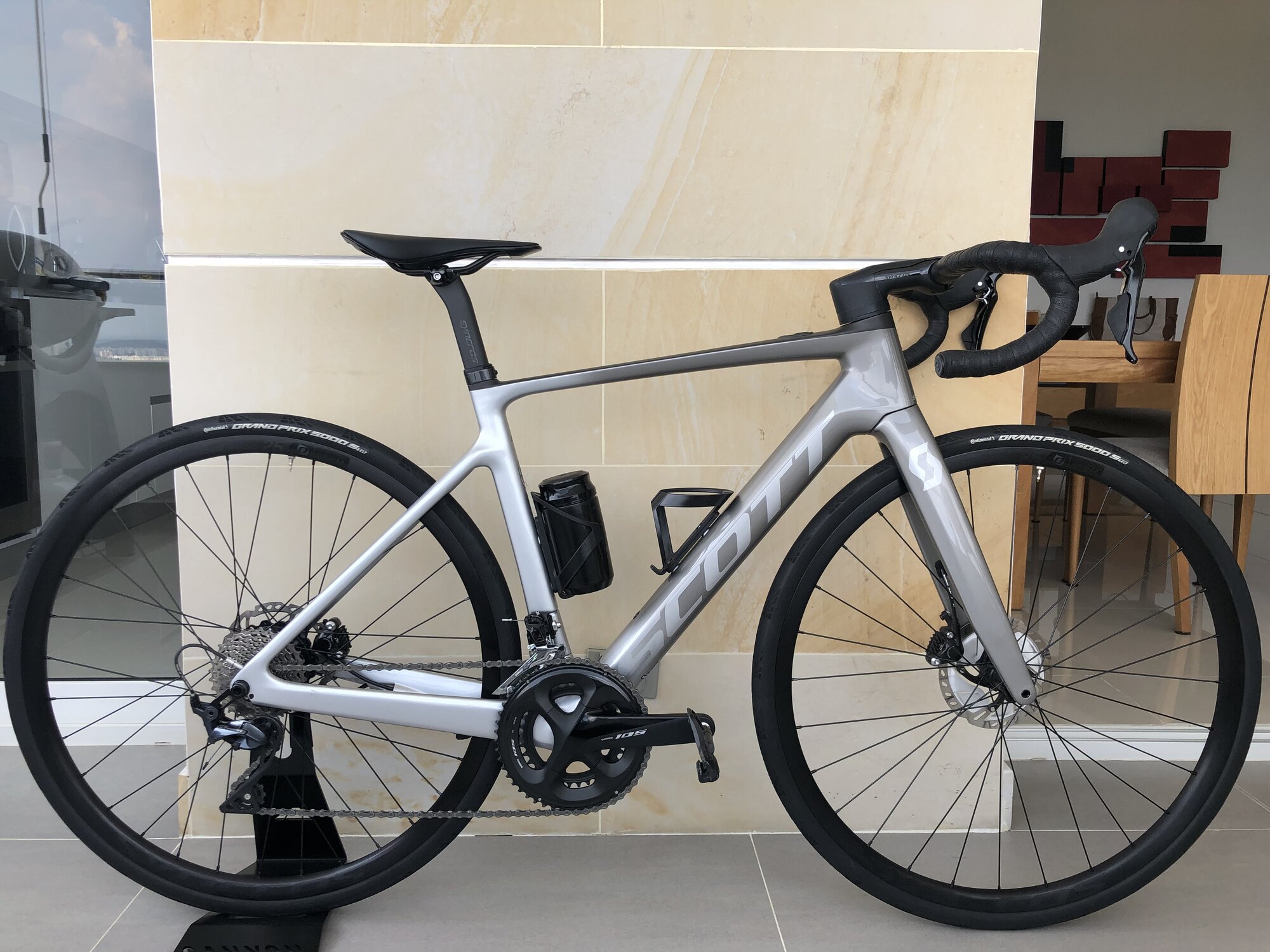

Hi all, I just got a SCOTT ADDICT e-RIDE 20 (model 2021). I'm planning to ride it, modify it (hoping to improve it among several dimensions). I cycle five to six times a week in Colombia, about 80km on average. I can easily sustain a speed of 32kmh (about 20mph) for an hour. Sometimes I ride more than 100km, another times I do shorter rides of 20-30km at higher intensities (usually climbing). So, I can say I am a relatively trained cyclist. I bought the bike because of curiosity. I wanted to know the feel of riding an e-bike, specially when climbing. I also wanted to measure the impact on several performance metrics (speed, power, perceived effort, etc). I would like to share my experience and my questions on this forum. If you have questions, please do not hesitate to share them here. Here are some pictures (I promise to take better pictures of the bike in the near future! ).

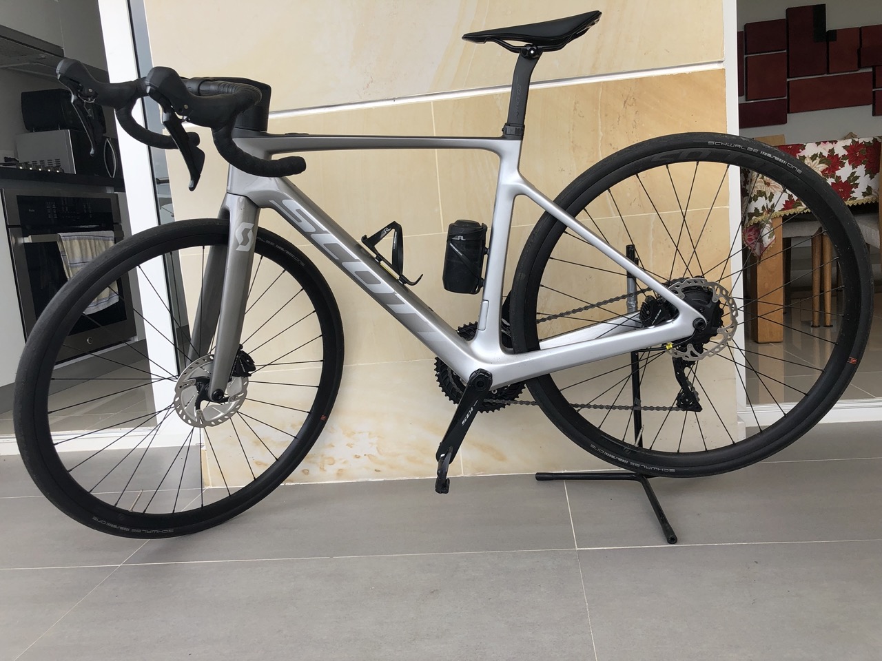

(BTW here is another picture, with Continental GP500s TR. Riding those tires at 65 psi just feels awesome!!)

(BTW here is another picture, with Continental GP500s TR. Riding those tires at 65 psi just feels awesome!!)View attachment 112967
nice! i ride my tubeless 32mm GP5000 at 45-50psi!
