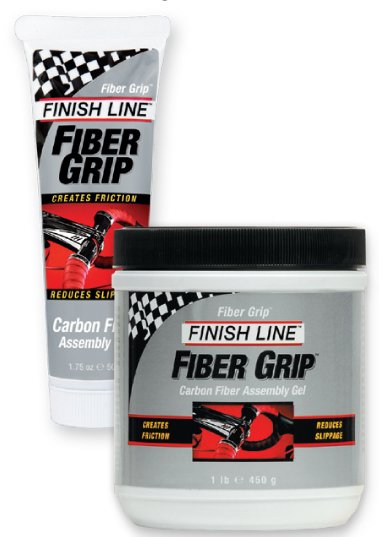

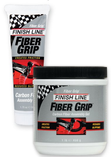

This stuff is good at preventing slippage. It is originally designed for carbon fiber bikes so things like seat posts do not need to be over tightened. It is not glue-like and does not dry out. It just adds friction and grip. It could even be used on a cellphone holder that you do not want to slip.
Thanks for this one up, wonder where I can find some.
Probably going to get some of this stuff, thanks, cuz I really dig my long sweep handlebars
