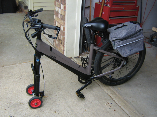

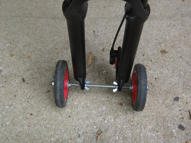

I've been loading the bike upright in the back of the SUV with the front wheel off. It's a bear to get in; I pick it up and set it inside as far forward as I'm able, then because it still needs to go forward about 3 more feet I was 'walking' the front fork in by leaning it side to side a tad and working the handlebar back and forth. This just isn't working well, and it's probably how I messed it up. So I bought a 3/8" x 12" threaded rod to put into the fork, and used a couple of old 'hand truck' (2 wheeled dolly) wheels, to create a low wheeled axle for rolling the ebike into the SUV hatch. The wing nuts provide enough friction to hold the axle in place for the short usage... if I'm careful.

The handlebar stuck out too far to close the hatch when I tried it that way. :( I like this Lexus GX470 quite well, but the rear storage space continues to disappoint me versus my old 2000 Mountaineer (Explorer twin).
