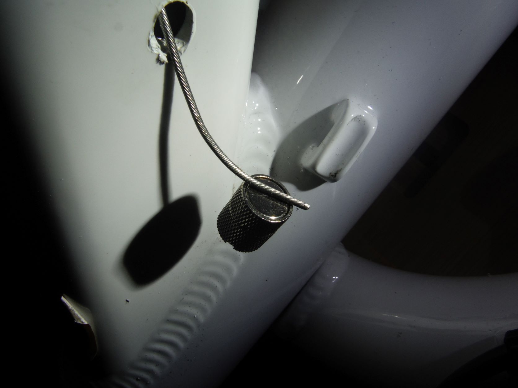

Well there is a bigger problem looming on the horizon.
The back brake line is fed thru all the main internal channels of the bikes frame.
Is there a way to thread this back brake line thru the channels and the right frame stays?
I can see a big headache coming on..........

I use a piece of cable in the butted joint. Mostly I am doing runs for the first time when building. For that I run a brake cable with a slight curve on the end and guide it with magnets. Then I pull using adhesive shrink tube.
Hey Pedal
Can you explain HOW you guide it with magnets, when most bikes are made from Alum?? Slightly confused here.........

One end has a loop that can be twisted, the other a slight hook. Measure the length, insert and twist, extracting with a magnet.
Ped
Ok, I can see that working with metal brake cables,
But what about the plastic brake lines,
last time I checked plastic and magnets don't stick together?

That is only the fishing line. What you attach to it is up to you. You can even feed it thru a plastic housing.
