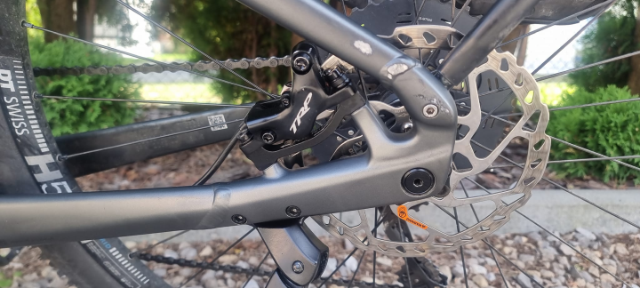

Upon receiving the shipment with the full set of F/R TRP Slate (HD-M807) hydraulic disk brakes (post mount, 4-piston), my brother had to spend some time to understand the technology. The brakes had many details that made them different from TRP Zurich!
For the start, the brake set came filled with the hydraulic fluid (mineral oil). The brake lever/hydraulic pump assemblies were closed with threaded plugs. The provided hydraulic lines were closed with tiny threaded plugs including miniature O-rings. The other end of each hydraulic line was already connected to the main brake, which was pre-filled with the mineral oil, too. Each brake was equipped with organic brake pads and the transportation spacer. If the user were happy with it, installing the whole brake set should be trouble free and instant.
Unfortunately, my brother was trying to shorten the hydraulic line to the proper length, and moreover reuse the existing Zurich main brake. It has turned out the connections of the Slate and Zurich were incompatible. Even more funny was the fact the bleed hole thread at the brake lever assembly was Shimano but not TRP Zurich compatible! Moreover, the Zurich came with a refill valve while it was not present on the Slate.
All in all, my brother could replace the complete rear Zurich brake set with the complete Slate set. Only the post mount spacer of the Slate was not high enough to accommodate the 180 mm brake rotor, so the Zurich spacer had to be reused.
The Slate brakes are not as powerful as the Zurich, and are not that well air cooled. However, the new brake works nicely, and its performance (for example, smaller pistons) is not critical for the rear wheel. The most importantly, Zurich brakes have been discontinued, and the price of the whole TRP Slate set of 87 EUR was an incredible bargain...
Meanwhile, we discovered that TRP brake pads for Zurich and Slate were identical to Shimano DS03... The latter are easily available.

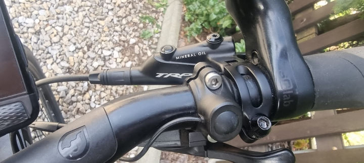

The TRP Slate brake has replaced the TRP Zurich (the latter being a premium e-bike brake, discontinued).

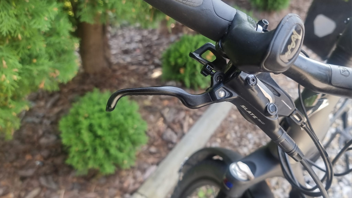

The brake lever/hydraulic pump assembly.
