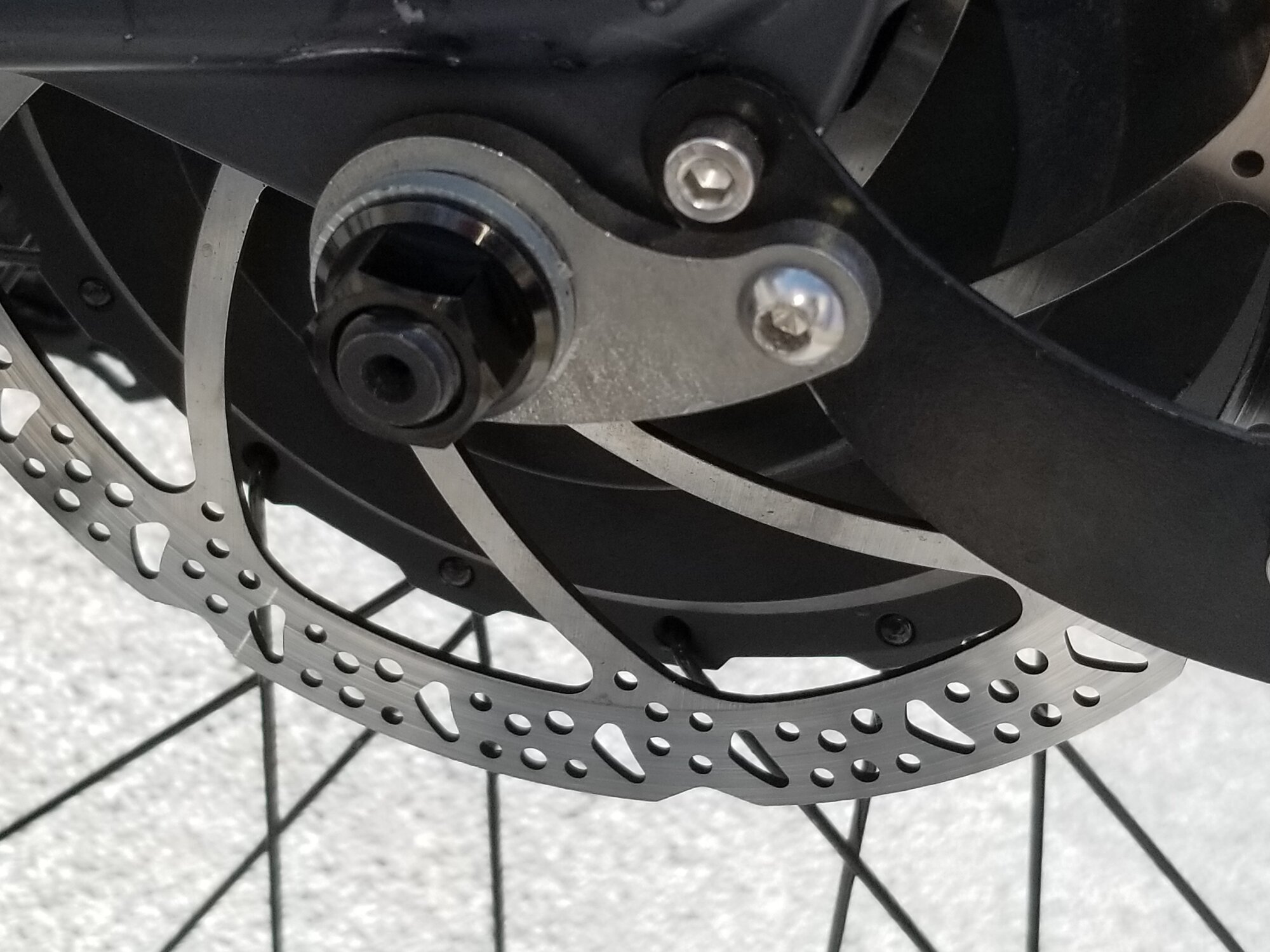

If I could see the casing and remove/ measure that bolt it would clarify if a bushing's required, but I tend towards 'shoulder bolts' ...​
Image result for double ended shoulder bolt
The casing is clamped tightly - where it's meant to be, to the correct torque - but it allows attaching another part. The quality of the bolt(s) required is discerned by the marks on the stock fastener.​
I've read 'Ultra housing is cast Magnesium alloy'. No doubt you're a big boy, but Gorilla cranking that hardened steel bolt is a terrible idea. Find, and stick to specs, and of course, use fat washers to spread the force.​
Conveniently, the motor casing provides that area. I can't see the lower bolts, but they might be even better and simpler.​

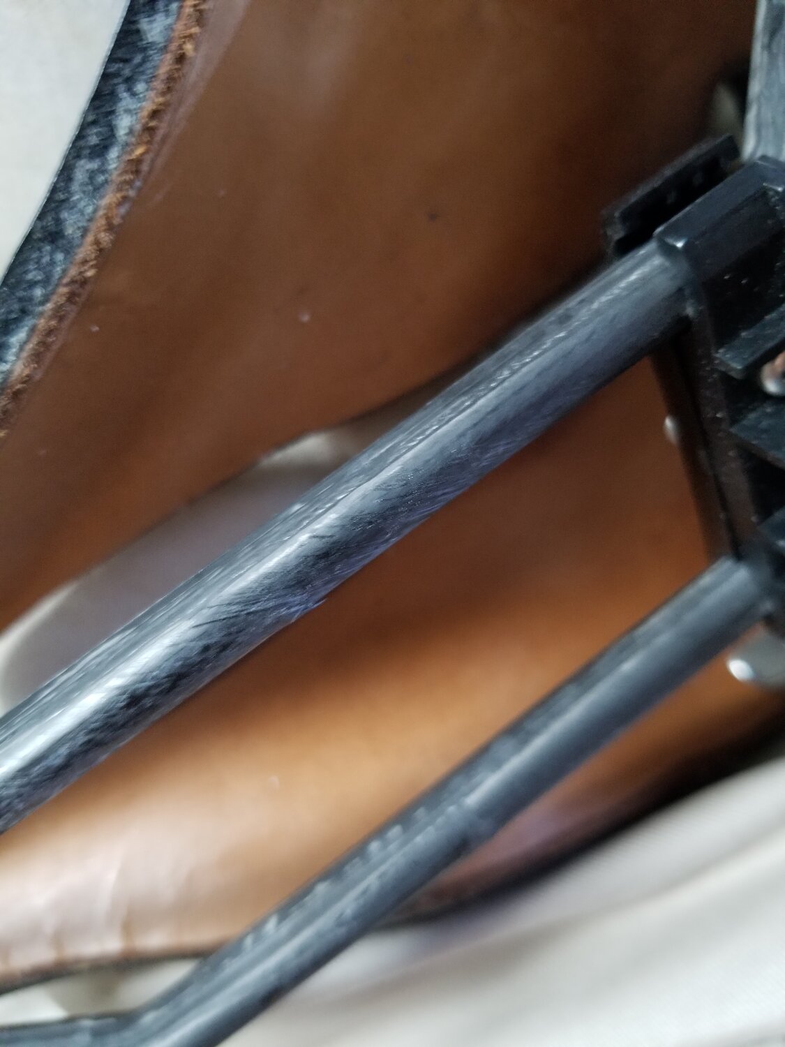

I woke up out of a sound sleep at 4am, realizing my Selle Anatomica's Carbon Rails are clamped in metal😖.
I see why they advise 'keep your tail off the seat for bumps', and I do. Ti is way better material for that purpose.
I need to adjust it a bit so I'll check those rails after a few hundred miles in a metal, Kinekt seat-post clamp.
I really want to thank you CF frame owners for stimulating an old man to think.
I followed CF materials from buckyballs to the 80's, so seeing CF being used for applications I would've never thought possible, I've mused "Gee these guys got good". "Most of my knowledge has been superseded and manufacturer's have overcome the inherent problems w/ CF.
What I'm trying to say is I hate it when I'm right:mad:. I was hoping I was overly cautious, even paranoid. Hell, 'delusional' would be my preferable verdict.
Either way, I reached down to that rail, right at the end of the seat post clamp for a lil' feel and was 'stabbed' in the finger.
If you, like me have actually worked with CF, you know what that means: This is not good.
I'm anal about specs. I torqued that clamp to 6Nm. It replaced the SS tube - I just re- installed that inspired me to jot a few lines.
This is Selle Anatomica's best. I ride off the seat for bumpy terrain and have a Kinekt to absorb shock.
Look at that upper rail.
It cracked and separated directly .25" behind the clamp.
Look at the direction it broke. It must be shattered all the way through. Keep in mind the whitish stuff is not damage. It's all over the rails, which have raised bumps that slightly abrade the carbon. Abrasion is also present in the seat's plastic inserts for the rails. I'd of used Teflon.
You decide.
I'm calling the local manufacturer tomorrow for a replacement.
Did I do something wrong (besides not stick with Ti)?
Anyone knowing a solution to stopping it happening again, I'd like to h👂 it?
