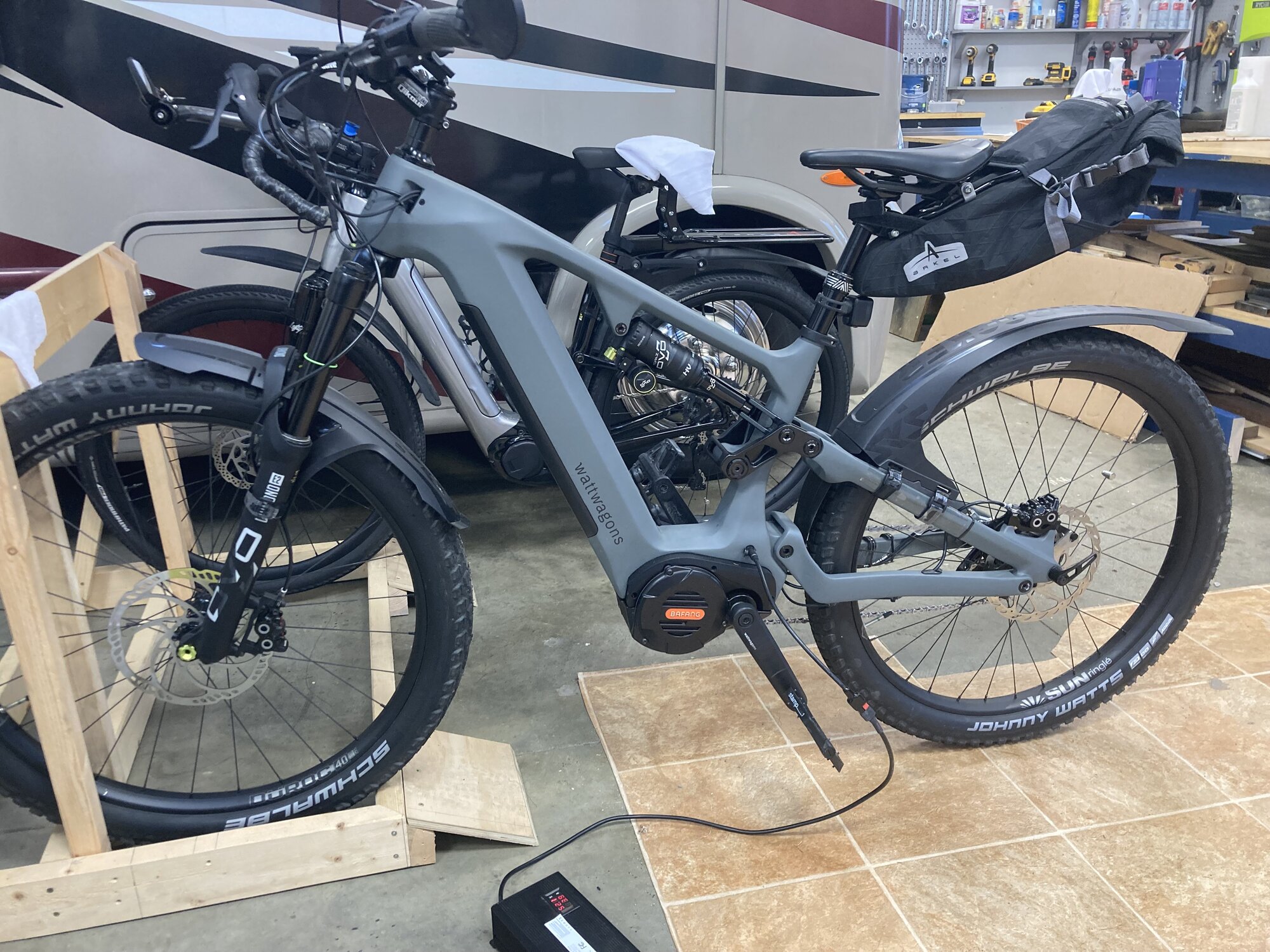

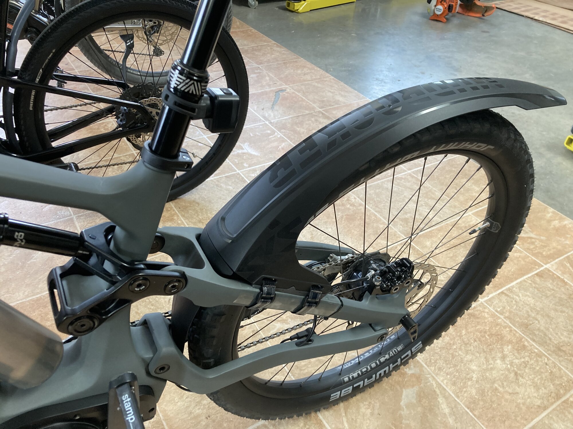

Installed my SKS rear fender today. This is a well made, sturdy product.
