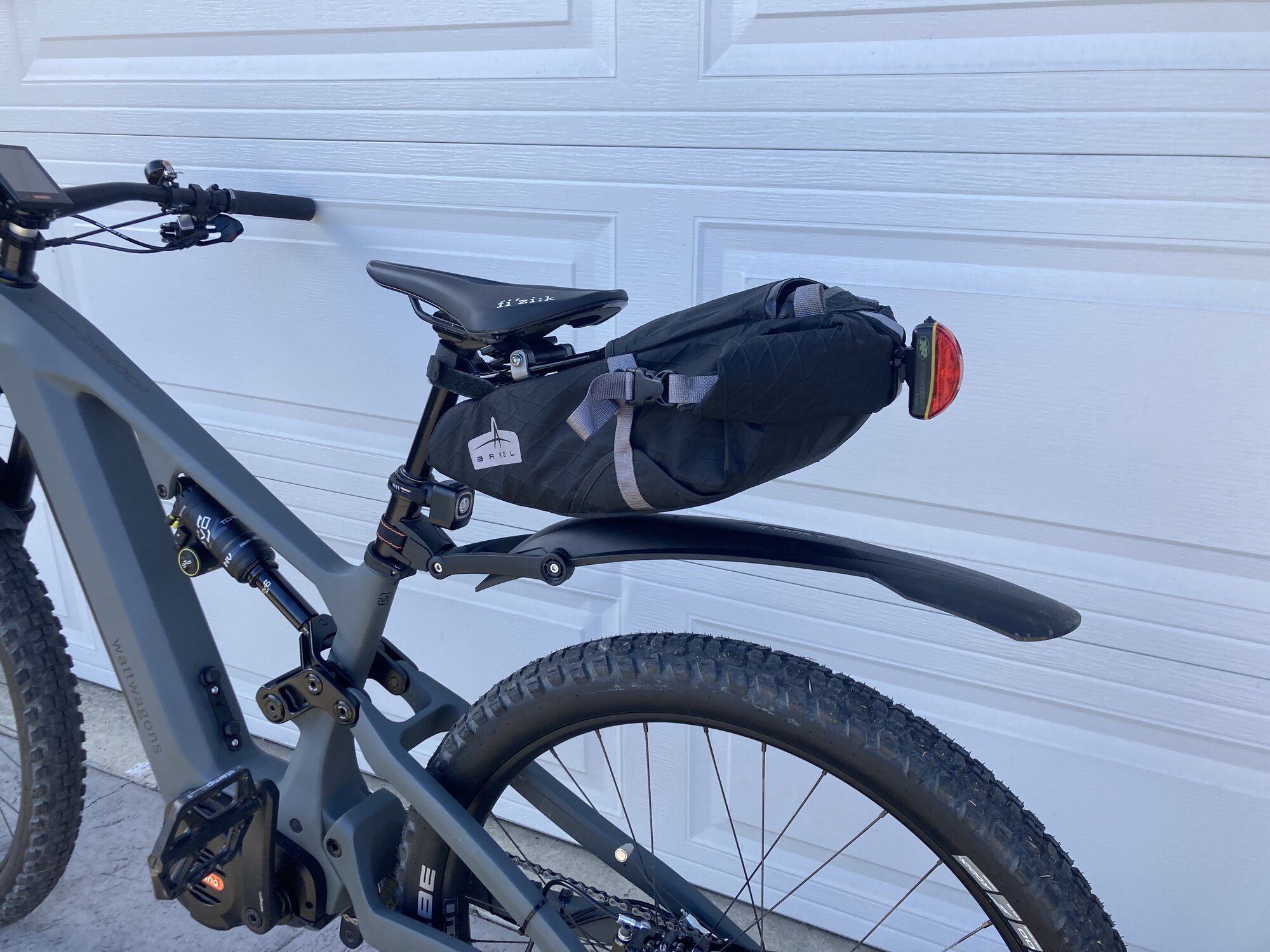

In my search for ways to carry items on my Hydra I tried mounting a seat/post bag that's on my road bike. Because the frame is carbon I can't mount a regular rear rack.
So, I put it on, along with a fender off my e-gravel bike and when for a ride.
I had fender rub while riding on a gravel pathway, so I took the fender off. I was surprised when the back tire made contact with the bag when I went over a small ditch.
Looks like this seat/tube bag won't work on my Hydra.
I think I'll order the Osprey fanny pack that was recently mentioned and forget about trying to find a seat or frame rack/bag that will work with this bike.

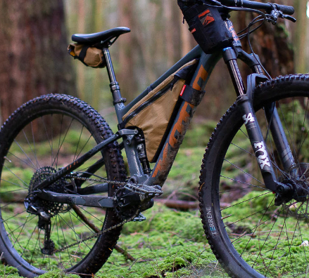

I'm on the list for a Rockgeist frame bag - wish I had placed the order a loooooooong time ago though as they have a long lead time current and I don't expect my bag for another couple months. They're not cheap but pretty sweet and it's something I can get my job to reimburse me for. Ordered with the bolt-on bottom & lace-up top for best stability on my frame (and no strap on the bottom in the way of the battery). I also sent them measurements of the downtube's width to see if they can make the base of the bag match that - just maybe about 0.7" wider than they normally do their bags for wider frames. All the bags come with a hydration port up at the top/front, and some other features, multiple materials available to use, some other options add on if you like spending even more money... I got mine in Coyote Brown like the 3rd pic - they also make tons of other bags too!
That's too bad - this was looking pretty clean/promising!
A downside to using the seat/tube bag was I could no longer use my dropper, which was something I could do without to get the storage.

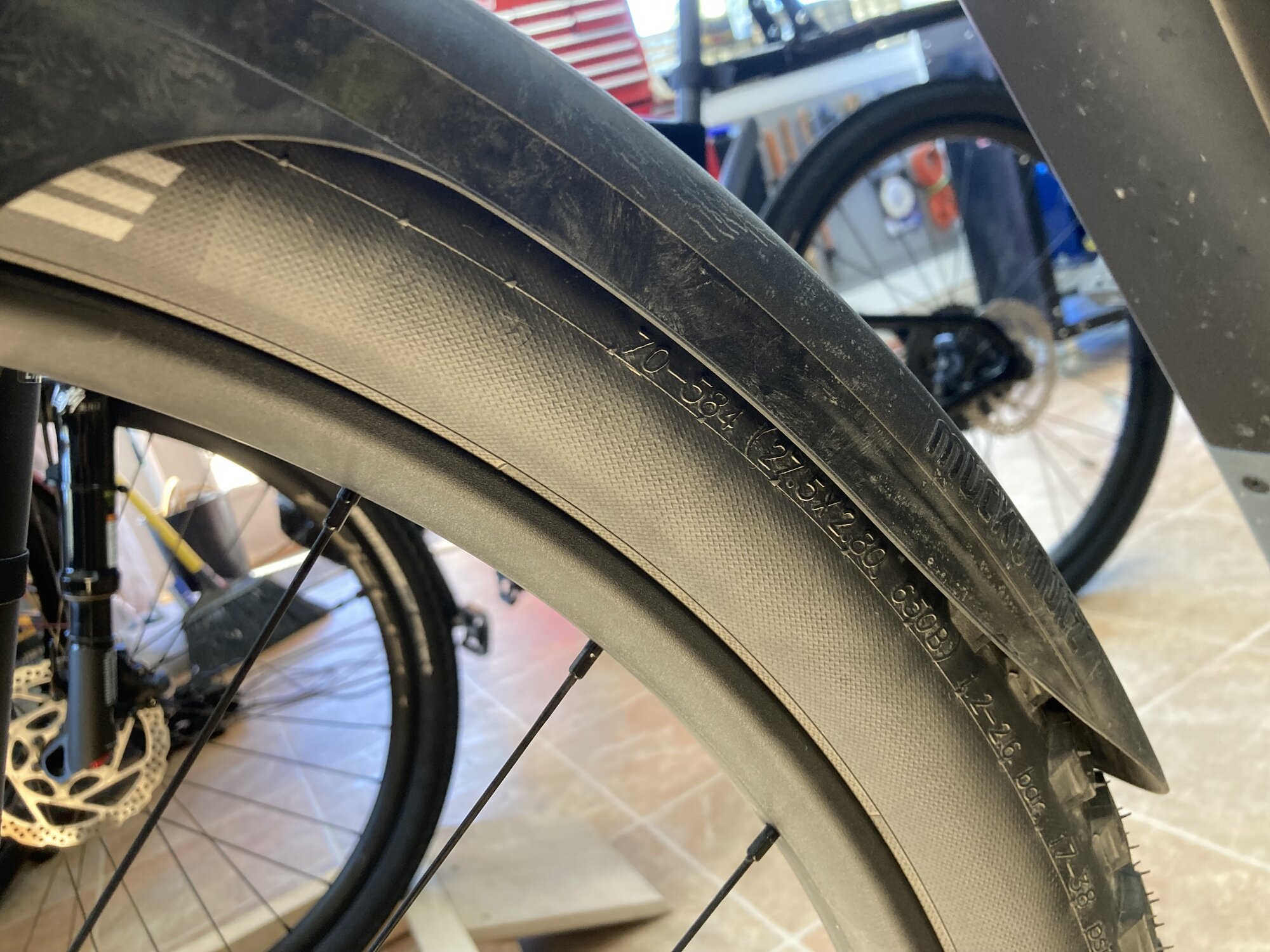

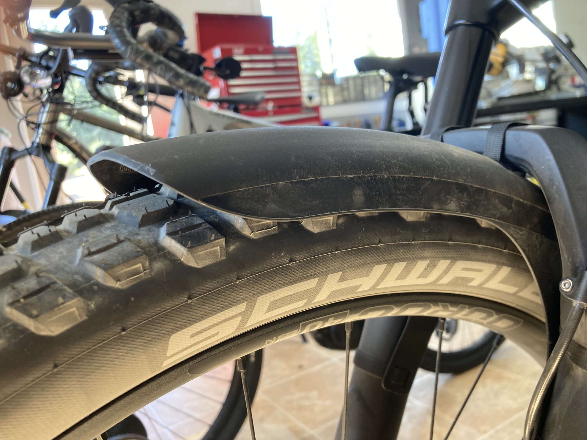

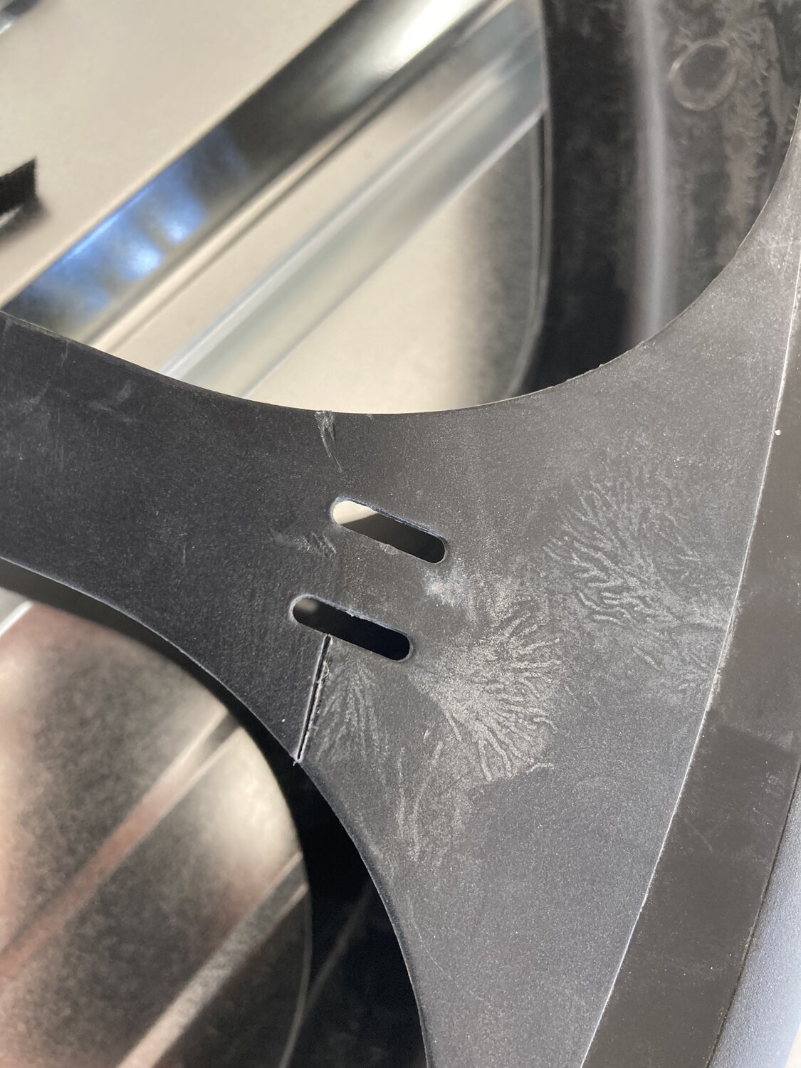

This summer I ordered a MuckyNutz front fender and a SKS rear fender.
I installed the MuckyNutz and went for a ride today and it looks like I'll be looking for another type/style of front fender. :(
The photos below show that the fender fits very close to the tire and I could actually hear the fender making contact on todays ride which included wide, easy trails and gravel roads.
I took the fender off when I got home and noticed a break in one of the support 'arms'.
I'm not sure if the break was my fault, or poor quality on MuckyNutz's part. I will say that the fender is very thin, especially the support arms that attach to the fork.
The SKS rear fender looks to be a more quality fender, but then-again, it was more expensive.
