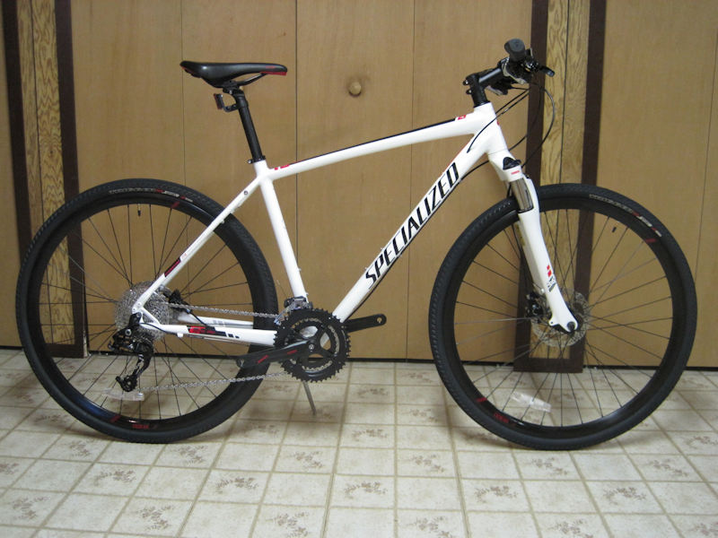

I'm looking ahead to an eBike within the next couple of years, but just haven't seen anything locally or from the bigger mfrs that quite fits the bill for what I'm thinking of. What I would like to do is to replace the hybrid/trail bike that I now use for a lot of my riding (I also have a carbon road bike that I'll be sticking to for the rare times that I use it).
This is what I have been riding the last 7 years or so. The photo is from when it was brand new and doesn't show my bottle cages, rack, and various bar accessories, but you get the idea. It has 700x38c multipurpose tires, and I use the bike mainly for the following types of riding:
- Paved and unpaved rail-trails locally and around the state.
- Casual local riding with my wife or to run errands, get an ice cream or coffee, and so on.
- Multi-day non-road tours such as on the GAP-C&O and Katy trails.
- Occasional rides with the local serious gravel grinders group on back roads that are hilly and sometimes pretty rough depending on how recently graded (most are riding MTBs, but I can generally keep up for the first 30 miles!).
Most of the eBikes that I see are either Class 3 full-on MTBs with the Class 1 bikes being more of the cruiser variety, where what I'd really like is a Class 1 eBike equivalent to what I already have. The closest I have seen in person is the 2018 Trek DualSport+, where the DualSport is really the Trek equivalent of my bike. However, for 2019 they seem to have softened it up a bit (and added $800 to the price!). There is one good eBike specialist store in the area that carries a number of specialty brands; I haven't visited them yet, but none of them appear to have what I'm looking for, if it indeed exists.
Any suggestions?

First you need to decide on motor configuration. This depends on your recovery plan. If, when the electric drive fails, you intend to call for a taxi or friend on your cell phone, then mid-drive bikes seem to have the best reliability reputations these days.
If you intend to pedal your way to the next stop, you need a geared hub drive. These do not incure drag when you pedal the bike unpowered. This also allows you to override the range of your battery. Second choice is the direct drive hub. These drag a little bit, but I am coping with that on mine as I try to build a dual voltage battery charger not made in *****. I think the DD drag costs me about one sprocket at all speeds.

That bike, having disc brakes on it, would be one I would personally consider as a good candidate for a DIY e-bike conversion. This let's you spec out a battery that suits YOUR mission, with little compromise. It also lets you spec a power system of your choice. I'm a big DD rear hub motor advocate, and would recommend something like that, maybe 1500w, IF you think your average speed will be much over about 10mph. If less, a gear drive might make more sense.
Not sure of your budget, but it seems like production bikes that might do a good job on the mission you describe are going to be pretty pricey - and then, you'll very likely have to compromise when it comes to things like battery capacity, the lack of setup flexibility, etc.
Look at kits from Leafbike.com (pretty decent reputation for buck spent vs. bang received), and details regarding the LCD3 display when used with a KT type controller (which Leaf uses in their kits). Some time spent there will make you a more educated buyer I believe.
For a battery, the 20-21ah batteries are starting to come down in price. I would look for something close to that.
Using your bike, a good conversion kit, and a good battery should keep your budget in the 1000. dollar range. Bonus would be you built it, so you could figure out about anything that goes wrong with it (not likely for quite a while), and mods would become second nature using over the counter parts.

Your riding seems quite similar to my own and my 2018 Trek Powerfly 5 (light duty eMTB) has proved satisfactory. I'd suggest testing the DualSport+. It does seem a tad on the expensive side.
... David
