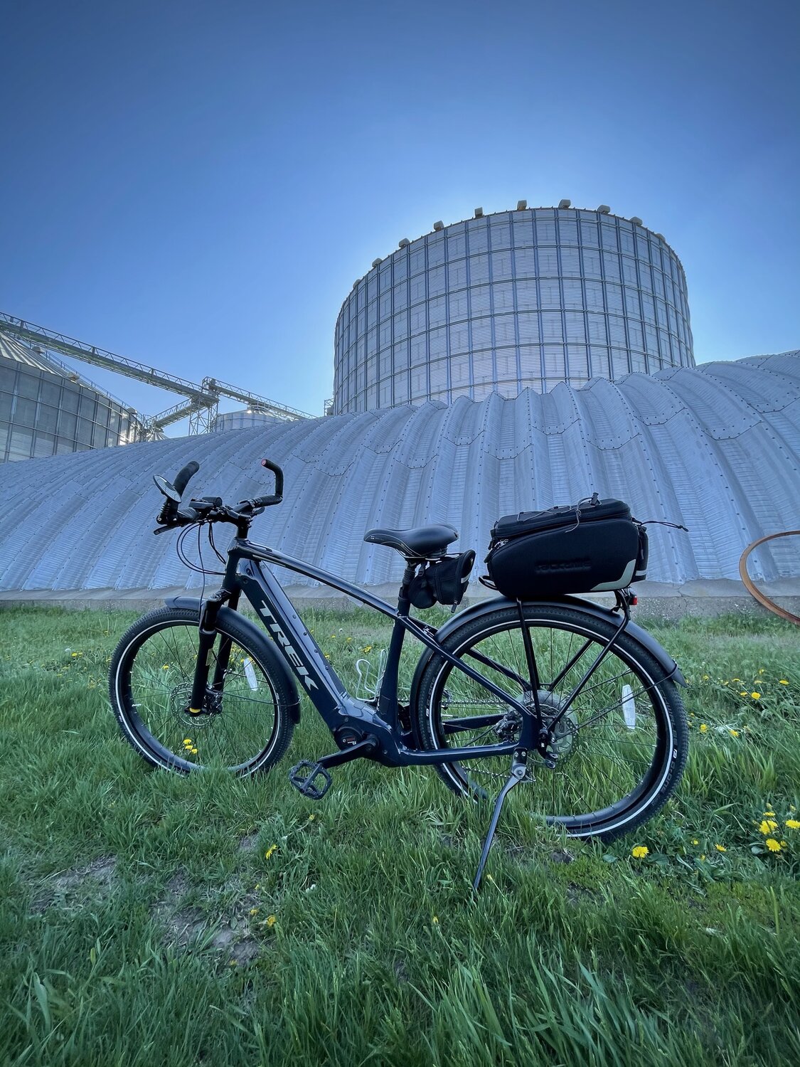

Well, took me about an hour of pushing and levering the bead back into the rim but finally got my 27.5 x 1.95-2.50 size Tannus Armor (w/tube) installed in the rear tire. My hands are tired! The ride (just down the street and back) was good with about 25 psi vs my normal 40. Maybe a tad squishy vs normal but I’ll take a longer ride with the battery to truly give it a solid test.
What is the recommended psi range from Tannus for that tire?
Did you use some powder?
I did see a Tannus video with a recommendation of 2/3rds of normal. There was powder used the last time the tire and tube were installed so I didn’t add any more.
Inflated it to 25 psi then took on a 16 miler where all went very well. I’m just wondering if I should bother installing one in the front tire as I’ve never had a front flat in my life! How many of you have had front flats?Thoughts?
Inflated it to 25 psi then took on a 16 miler where all went very well. I’m just wondering if I should bother installing one in the front tire as I’ve never had a front flat in my life! How many of you have had front flats?Thoughts?View attachment 86538
Pretty sure front flats are common, I have had my share. That being said the fronts are easier to fix than the rear especially if you have a hub on there.
BTW seems like you should be able to adjust the psi to get rid of some of the mushiness. I remember now, it was in the FAQ section of their website, (see link in my post with the pic.)under will they compress:
"The armour will compress some after it’s installed depending on the pressure of the tire. The higher the psi the more condensed the Armour will become. If you wish to keep the Armour as thick as possible then maintain a lower psi. You may also deflate your tire if you’re not going to be riding for a longer period. This allows the Armour to rebound back to its original size."
