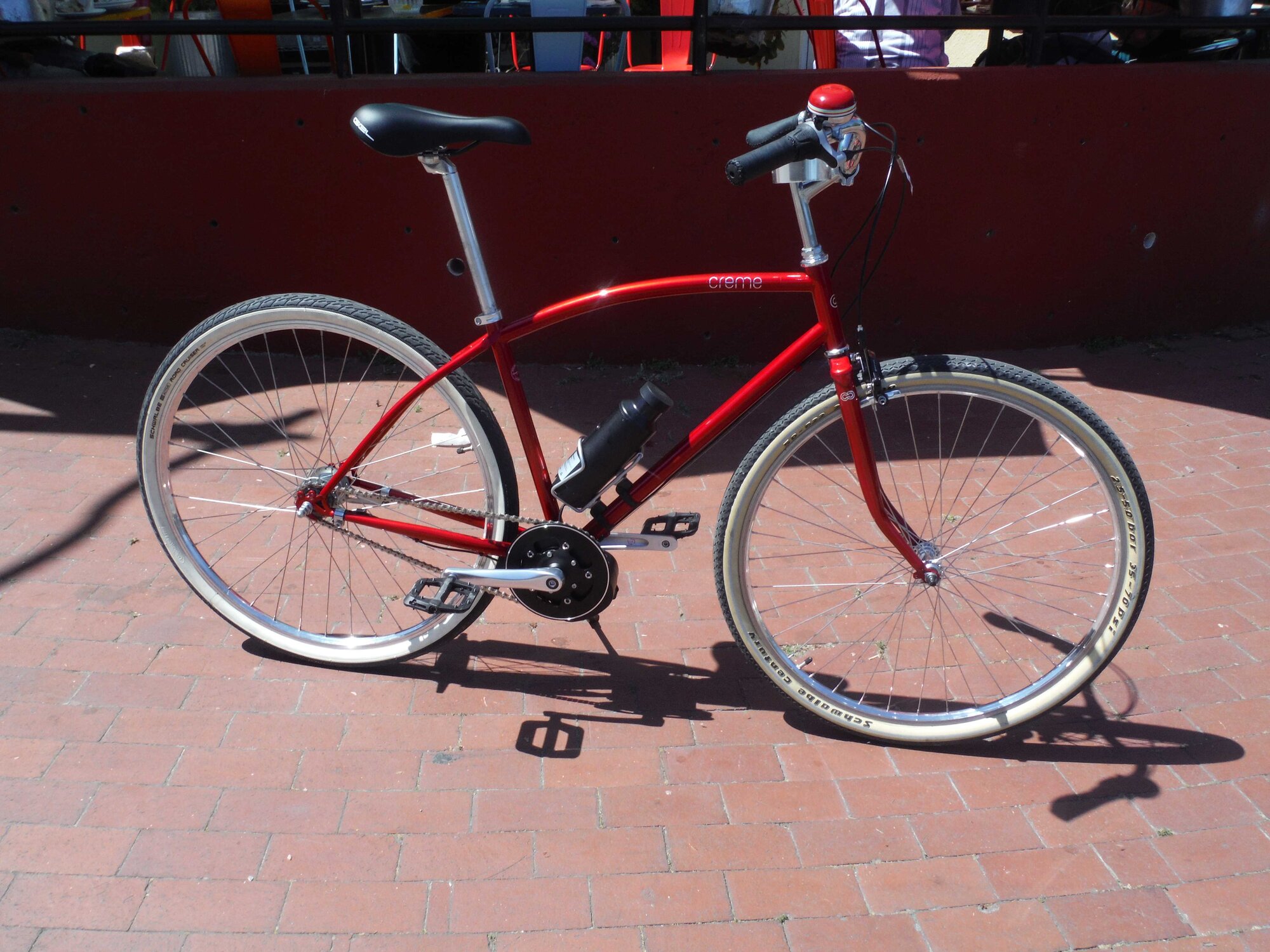

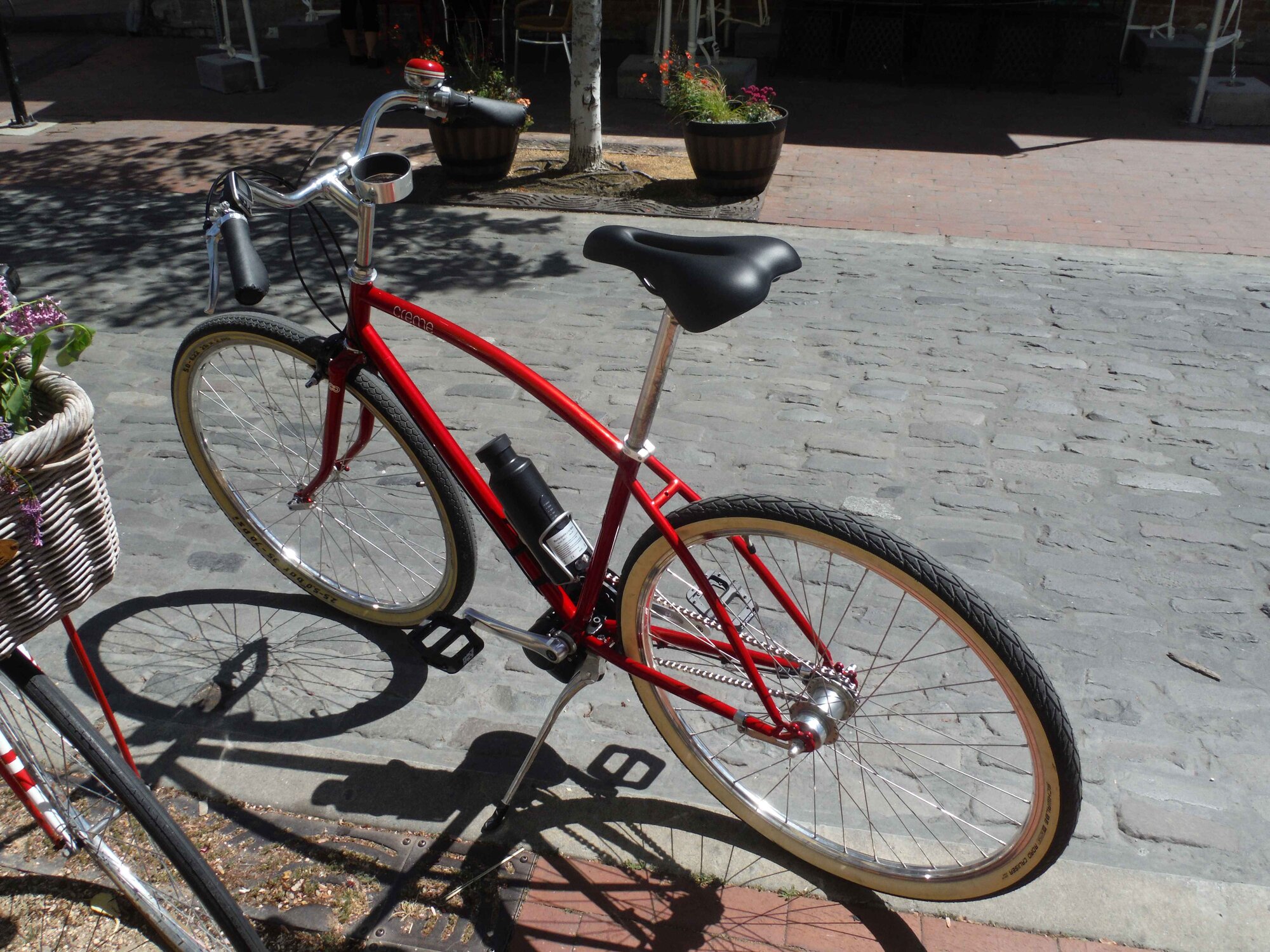

This is one of my electric bikes. It cost me $400 before conversion. It is skinny where it counts and curvy as hell. But regrettably no planned obsolescence or loyalty program.

Not too bad. Some type of mid drive with the battery in the water bottle? It looks perfect for a city ride

Bosch is super nice. No bashing here. They are lovely and worth every penny! And Bosch is in for the long haul. Very reputable. I have ridden them, supported them, and sold them with confidence. With the red bike she (the owner) has hand issues and lives in hilly Sausalito, CA. So, I made her a coaster brake bike, so she does not need to use brake levers to slow down or stop. Her Mill Valley boyfriend is an avid carbon road biker, she can keep up as they ride together across the GG.

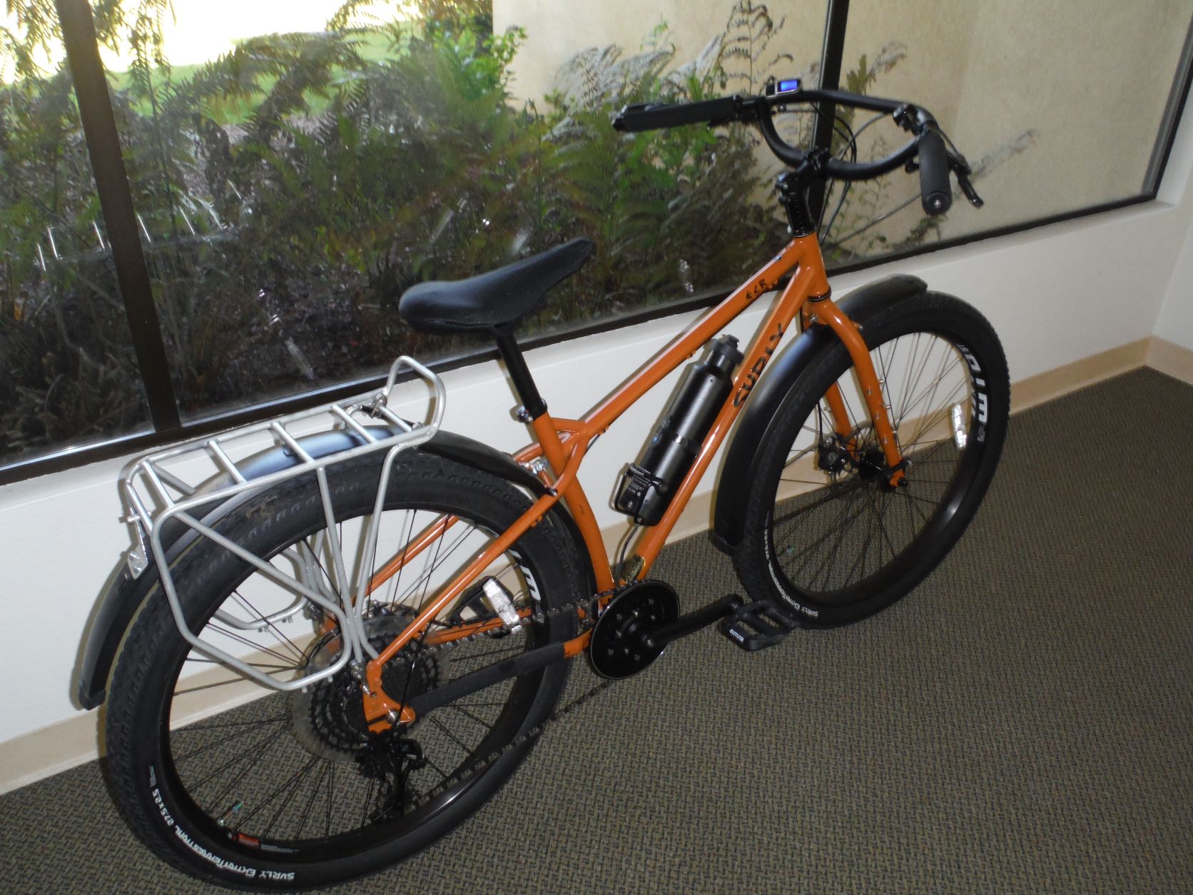

What is nice about this bikepacking bike is that it will be usable for the next 20-years. There is a connector that allows for various sizes and shapes of batteries. Parts are available on multiple websites domestically and internationally. A bare new motor sub-assembly costs $65. A new controller $65. Other parts are similarly priced. The entire electrical system can be removed and the original drivetrain reinstalled. Or in ten-years when the technology advances a new system can be installed. And the firmware is open source like Linux or Wiki and not like Apple. This guy opted for two batteries, a large and a small. The imbedded carbon footprint in the bike will be sequestered and used for decades. Then it can be melted down and reused. He has a huge smile after taking his first ride in the hills.
