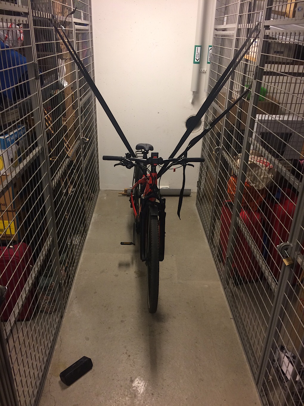

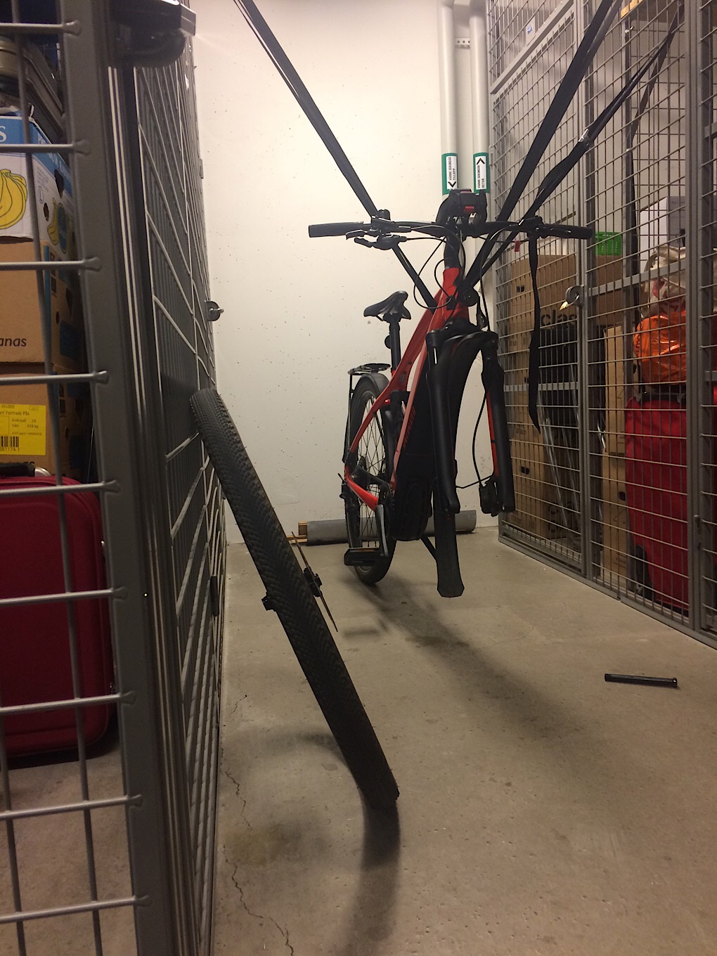

Had a flat front tire on my Specialized Vado a week ago. This was a slow leak so I noticed it at home on Sunday morning. Realized that the upside down method would not be easy for me with this heavy bike and found a way to hang or lift front of the bike with some long straps in the basement where we have store rooms.
The real problem turned out to be getting the tire loose. I thought it was glued to the rim. No way I could get a tire iron down between tire and rim. Had to work the tire for a long long time with my old weak hands before it loosened. From then it was not to heavy to get it off and back on.
Is this to be expecter with all e-bike tires?
Will continue to always carry tube etc. with my e-bike and probably lay the bike on left side to remove wheels if I have to. May put some long straps in the bags just in case.
View attachment 26759View attachment 26760
