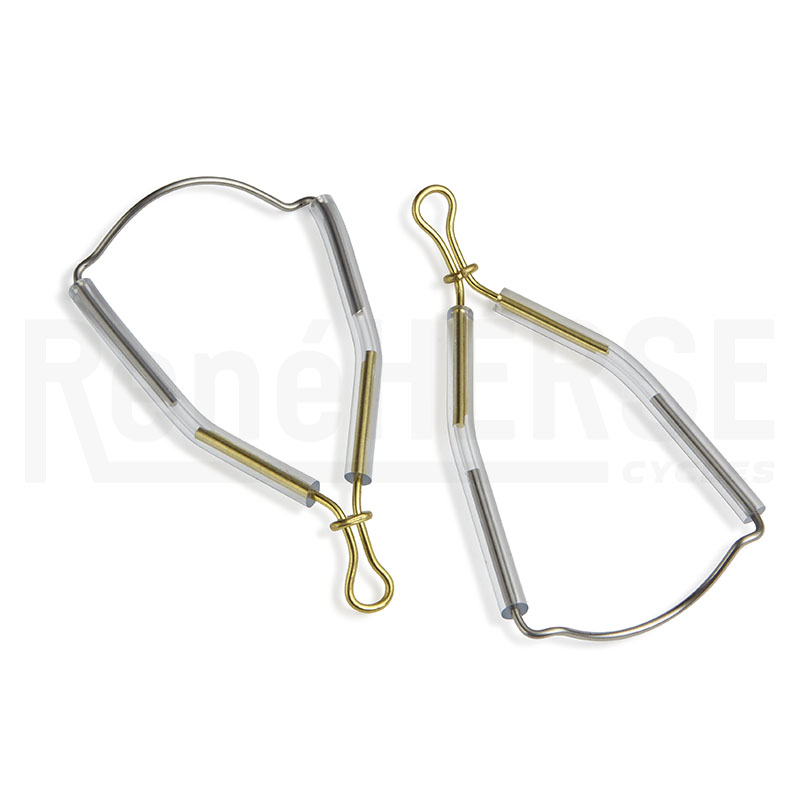

Many years ago when I was a student and rode a bike 8 miles to and fro... I was plagued with flats for awhile. One of the things I tried (successfully) was "Tire Wipers".
I put one of these on my front tire but can't really report anything conclusive other than my recent flat was on the back.... statistically irrelevant. Once I take off my rear tire to start my Tannus experiment (thanks again Chris for the shove), I intend to mount the rear tire wiper off of the inside of the rear fender. I'm not terribly optimistic about these because the fitment to my large 2.35 tires could be much better. Years ago, the tire wiper fit to my thinner road bike tires visually (and mechanically) looked much better.
