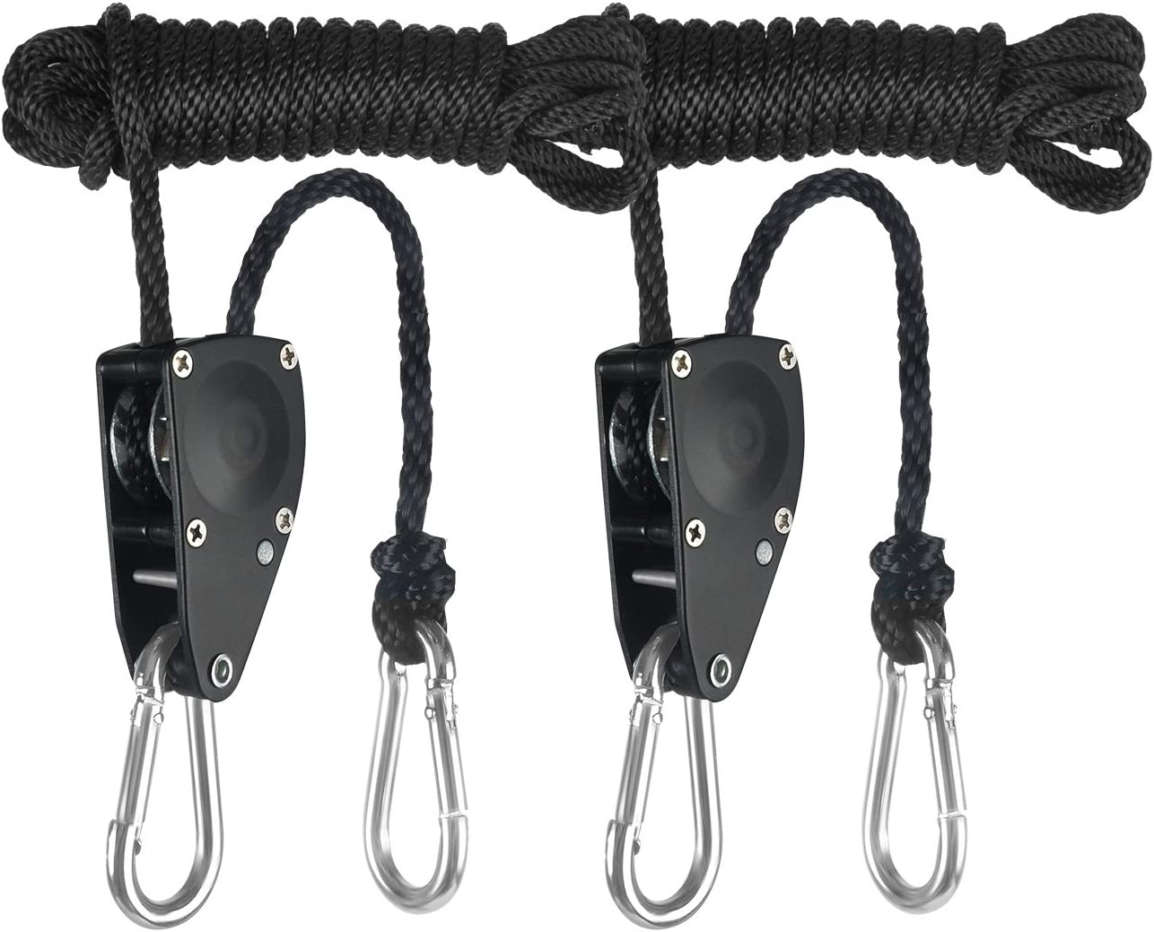

I bought and used the handlebar jacks and they work great. I admit it is not the best solution but miles from home it will get the job done.
They are very small, compact and lightweight. I have them in my bag at all times. Link is below.
